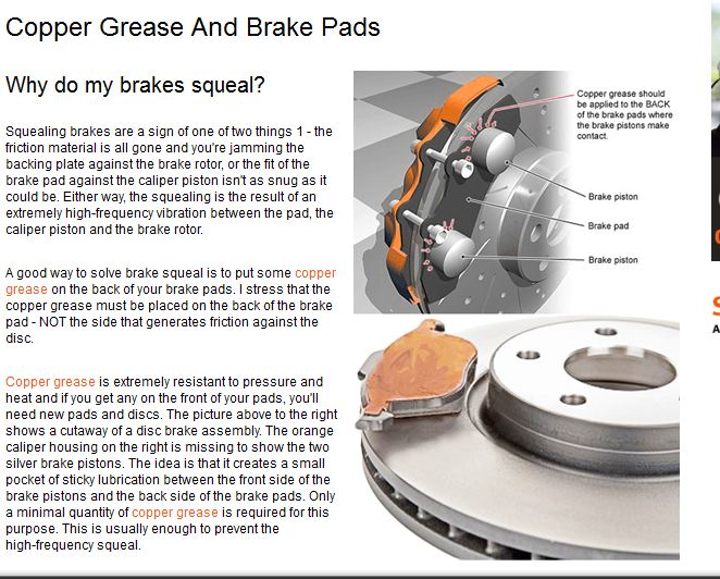

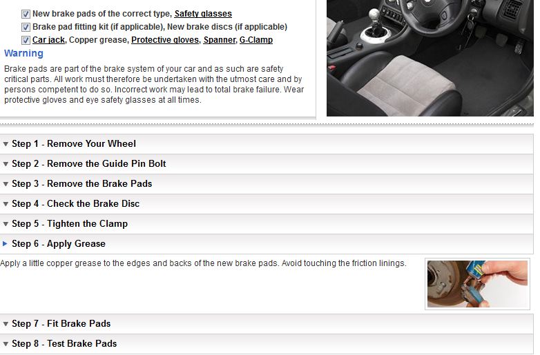

Sorry mate I can't agree with you, it has been and still is used in the trade for years, see below.
Pete.
