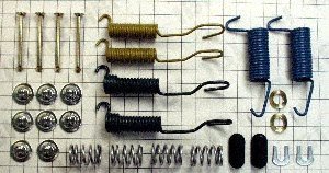

Had the same problem on my old Avensis, its the pins and spring clips that secure the shoes to the backplate that break.
There are Rear Drum Hardware Kits for around £10 the contain all you need, though you might have to shop around, cannot remember where I got mine, could have been Halfords but certainly a local motor shop / factor.
Expect Mr.T will do a simliar set or the individual parts.

Thanks for that, oldcodger. Probably should get one of those kits before I go any further. Been on a train and bus expedition to Euro Car Parts today to buy new pads and discs for all 4 wheels. I can confirm that they are VERY heavy, and that plastic bags with heavy items in them have a tendency to want to cut your fingers off!!
Hi,
Ah, I did look at ECP site and they do list a hardware kit, but no picture, so cannot be sure thats is the springs and clips kit without speaking to them.

Well it's all done .... almost. The other 3 axles were quite easy. Front ones are a dawdle. I had to use some degree of brute force to get the rear offside disc off, and in the process broke the brake shoe clips and clip retainers. Have managed to do a bodge with cable ties until I get replacement parts, but at least it is now driveable.
