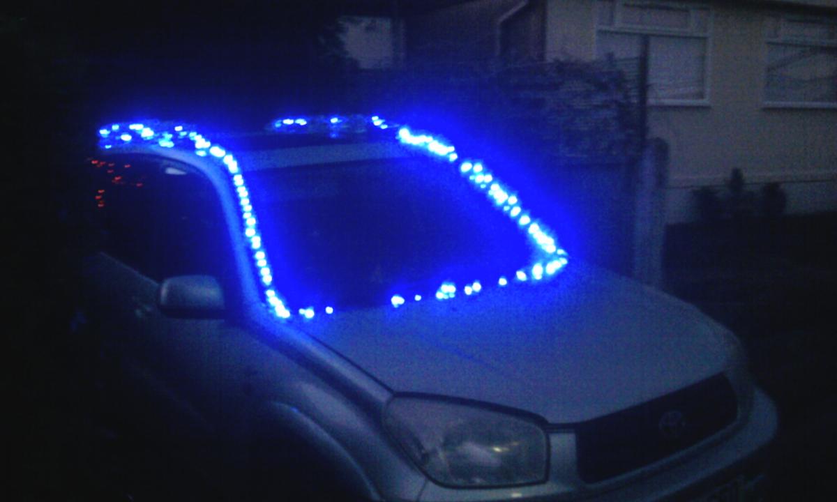

I class this as blue, decided to give my car some christmas treatment, a few lights and some tinsel because why not, its chritmas after all :)
post-108818-0-42101100-1355012775_thumb.
