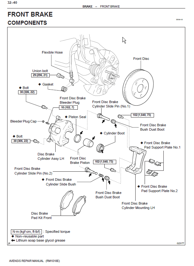

I don't know why, but when I was doing the brakes earlier on the car. I noticed that there was only one cap on the brake piston. Passenger side didn't have one, drivers did. It's confusing me, and I want to know if there should be one or there shouldn't be. Or if it's fine as it is.
If someone could let me know, please?
It's a 2007 Toyota Avensis D4D- T4 2.2 turbo diesel. (if you need the info)...
