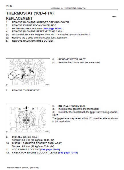

I would go for the new thermostat and have the rad checked aghain. Also refurbed rads are a lot cheaper than buying new.
Also what is your coolant like? red or brown? if its brown then get its checked out
It's quite an easy job really if you are good with tools, I have attached a diagram that tells you how to do it on your car.
Just click on the diagram to enlarge it.
