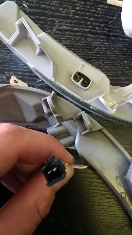

Hi Tarquin, had a crack on N/S indicator so bought a replacement on eBay although it seems to have a different plug to the original - is it best to solder them? - if so which are the  positive and negative wires of the pink and white?
Many thanks,
Josh
