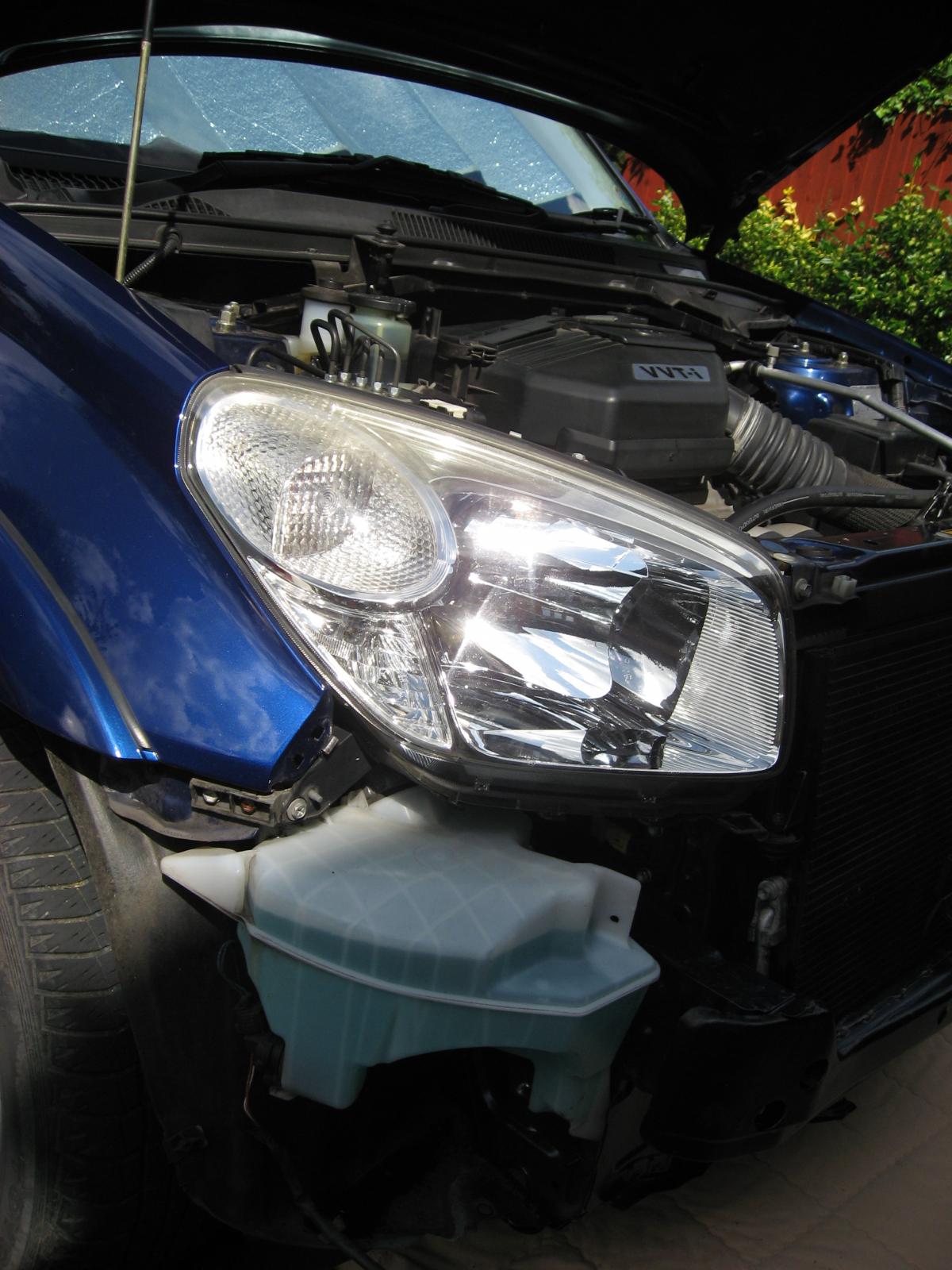

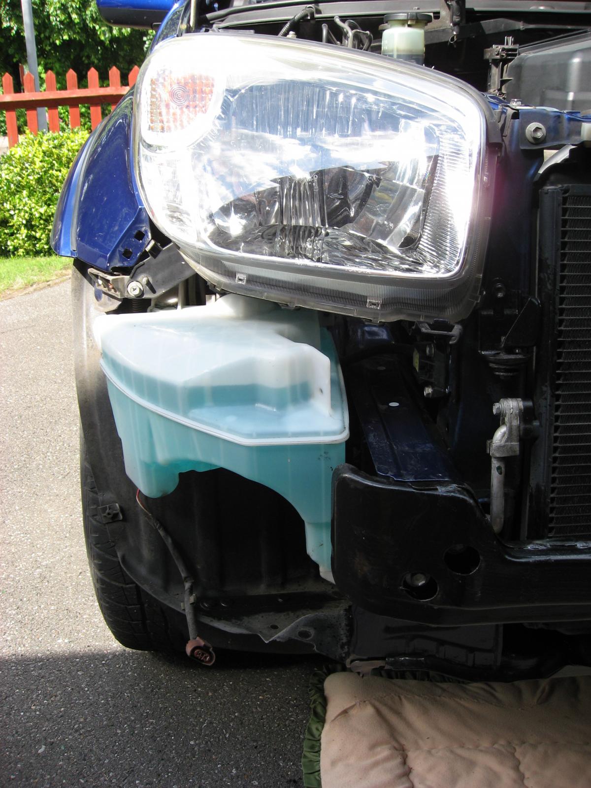

I am not sure if the pump is fully accessible from the engine bay without going outside and having a look . I cannot find any manual pages referring to its removal. If the pump looks impossible to access you will need to drop the bumper, there is a tech note at the top of the forum pinned detailing this. (real easy)
I have attached a couple of pictures I took the last time I dropped the bumper.
