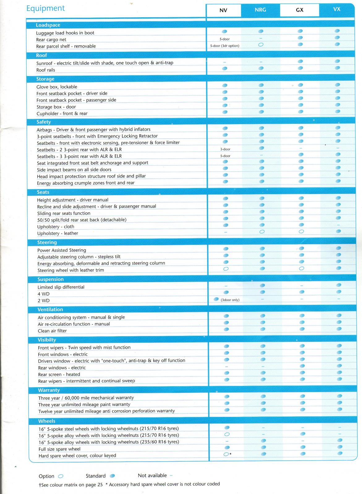

From my 2002 brochure (yes it is sad keeping it) lsd is only on NRG and VX models.

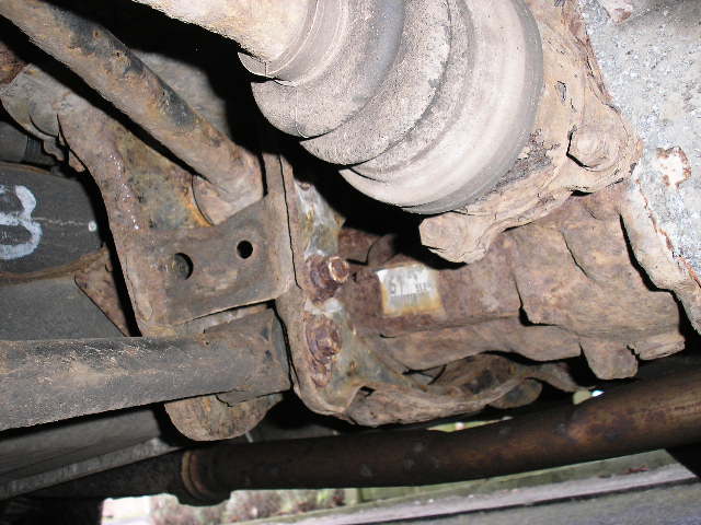

apart from what the brochure says how do you know it has a rear lsd. apparently its supposed to have a sticker on it so the mechanic puts the right Oil in it. is it possible for a photo of this.
thanks.
Stickers don't always fair well on a 10 year old rear axle Billy. Where have you seen two different spec's for Oil?

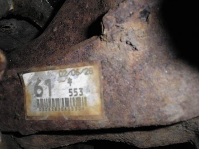

There is a sticker forward from the driveshaft on the nearside but it doesn't mention anything about Oil. Can't see another.

i was told by toyota that if its lsd it will have a sticker on the diff to tell the mechanic that it is lsd and only use lsd Oil. so i guess yours does not have lsd either. even if you think it does according to the brochure.
Perhaps you could ask Mr T where the sticker is exactly then and I'll have a look. In the meantime here are a couple of scans from the 2002 brochure that you think are wrong. I'm not sure if you have the original manual so there are 2 more scans that may interest you. I can't see anywhere that Mr T differentiates (pun intended) between rear diff Oil.
