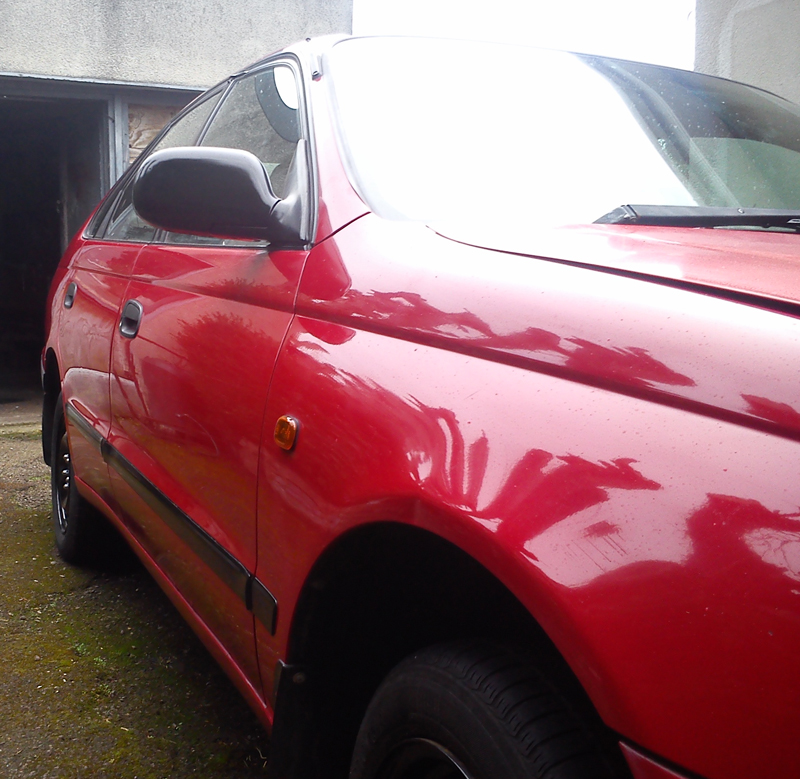

the brake line leak is in an awkward position for me to patch so will get it to the local mechanic to do that job - lately i have managed to paint the bonnet - it was my first time painting and i learned a lot - came out ok, certainly an improvement :-)

Wow, I love red Carinas.
any colour carina! ;-)

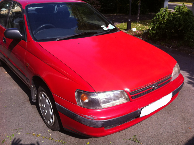

heres a sneak preview - i have it taxed and insured, waiting on a test date but once i get one i can drive it away - hope to get a good clean up done this weekend - bonnet will need a proper respray but i am not in a major hurry for that - going to do the bumpers while i am at it - scuffed at every corner.

wow,impressive.... love that colour too has a real. nice deep. shine :)
When I was working for a Ford dealers as. a valeter (oh sorry, they're called detailers nowadays lol) I always felt certain colour come up nicer than others and bright red the best of all..... it can be hard to look after n keep at it's best because like white and black any imperfections or dirt in general shows up like a sore thumb, there's nothing sadder than someone who's allowed their red to fade to salmon pink although it can be sorted, I spent days on a really faded pink 190E that had led a hard life as a taxi, was a slow week so they allowed me to spend a day or two on it to keep me quiet, well I managed to get it back to looking like your Carina. from a horrible bloomed. pink that was. so. flat. it. couldn't reflect a shadow under a spot light, the texture was almost. powdery like it been. painted a. pastel pink.from.B&Q......they were. gonna recycle it maybe getting £50 for it as it was worthless but ended up. putting on the forecourt for over £2000.
If look after this one in the way it seems that you are i bet you could pull up next. to someone at the petrol.station in a brand new car n yours will outshine their new car.
Funny enough dark green was another colour that responded very well to serious effort.... as long as it's not metallic paint. lol
