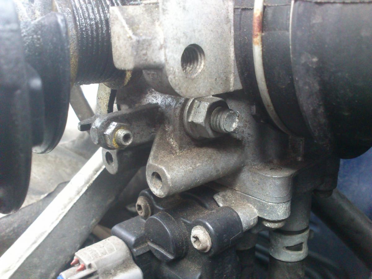

Also spotted that the owners of the car before me must have known my temp sensor was on it's way out because the throttle idle speed was altered to compensate for this problem. Simple adjustment of a tiny little piece just behind the throttle cable body and the revs are sitting back at 800/900 happily :)

hi,
You mentioned "Simple adjustment of a tiny little piece just behind the throttle cable body" I can see what you are referring to, can are you able to take picture pls?
Thanks.
EDIT: Are you referring to the nuts at the end of the throttle cable?
hi, You mentioned "Simple adjustment of a tiny little piece just behind the throttle cable body" I can see what you are referring to, can are you able to take picture pls? Thanks. EDIT: Are you referring to the nuts at the end of the throttle cable?
Attached picture, thats the bolt I mentioned, hard to get a good photo the hose from the air filter blocks the view a bit

the adjusted one is the one with yellowish grease around it, the smaller of the 2 :)
