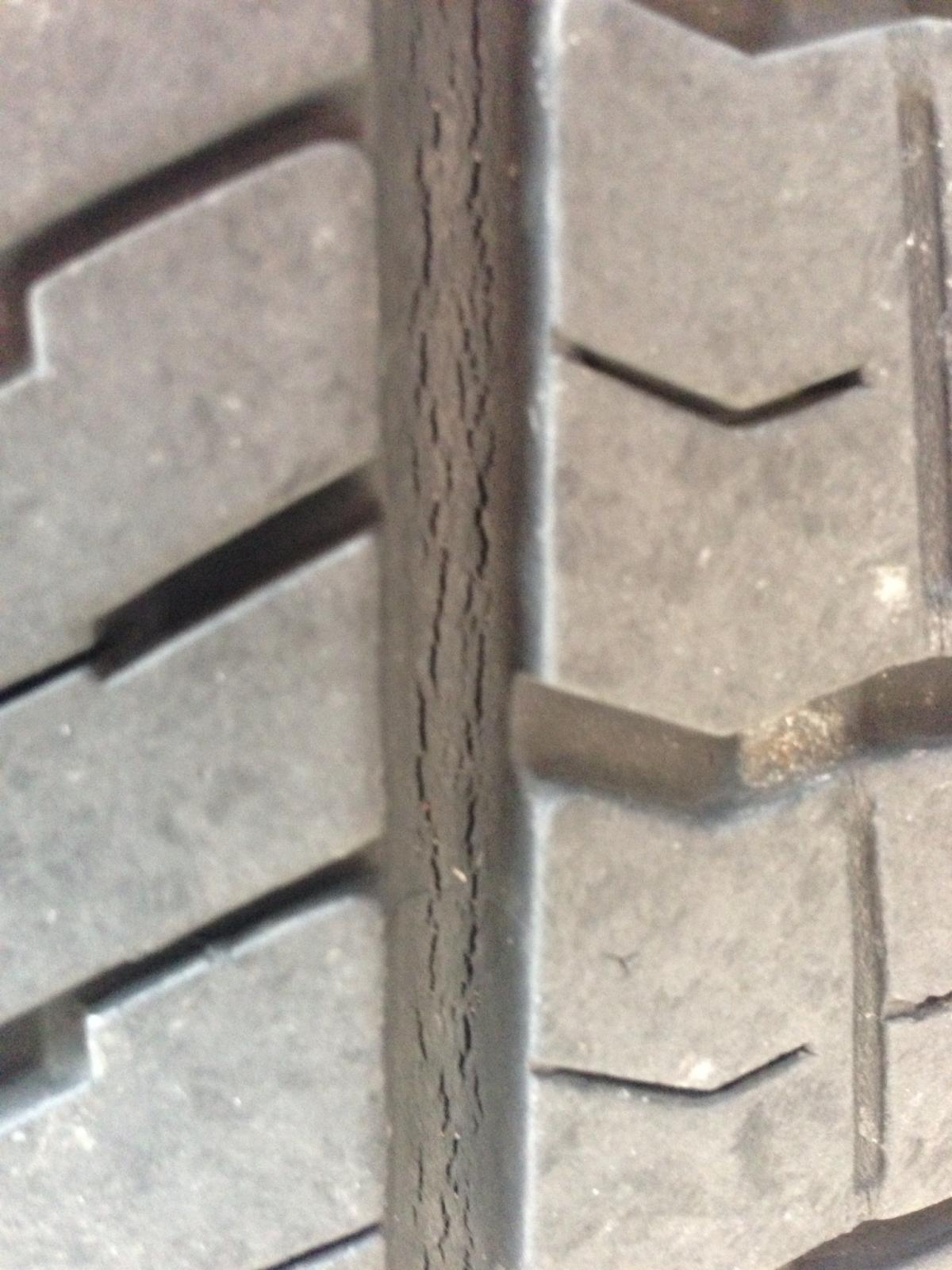

Any 1 got any Views on my rav 4 tyres 20000 miles 2 and half year old from new and thay have Perished ( date stamped 1410) about 4 to 5 mm left on them. !
Try a claim on the cars warranty ? IE Simply not fit for purpose ? How can a tyre of that age perish ?
I did try 2 add a picture !!
post-71710-0-55931800-1364841181_thumb.j
I was think the same ! All 4 tyres r the same ! Yokohamas which r not a cheap tyre ! " is any thing made 2 lasts any more lol"
Definitely make a claim. You have nothing to lose.
Yea think I will contact Toyota and yoko ! May be more than just Perishing as the rest of the tyres r fine its just between the treds It does not give me much fath in them at 70 mph !!! Any 1 got 3 year old Yokohamas on there rav ? ( other than the cracks mind thay seam a very good tyres )

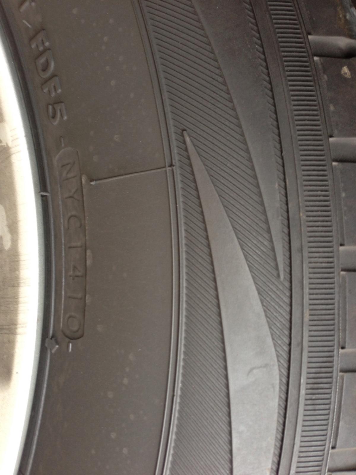

Where are you folks finding the date stamp on the tyre?
I've got two sets of G91As and no sign of cracking. They are between three and five years old..................
Date stamp !
post-71710-0-92190800-1364846288_thumb.j
Date stamp !

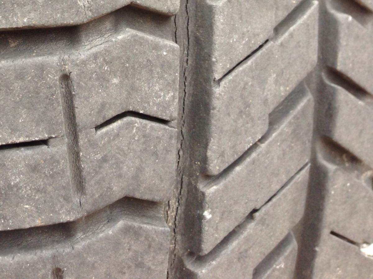

Yea ! It look like the tyre is splitting around the treds more than perishing !
Tyre split !
post-71710-0-20934800-1364848672_thumb.j
Not having much luck off Toyota ! Tyres not covered , tyres do Perish , r your Pressure right , you nead new tyres lol ! Going 2 try Yokohama 2 Moro
As in my earlier post, the tyre warranty will be supplied by the tyre manufacturer (in this case Yokohama) rather than Toyota.

spoke 2 yoko 2 day heres the reply
i have shown pictures to warraty tec and he has drawn attention to the abraded wear on ourter edge of tyre which suggests the tyre has been run under inflated !
he has requested that we have the tyres back 4 inspection to yoko ! thay have never hered of this before ?
looks like i nead 2 spend £500 on a new set 2 find out about mine ! not happy just checked again 5mm left on tyres !

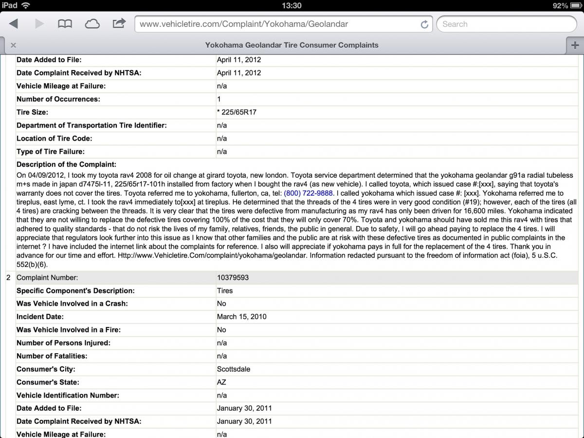

Interesting!
