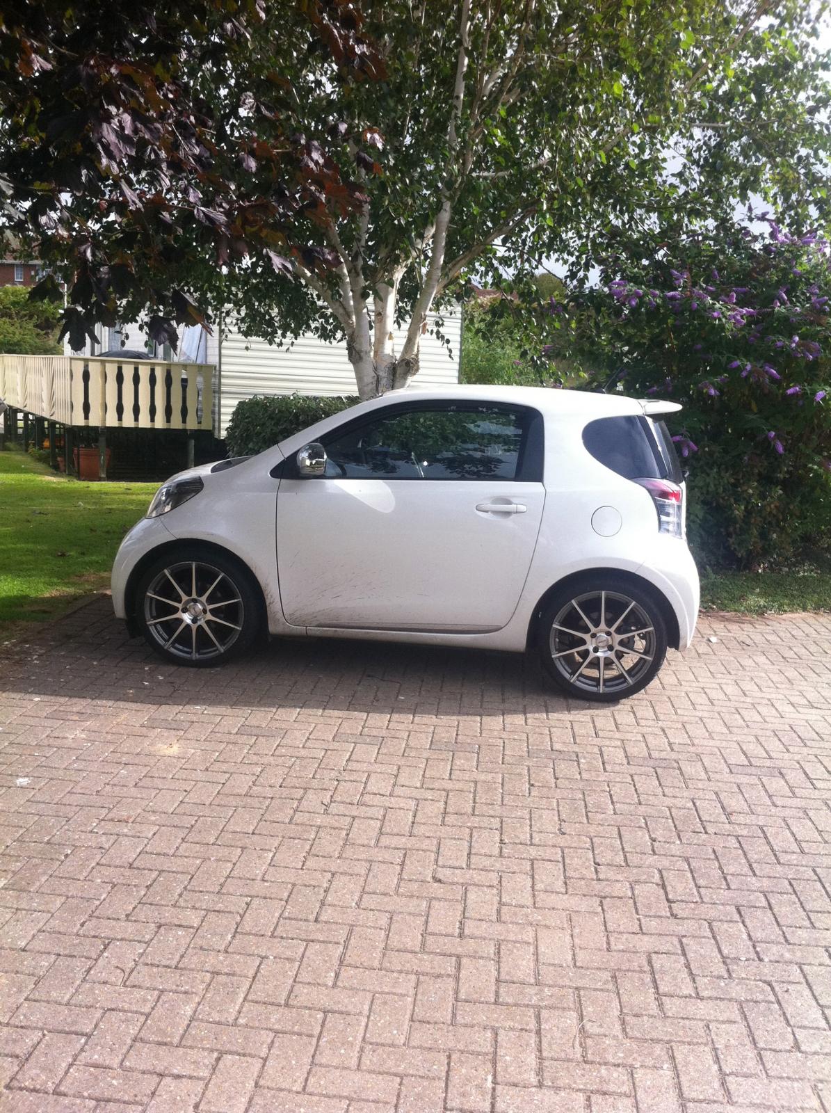

Hi
This is mine with 18 x 215 x 35 Lowered by Toyota 25 and rear 30
As has been said Bumpy ride but sticks to the road like glue Superb Cornering
David
