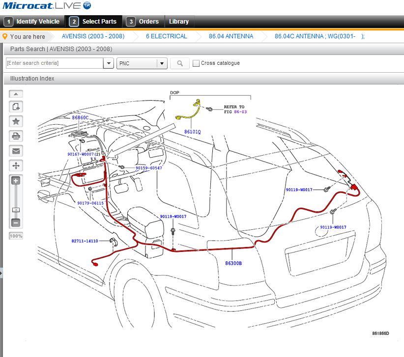

The T4 will have a gps antenna mounted high up under the the upper dash panel this will have to be found and swapped over to the T2. On the picture attached 86860c is the gps antenna
post-45863-0-58376900-1370979514_thumb.p
Thank you Devon Aygo
It was a well hidden piece of kit, but I managed to extricate it from under the dash and fit it successfully in the T2, all working correctly; so thanks once again I would have never of found it without the diagram :)
