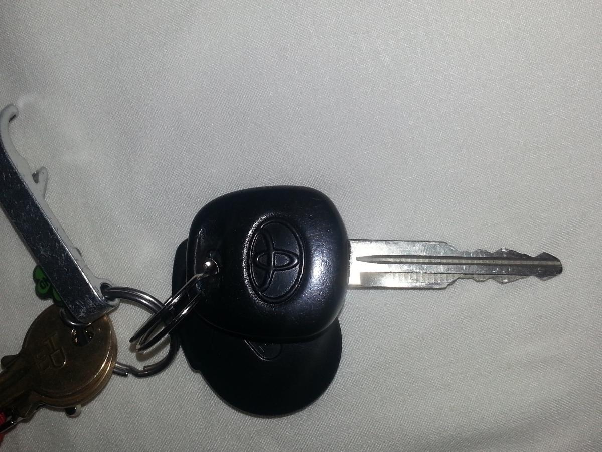

The key is completely different. Its black with 2 toyota logos on either side and just the key (I have two of these)
In regards to all this do you know WHY it would make the hazards come on for the short period of time it does?
The security light is part of the immobilizer system, all Yarisusses have that so that's okay; It was the 10p-sized thing to the right of the wheel that you talked about that I was wondering about.
Not all of these cars come with remote keys but I've not seen one so I don't know what the non-remote key looks! :lol: It may just be yours has the original keys and just doesn't have remote central locking! If the Toyota logos are stuck on then that's a dead giveaway they aren't original as all Toyota keys have the logo embossed into the plastic.

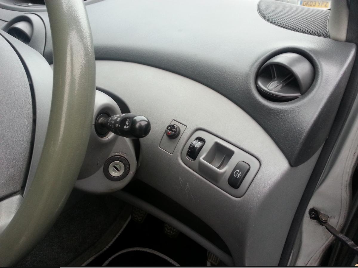

Hey Cyker,
Please see attached the photo of both the key and also the 10p sized thing in the car.
The process in which the Hazards work are this:
Unlock the door by the key --> As soon as I open the door the hazards start flashing for around 15 - 20 seconds --> open a new door as another is shut and same thing again.
I believe as the 10p thing looks built in it is part of the car's alarm or central locking? Like i said im new to this and I am no mechanic either so it would be nice if someone could shed some light on what I need and not have to goto Toyota and pay through the nose!

The key looks alright but the alarm looks out of place; I might be wrong but I'm sure that rectangle is where the traction control switch goes if the car has the traction control option (I've yet to see a Yaris IRL with that option tho'! :lol:).
I've never seen an alarm indicator, certainly not a round one, in that position!
I reckon they've just mounted the alarm indicator there as it's quite convenient, but I could be wrong - Any of you other Yarisen seen such a thing??
I wonder how it's being armed/disarmed...

Might be worth poking around to see if there are any weird-looking boxes; If you can find a part/model number to go on it'd make thing easier!

As Cyker has suggested, I'm pretty sure it's an aftermarket alarm. Don't recall my old T-sport having an alarm, just an immobilizer, and definitely not something that looked as out of place as that.
The key looks similar to the Toyota keys I had with my 1996 Corolla - that came with two black keys and one grey key (none of which had any buttons). The alarm is definitely not Toyota.

Thanks for all the replies. I know my dad is a mechanic and said there is something unplugged that runs to it, he believed that someone previous has routed the new alarm to the hazards.
It was a 2 owner car and the owner I got it from said it had been there from when she brought it.
I am beginning to think what I may do is just cut it out and remove it all together, hopefully that will stop the hazards problem.

Just note that you need to find the security module and disconnect it, not just cut the wires to the little light :lol:
Normally these after-market alarms are connected directly to the Battery, and also to the horn and hazard lights so when you start the car, if you don't have the disarming thing (Often a fob of some sort) it does the honk honk flash flash dance. Disconnecting it from the Battery will usually disable it. (Partly why cheap aftermarket alarms are pretty useless except against the most useless of car thieves!).
If it isn't connected to the Battery, that's a lot trickier and you're sliding into specialist territory! (Plus I'd be a bit wary of posting even if I did know how to disable a complex system, this ToC, not the car thievery school! :lol:)
Sometimes there is a manual switch enable/disable the system completely but smeg only knows where it might be hidden if there is!

It's a bit weird that it doesn't honk but only flashes for 10 seconds and then stops tho'.
