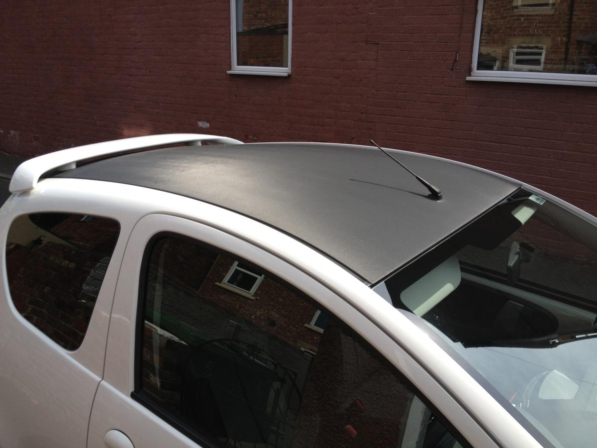

I've had the roof wrapped in 3M carbon fibre effect vinyl as well as the rear bumper above the exhaust.

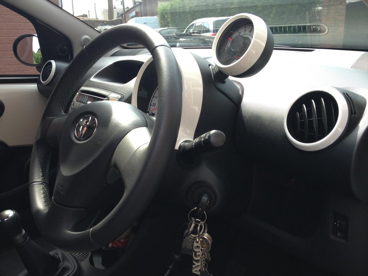

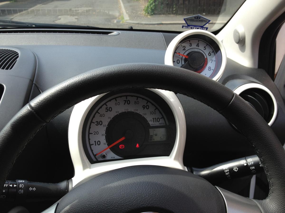

I also painted the dash vents, rev counter and speedo surround to match the body colour (not an option for the white Aygo's.

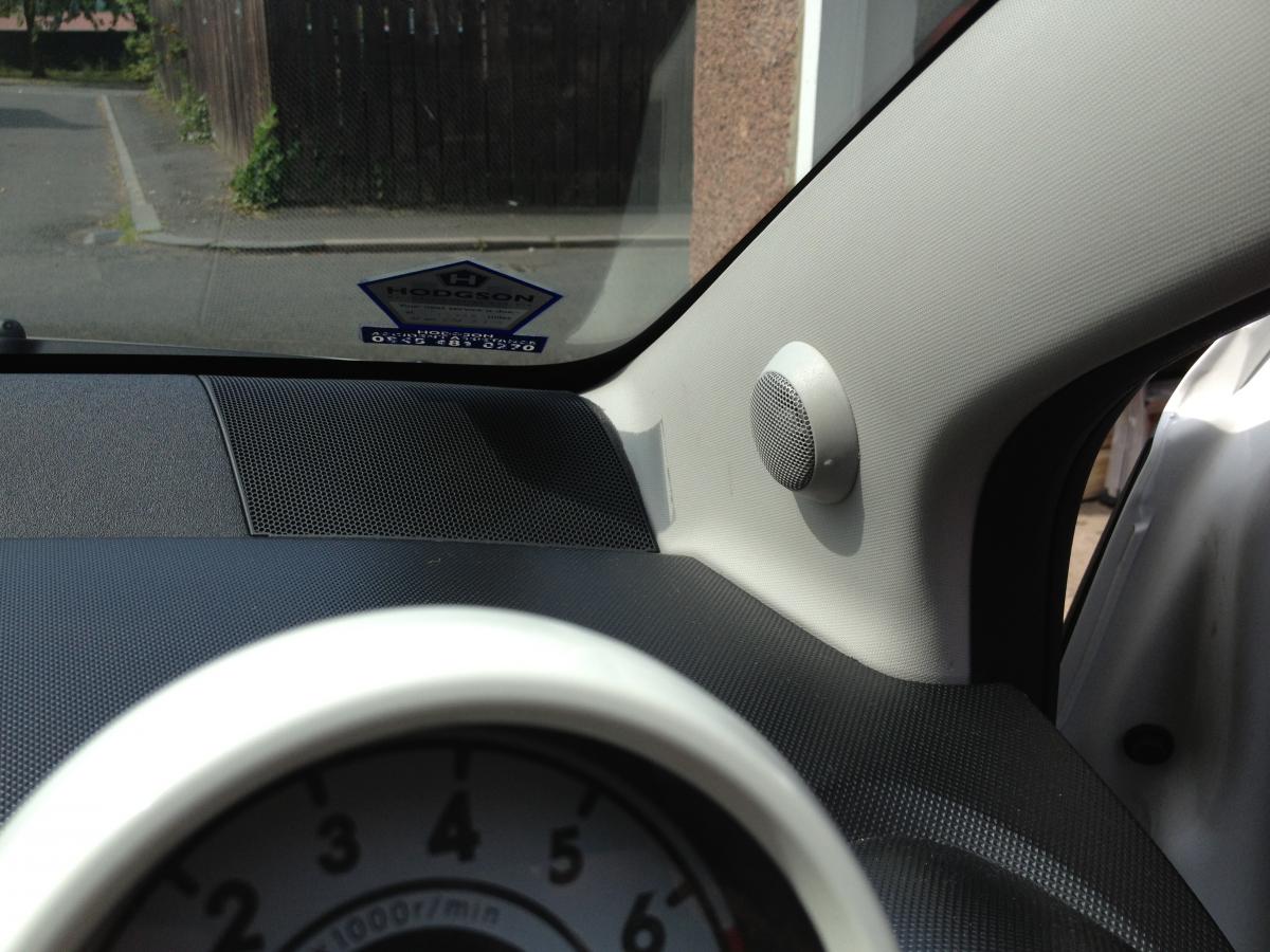

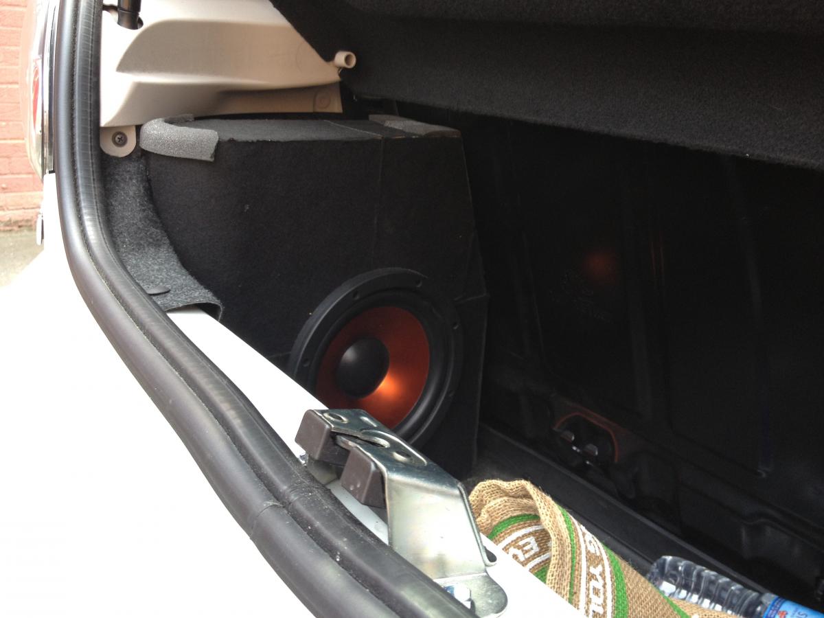

I fitted tweeters from the previous model Aygo and then upgraded all the Speakers to Alpine units along with a Sub Woofer in the boot.

I then had an aftermarket roof spoiler painted and fitted which looks pretty good.

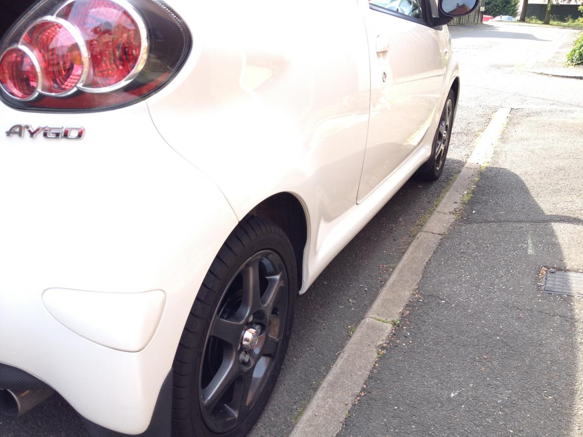

The wheels are Yaris T Sport ones that I machined the bolt holes out to 20mm to allow Aygo wheel bolts to correctly then had them professionally refurbished in anthracite. The centre caps are from a Celica.

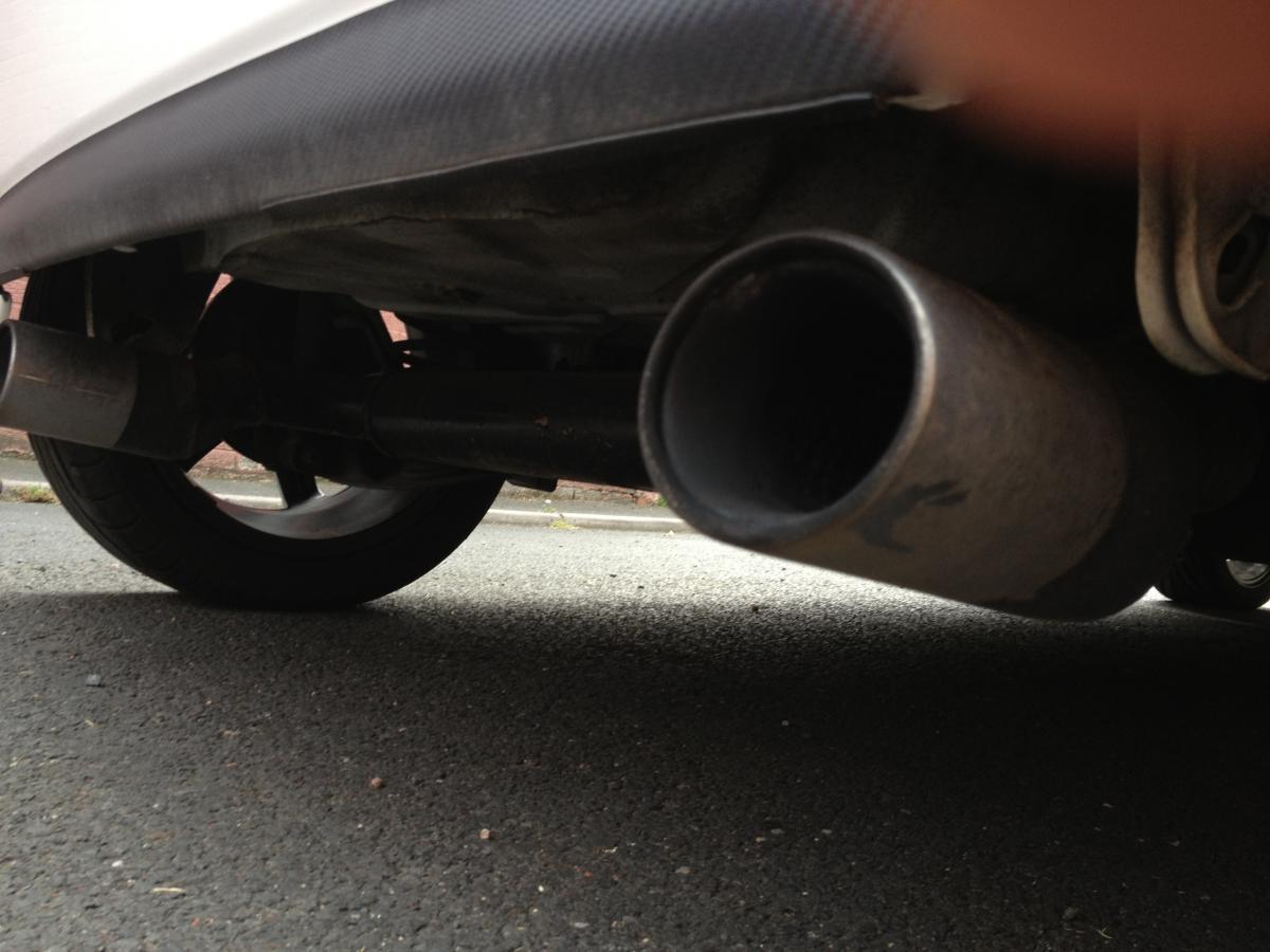

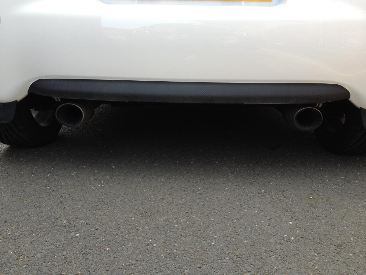

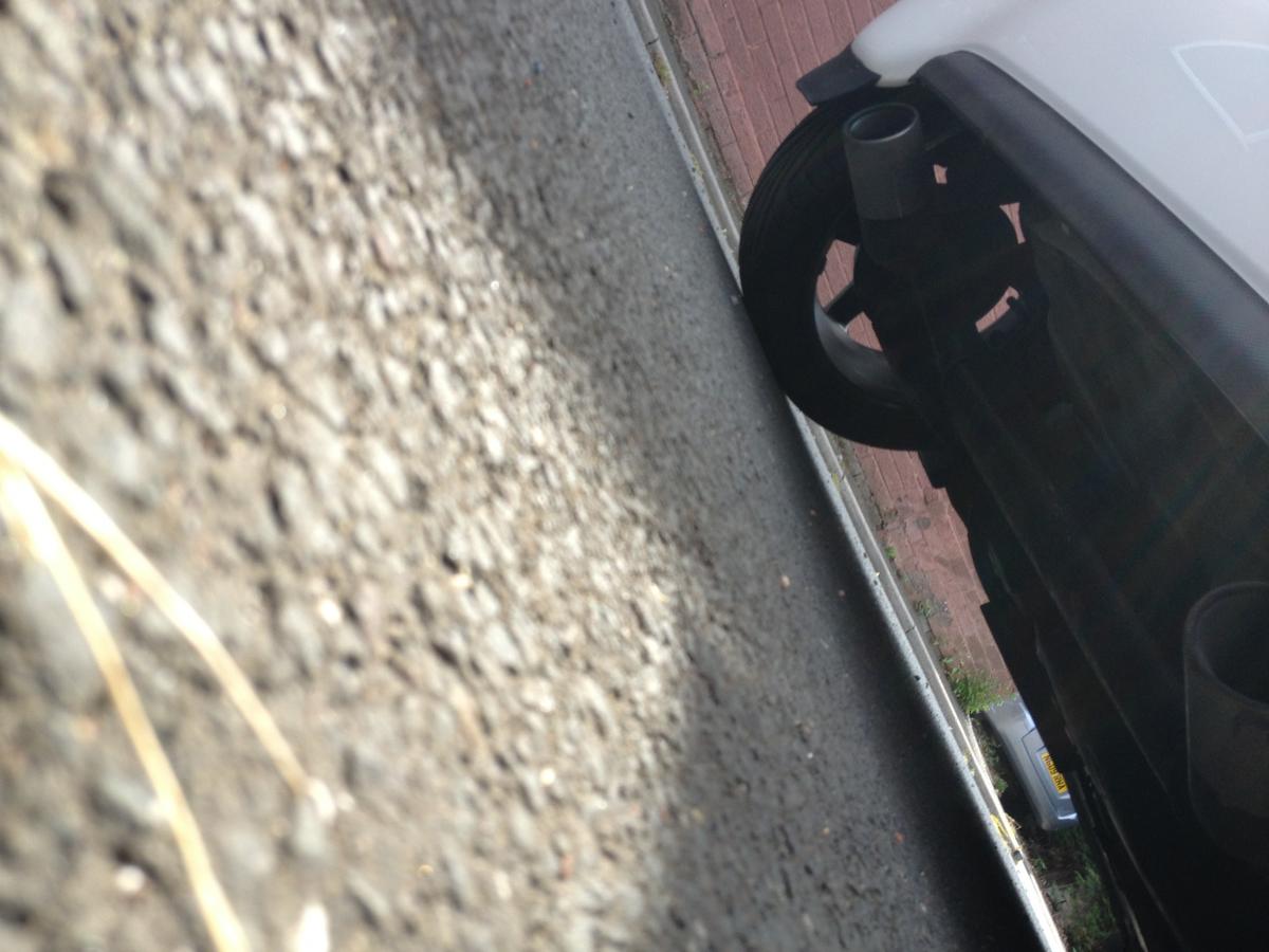

The exhaust is a standard Aygo part with a twist. I drilled out the nearside of the silencer to create a twin exit exhaust and the Mig Welded the tail pipes from a MR2 Roadster TTE system onto each side. the result looks and thanks to the tailpipes having built in silencers sounds awesome.
