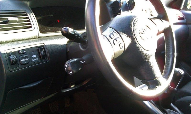

I have a original Toyota cruisecontrol fitted as I bought the iQ
It sits rather onconventional left of the steering wheel en rather way down.
It has 3 little buttons you can program for a fixed speed. Also you can set the speed by turning in counterclockwise....
During a CC you can axcelerate by turnig anticlockwise ... or lower the speed by turnig the handle clockwise...
On the down part is the on/off button and on the top is the cancel of the CC button.
It works fine... only to reach for it is rather annoying...
And it must be said that I have a CVT car.... so above 40 km/hr it can be fixed the speed...
