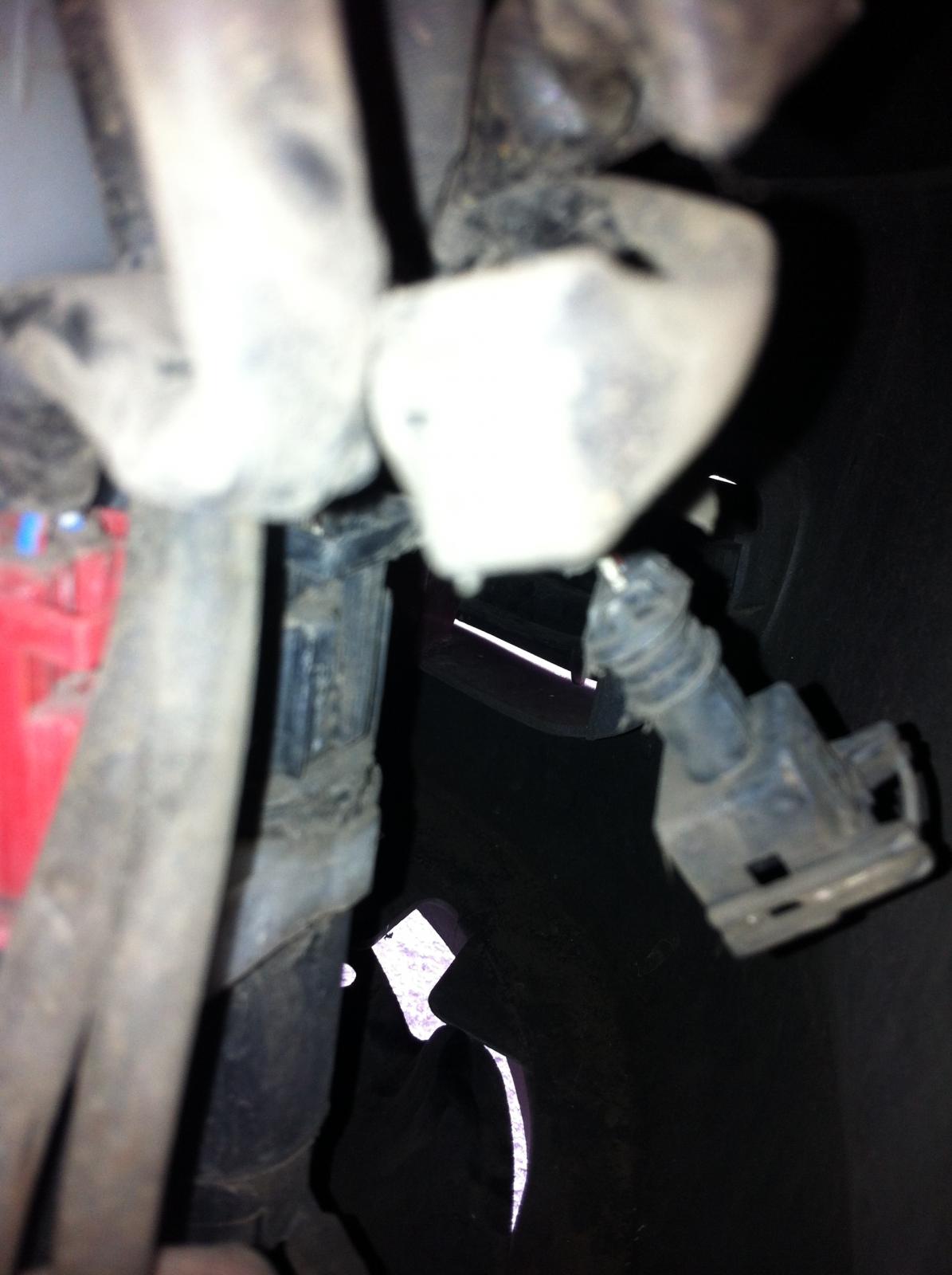

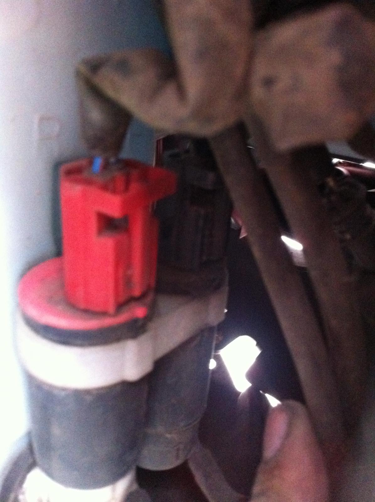

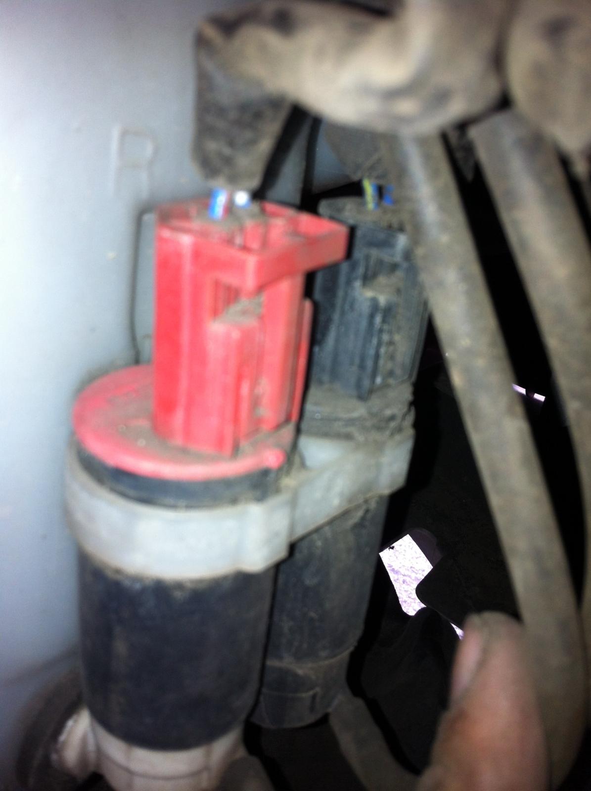

3. Once off, You will see the filler bottle for the washer liquid. It has two pumps attached to it. These are also dirt cheap with a used one from local scrap yard costing £5. I found that out of the two, one to the left was the rear one and right one was the front one. I tested it by disconnecting and got my brother to run the washers. You can wiggle the pump out BUT remember to be gentle and not break the seal where the pump sits. I have a picture or two and i wonder if i can attach them. anyways good luck. Oh and managed to attach images. Image 1163 is of a connecter for front fog lights i think, if you have them it wont be dangling and if you dont, this is what you are looking at.

Thanks for that Waqar, appreciate it. I have a red plug dangling ie not plugged in, I have front fogs but they're working. I can't find a "socket" to plug the red cable in. I recently had my front shocks done I'm thinking the guy who did those unplugged the washer for some reason. He's away on holiday so can't contact him.
Was it working before?
Also, i dont know why you have nothing to put the red plug in. That is very odd. I know off cars (Toyota Glanza Namely) that have a Y junction pump. So thats like one pump for front and back. Oh that begs the question do you have a rear wiper. If you dont, that explains that red plug dangling as its there as standard wiring and you can leave it there. Its the one next to it that is your front one and thats the one that is not working. get somebody to try the wipers on when you are down there and if no noise wiggle the plug (black one) if still nothing you have a faulty pump. I personally wouldnt spend money on a new one as these things rarely go wrong and can be found very cheap at local breakers.

When mine went wrong, I tested the motors by reversing the connections to find the fault. This only works with the hatchback/estate, not the saloon with only one pump. I got a pair motors from the breakers. Good photos from Waqar. A simple tester used on the terminals of the pump plug will confirm there is power.
To remove the pump use a flathead screwdriver or similar to release retaining catch between pump and the reservoir, lift the white collar clip off the pump/s.
You may need a bucket if the reservoir is full to catch the washer fluid when you pull the pump away. (you probably knew this already).
Refit is reverse.

Swapped it for a £10 pump off ebay and it works a treat. I removed wheel lining and undid a couple of screws on the bumper to prize the bumper (essential) away from the washer bottle.
Not sure whether full or even partial removal of the wheel arch liner was strictly neccesary, and don't think complete removal of the bumper is essential.
The pump needed a firm prizing with use of a screw driver to pop out of its groove.
Much better than £160 odd at the dealers.
