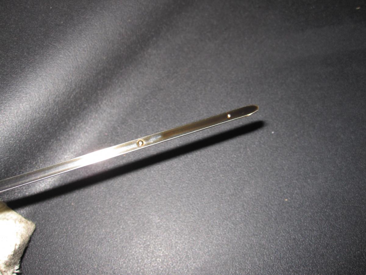

Separate question for you learned fellows :) just been doing my weekly checks, late this week due to being out and about on the bike last weekend, but I have a question do any of you get a reliable consistent reading when checking you Oil, it doesn't matter how many times I wipe and recheck it seems to be all over the dipstick, the car is on a level flat surface and the engine hasn't been started since Sunday so at least 3 days for it to settle.
Cheers
Gus
When I check mine it's up and down like a tarts knickers Gus.
Also inconsistent from one side of the stick to the other.
Anchs suggested rubbing the dipstick with an abrasive to give it a bit of a 'key' but I haven't tried that yet.
AIR CON..Having to pay £1 on one of those garage forecourt machines to check your tyres pressures.
Yeah, fine emery or wire wool. It tends to bubble on the shiny surface. This is mine after an overnight stand (3600 miles).
post-30983-0-67256600-1377211267_thumb.j
This is fully synthetic low ash factory fill Oil. It has gone much darker than the previous 150 engined RAVs I've had. You can also see it has gone down from the top mark both of which I expect with this type of Oil.
Was washing the Rav today and remembered to rub down the dipstick with some emery cloth, wire wool seems to have gone walkies, which reminds me almost time to sort out the garage :) but result on being able to read the dipstick, thanks David and Don :)
Gus
Me also too forbye.....oil noo sticks to stipdick.
