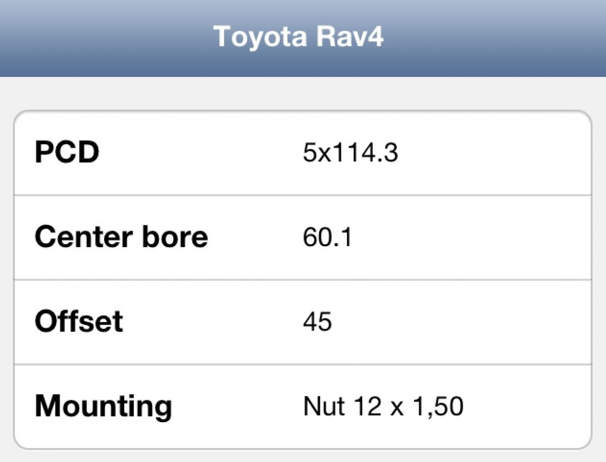

Attached is the key spec for FITMENT to your car. There are various (but not all) other Toyota and Lexus models that use identical fitting parameters (offset usually varies between models), but ensure that the loading capability on the new wheels match or exceed the original (And most aftermarket wheels are pretty rubbish and tend to buckle/crack much more easily then OEM ones).
Other non-Toyota OEM wheels that have the same main fittings (studs, PCD and CB) are the current Suzuki GV,Suzuki Swift Sport and the Suzuki SX4/Fiat Sedici

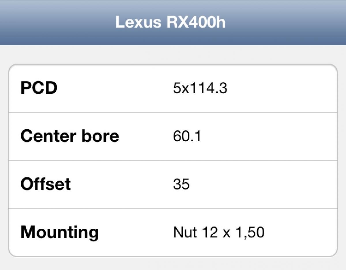

Does anyone know if the 18" alloy's from a lexus RX400 be able to fit on a RAV ? :unsure:

Offset is different by 10, so the wheel centre *could* be inboard a little (depends on style of wheel if it will 'appear' in further or not), and often a wheel will have a different offset to compensate for the wheel width (so the ones quoted in the screen shot info may not be applicable anyway, just like when you look for tyres onlinw and put in your car reg, it sometimes comes back with the wrong wheel size!)
Apart from that, other parameters are the same so should be a straight swap.
In terms of Ride, typically, the bigger the wheel, the slimmer the tyre and worse the ride. Don the anchorman would be a good person to ask as he will have had RAVs with both 17" and 18" wheels.
