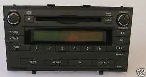

I have a 2009 Avensis with the Panasonic Radio (No sat nav). I recently got a new phone, Sony Xperia Z. My problem is sometimes when I recieve or make a call it mutes the radio but does not transfer the other persons voice out through the Speakers of the car (i.e. I have to hold the phone up to my ear even though its connected to the radio). I have tried unpairing the phone off the radio and repairing it again to no avail.

I have tried everything you said (i.e. completely shutting down my phone several times, unpairing and repairing my phone etc.). I had already gone on to the link you gave me to see if my phone is compatable and it appears it is, however the facts are different. I think what I will have to do is try and get a second hand Toyota radio, the type with the large screen, like the one in the attached photo. It belongs to a friend of mine and he has the exact same phone and it works fine. I have already phoned most of the car dismantlers in Ireland but no luck so far. Thanks again for all your help.
