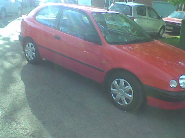

its a S plate 3dr Hatch, 4E-FE motor,

PS,sorry the pic is cropped
