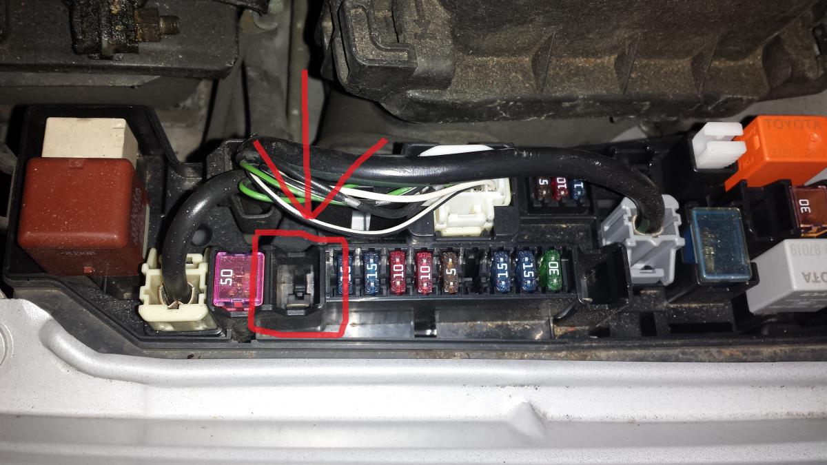

Hi problem on my 2003 1.6 auto Corolla

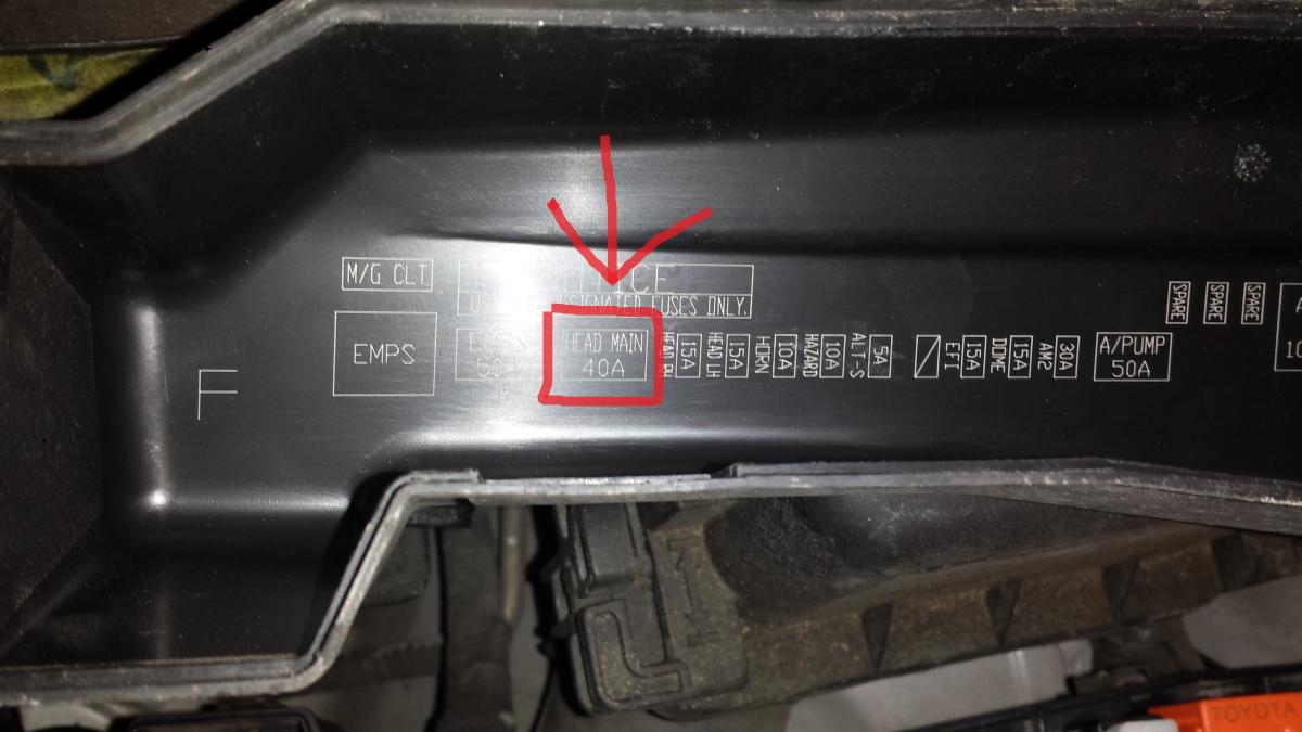

the side lights work and full beam too....but the main lights don't ....on both sides .....got me thinking it might be the fuse.
So looked in the fuse box ....see attached and the 'Head main' 40amp is missing ....seems a bit odd.
Is it worth me buying on and putting it in to see if that is the issue?
thanks in advance any responses.
I bet both dipped bulbs have blown, try a new bulb first before worrying about fuses, ive seen it happen plenty of times before, check the obvious first
Kingo :thumbsup:
Parts King! ....yep you were right - replaced the bulbs and all now works fine .....Garage had real job changing the passenger side bulb!!! total pain to do that side.
