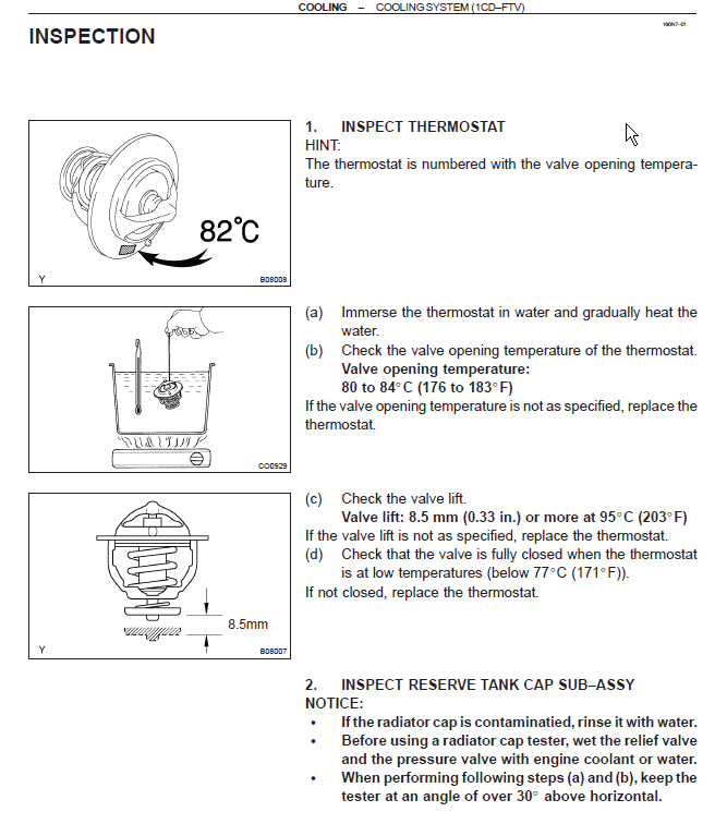

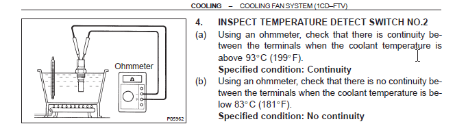

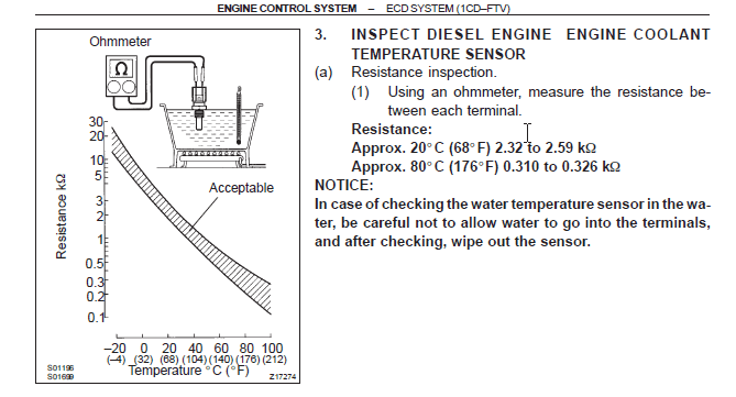

Hello Marko
From my experience of these cars only have an engine temp sensor as such even though it has many others, have you a problem with the engine overheating or running too cold?
Here is some help for the cooling system providing the radiator is not blocked or water pump failing etc, if it's not what you are looking for then no problem the info should be helpful to others.
Click on the pictures to enlarge them :-))
Regards Pete.
