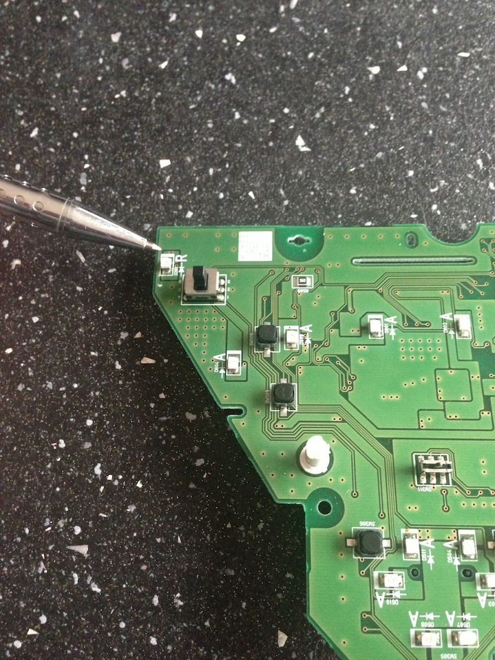

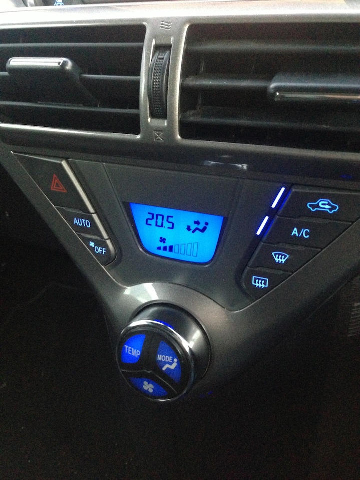

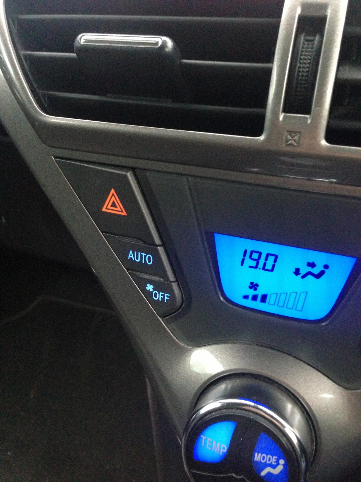

seems I replaced all the LED's in the A/C display with Blue ones and forgot the poor old Hazard one was meant to stay white!!! Before and after pics and a pic showing the offending LED with my pen pointing at it,, No not my new GT86 Pen before anyone asks,,
David

Well and truly slapped now David? lol
Now I remember how good the interior lights in your car look, very 'cool blue.' As for the hazard warning light lighting up, I couldn't remember if it did or not. Last night I was out in the car and noticed it does, but you already know that now.
