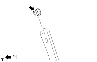

I have Avensis d4d 2005 hatchback model. 6 months ago I have found some broken brushes on the mat, which was drop from clutch pedal, the bushes are known to be turnover bush (see picture) and slowly after that the clutch started to get harder and harder and from last month the clutch sometime stays half pressed when put on the gear then I have to pull by my foot.

what is the mileage on car?
where the bushes that fell or broke replaced?
was the master cylinder a new part or used part?
There is a bush on the push rod clevis, was this changed when master cylinder was?
your best of disconnecting the master cylinder from the pedal, then see if its still stiff, if it is then its most likely to be something on clutch pedal.

I was told a guy in toyota, change cheapest first in order.
pin and bush on master cylinder
then master clylinder
then clutch kit ( could be the pressure plate) one technician said a sign of a clutch going is a heavy clutch

Car Mileage is about110k and the bush was not replaced as the mechanic said its not that bush, which makes clutch harder and the replaced master cylinder (MC) is brand new from toyota dealer.
The clutch seems very hard and as I said that mc doesn't no difference. Now my mechanic is suggestion to change the clutch pedal !! i laughed first and then I am like is that the only option so I am kind of confused and don't have a clue.
