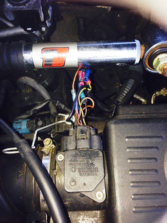

On the air filter there is a set of wires that go into the filter, it looks as though at some point the stock filter was removed and something else (K&N maybe) was fitted in it's place, it looks like when the stock filter has been put back on the wires have been connected up again, all be it very shoddily !
I've only had the car three months and all this was done before I brought it.
My question is, is it possible that the shoddy wiring back into the air filter is causing this error and if so can anyone tell me the name of the part I need to replace it as im pretty sure with some instruction I could sort this myself.

Yes I think it is that !
I will try and get a photo later, when im not going to get blown of my feet :)
Could it be that causing the error if the wiring is a bot ropey ?
That is the MAF sensor, if your not sure about wiring then get an auto electrician to have a look for you :thumbsup:
Get to a scrappie and see could you chop that part of the loom, then solder and heatshrink the cables together.
That looks like a pure chancer job there!
