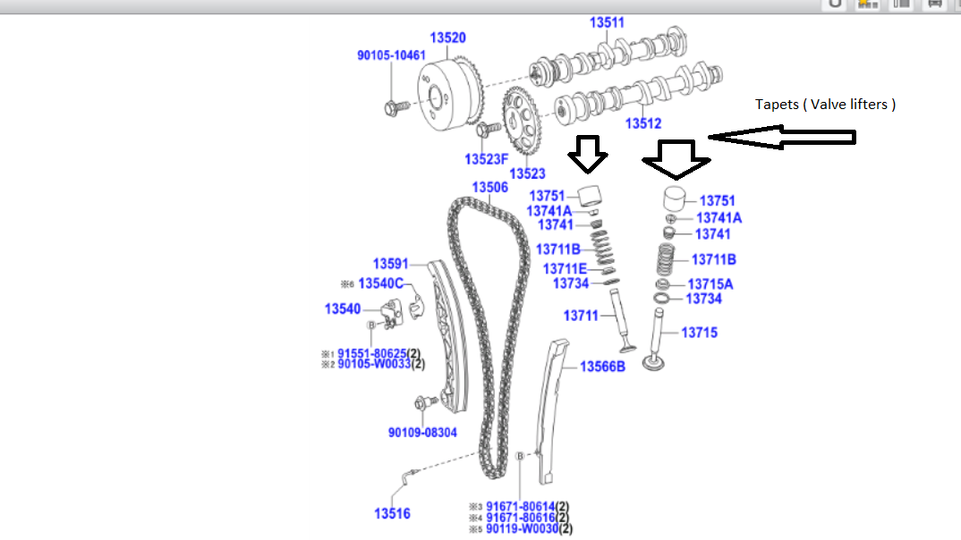

Toyota say the tappets should be audibly inspected every 40,000 miles using a stethoscope, if the tappets sound noisy the valve clearances should be measured for correctness, if there is an issue with clearance then the camshafts have to come off and the tappet for the valve at issue measured and then replaced with a new tappet with a larger/smaller measurement.
The best trick is to measure all the clearances and then it is often possible to swap tappets from one valve to another reusing some of them and only replacing the tappet left over with new ones of the correct thickness.
I have worked for Toyota for 15 years now and have never seen an Aygo needing tappet replacement.

There is nothing to actually "fail"
As the camshaft rotates, it pushes down on the top of a valve to open it.
There has to be a tiny gap so that the valve can completely close.
Because if the valve doesn't seat properly, combustion gasses at very high pressures can be forced past.
Rather than have some kind of adjuster between the moving parts as in days of old,
The engine is assembled, clearances checked then an appropriate sized bucket / shim
or both are fitted to give the perfect, tiny gap.
The gap NORMALLY becomes slightly wider over time (therefore, noisier) just down to wear.
Modern oils and materials mean you should get hundreds of thousands of miles with negligible wear.
If they become noisy, measurements are taken, the engine is dismantled and thicker parts fitted.
Main cost is time.
ie......Take off air filter, coils, covers, bits & bobs.
Measure some gaps. Turn engine a bit, measure some more gaps................Write down 12 gaps.
Remove camshafts ......Time......more of it.
Lift out all 12 buckets / shims......Write down the 12 sizes.
Look in the big book of words. Find out what the gap IS what the gap SHOULD be.
Work out the size of the shim needed (X 12) Have you any already in that size?
Substitute some that fit for those that don't. Order the ones you need.
Forget what went where. Parts arrive. Assemble in clinically clean conditions.
Final last measure to check......Oh dear, one is just out of spec......Do it all again.
Or simply swap in a young engine......just nuts & bolts.
IF......the tolerances become too tight and the valve doesn't shut completely, the burning gasses
will eventually wear away the valve seats. At this stage repair is uneconomic. Just swap engines.
Tight tolerances should not occur in the Aygo engine as there is no adjustment for people to mess
with and get too tight.
Regular oil changes with top quality oils and......completely forget about them.
