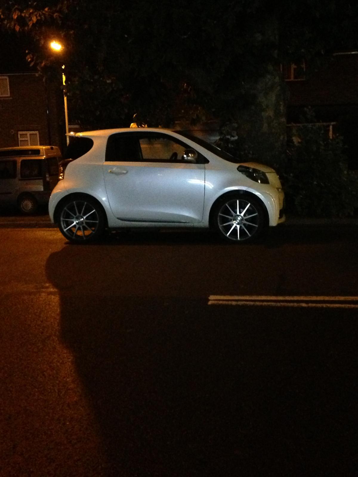

I have 18x215x35. I have heRd a guy had 19's but def 215 the largest
David
didn't think you could fit 18 inch rims on such a small car. does it handle better on the corners than with the original wheels and is the ride a bit more harder. thought tyres that wide would rub the inner wheel arches.
They Fit perfectly. Yes its a hard ride. It is also lowered by 35mm
Here it is
post-109788-0-40033300-1398578994_thumb.
