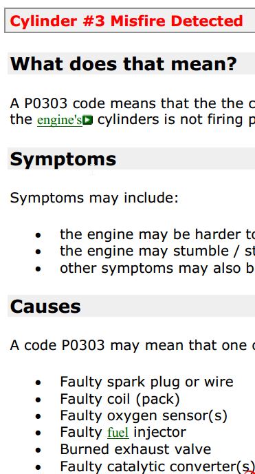

P303 means cylinder3 missfire, with serval possible causes.
Some you could do your self others for a garage.
Runing with a misfire could damage the cat more as unburnt fuel could be going in to it.
