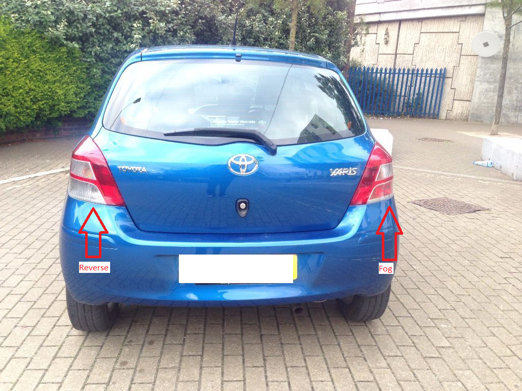

As the OP says the car is an MMT that should make the car a late MK2 Yaris which as Heidfirst correctly stated only has one reverse light on the LHS the opposite side is a Fog see picture attached either that or the car is an early MK3 with mutlidrive and the OP doesn't know what car he has even with 50 years driving experience
Well said above, Frosty, Heidfirst & Devon Aygo.  Jees I hope it turns out it only has one reverse light right enough.
