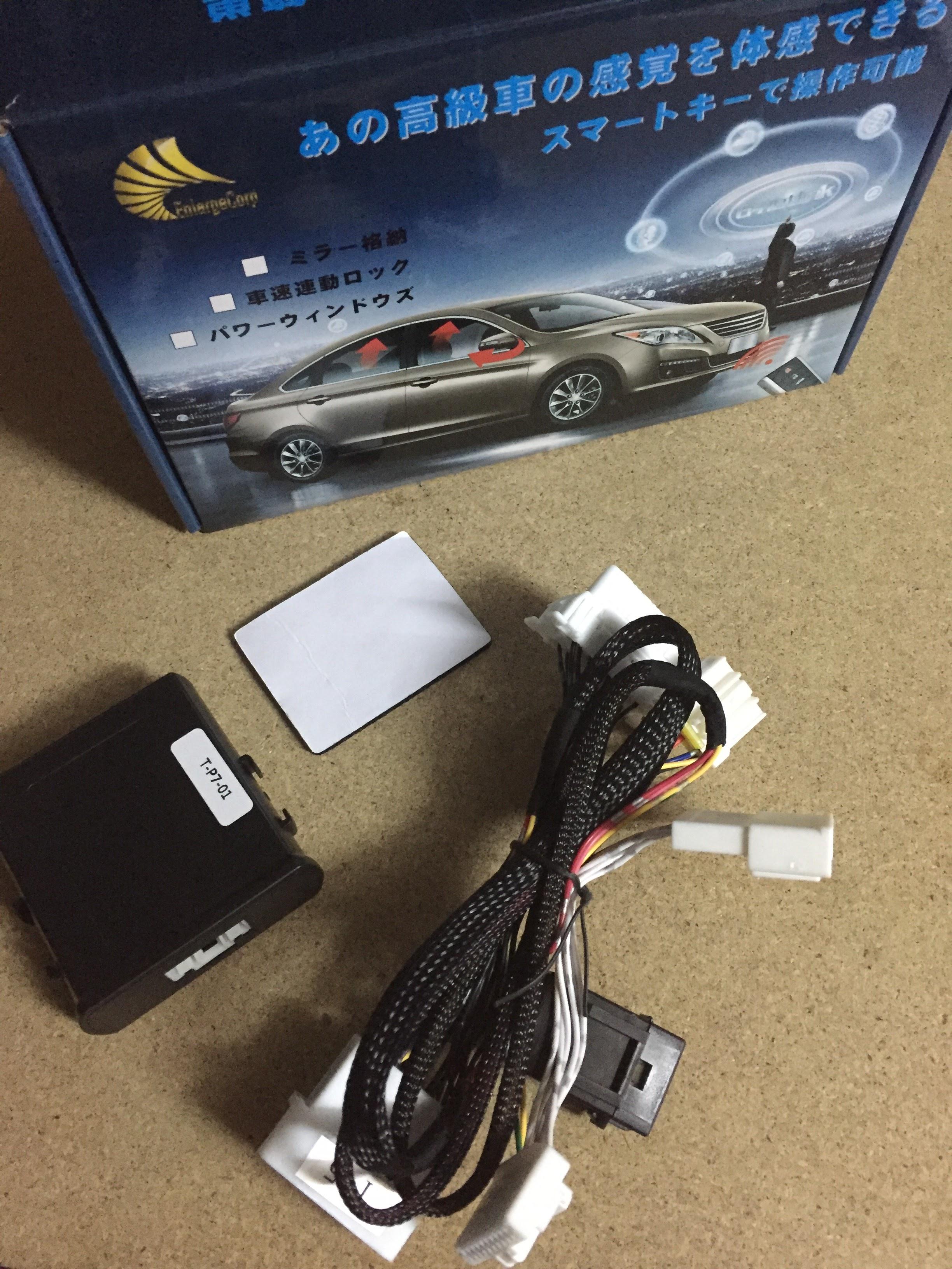

Where did you get that kit from that does the windows as well?
Craig.
What does this accessory do?
Does the mirror close?
Even the glasses?
The site is all in Japanese, I can not understand it ..
