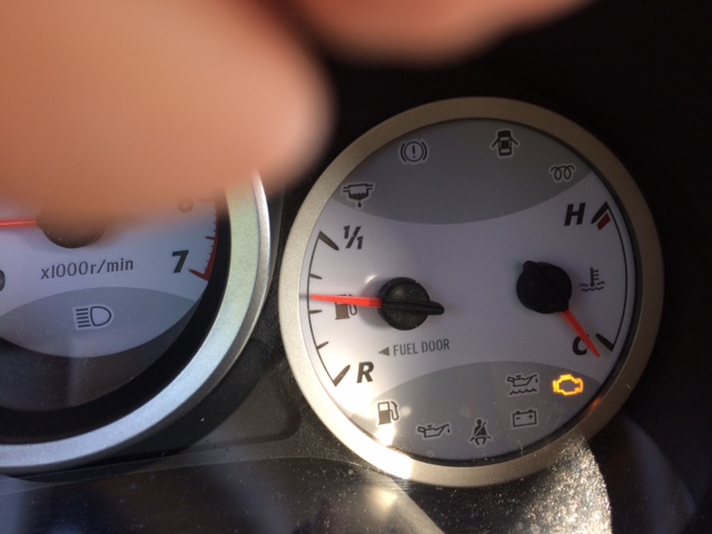

Engine warning light?
Big Yellow

OK, so I ran the diagnostic and I got the error code P0627...  According to Google this is a common issue but it's not clear what the remedy is. Any ideas? Also, in the mean time, the light has gone off and does not come on again. Maybe I should just ignore it... :-)0627.jpg
As the light has gone off, the fault condition has cleared.  With no symptoms, diagnosis is well-nigh impossible.
It may never come back.  Wait and see.

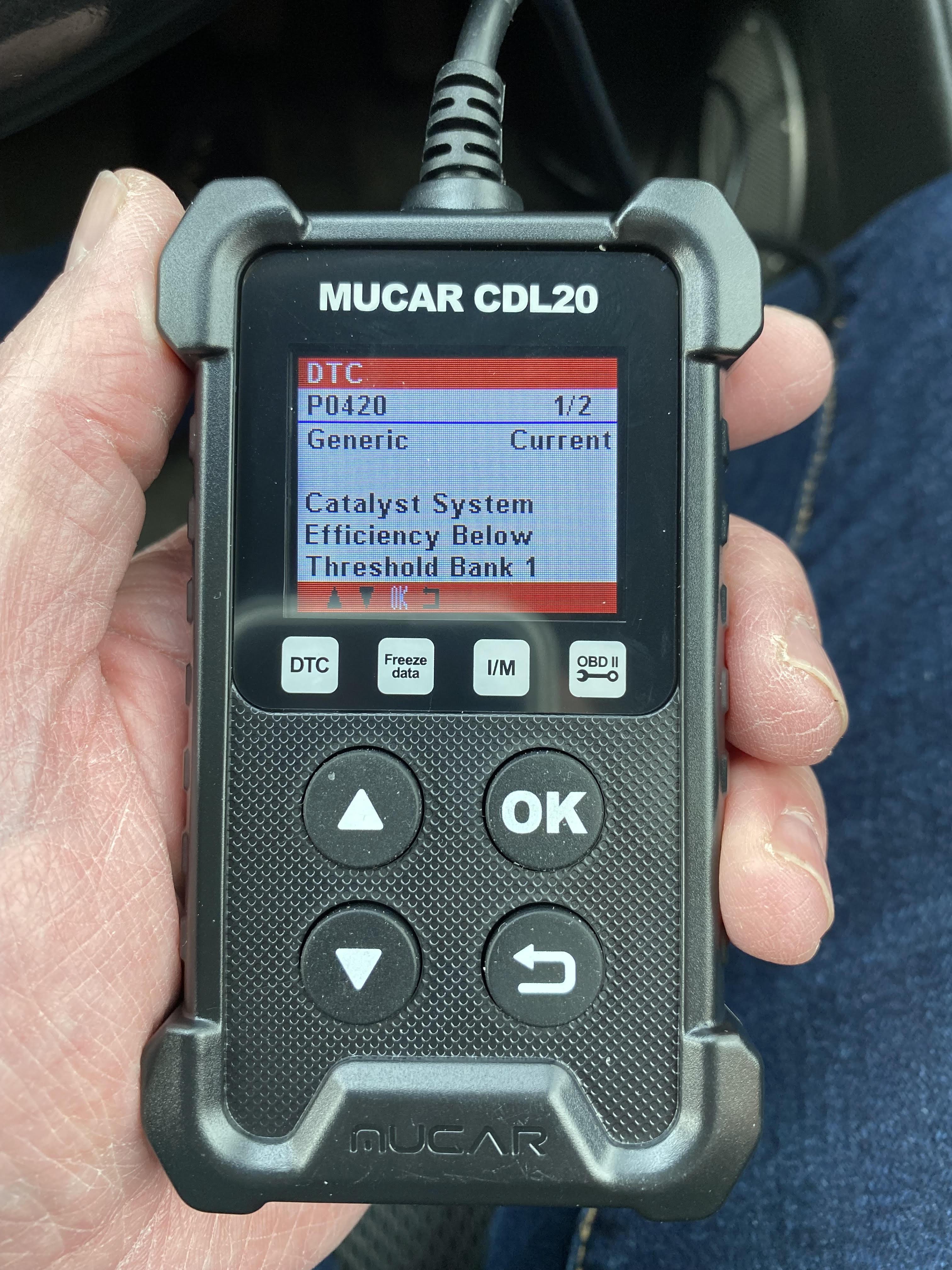

Yes, light was out after a reset for around 30 miles, then came back on again. bought an engine code reader and here is the result:
I've had a similar coded on the wife's Ford many years ago, I changed the O2 sensor on the exhaust manifold and this solved the problem. I copied his from Google, which may help.
All P042X codes (where "X" can be any number) refer to the catalytic converter and exhaust system. P0420 refers to the catalytic converter or - more specifically - the oxygen (O2) sensors before and after it on the bank 1 side of the exhaust system.
This is where it came from:
https://parts.olathetoyota.com/p0420-code-toyota#:~:text='Catalyst System Efficiency Below Threshold' - P0420 Code - Toyota,-Error code P0420&text=P0420 refers to the catalytic,side of the exhaust system.
O2 sensor my guess too, only thing which goes wrong with these, bullet proof . @ £85 for denso one straight swap just unplug and unscrew and refit and plug-in, can then take a couple of days to settle down until ECU sorts itself out. Just need to find which one it is as it has four.
