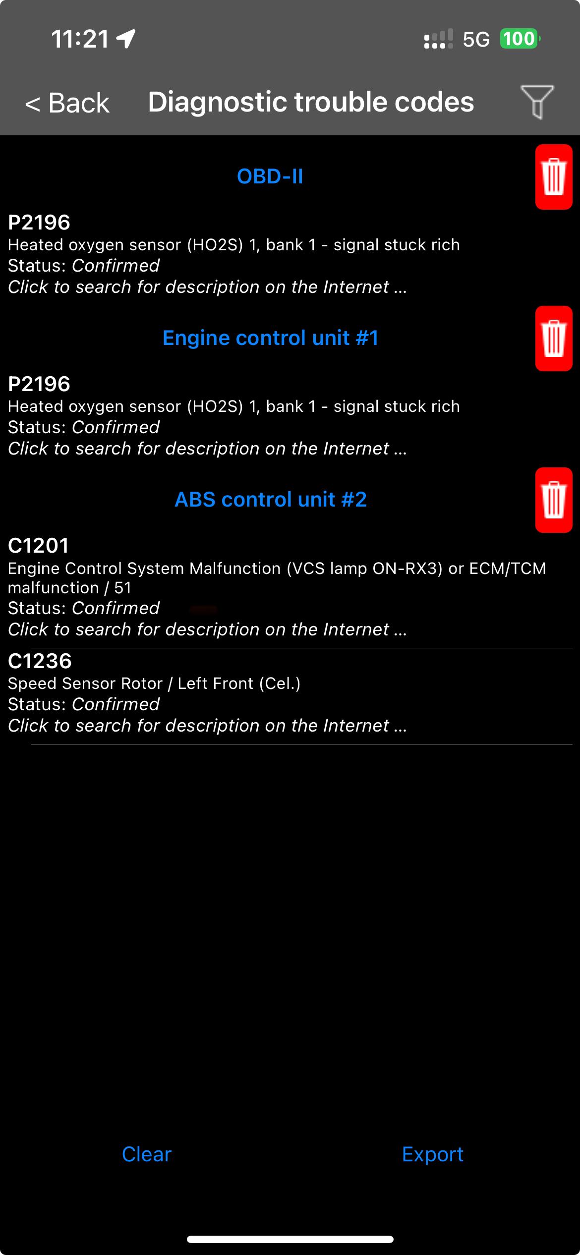

Heej, i don’t know if this thread is still active but I’ll give it a try, I just bought a Toyota urban cruser 2009, and on my way from the shop the VSC and skid lights with the engine light went on.
What do you mean that you bridged 2 points from the OBD?
I have tried driving for 30min on 4th gear and checked the tank lid but no luck. and I’ve tried pressing the buttons.. I don’t know anything about cars so could anyone please help me understand what is wrong?🙏
