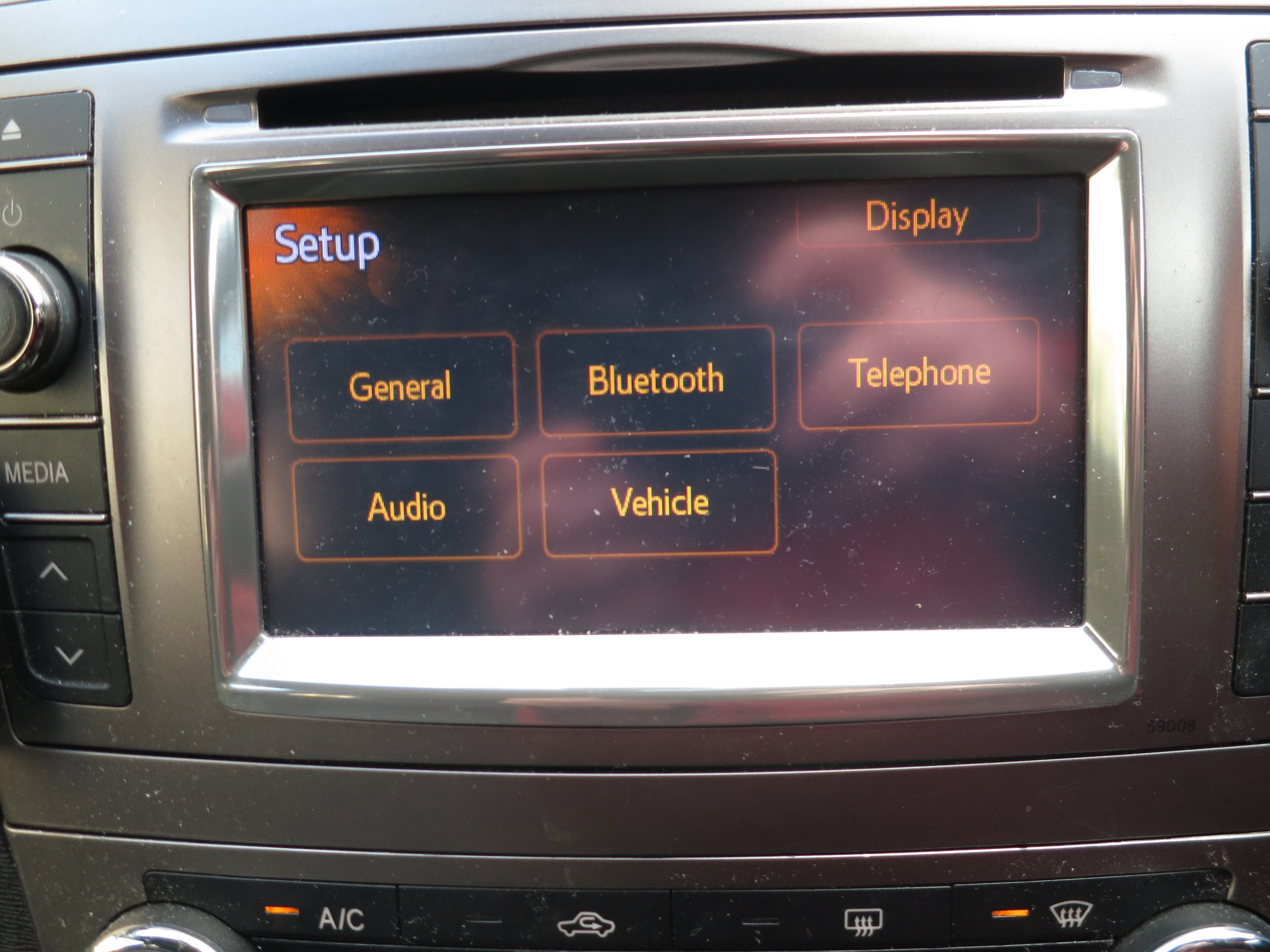

On Touch 1 IIRC there is a "hidden" button in the Display menu that only appears when the headlights are on called "Daymode" or "Use Daymode" I can't totally remember which but once set the display will not dim with the headlights, to access:
Turn your lights on then go to the display settings the button should have appeard in the top RH of the screen press this to cycle the function on/off
Devon, I've got a pic of that that I have just taken on my phone -will upload shortly.
Using Setup button top right of head unit fascia to bring up Setup screen>Display, top rh of screen>Display settings screen.

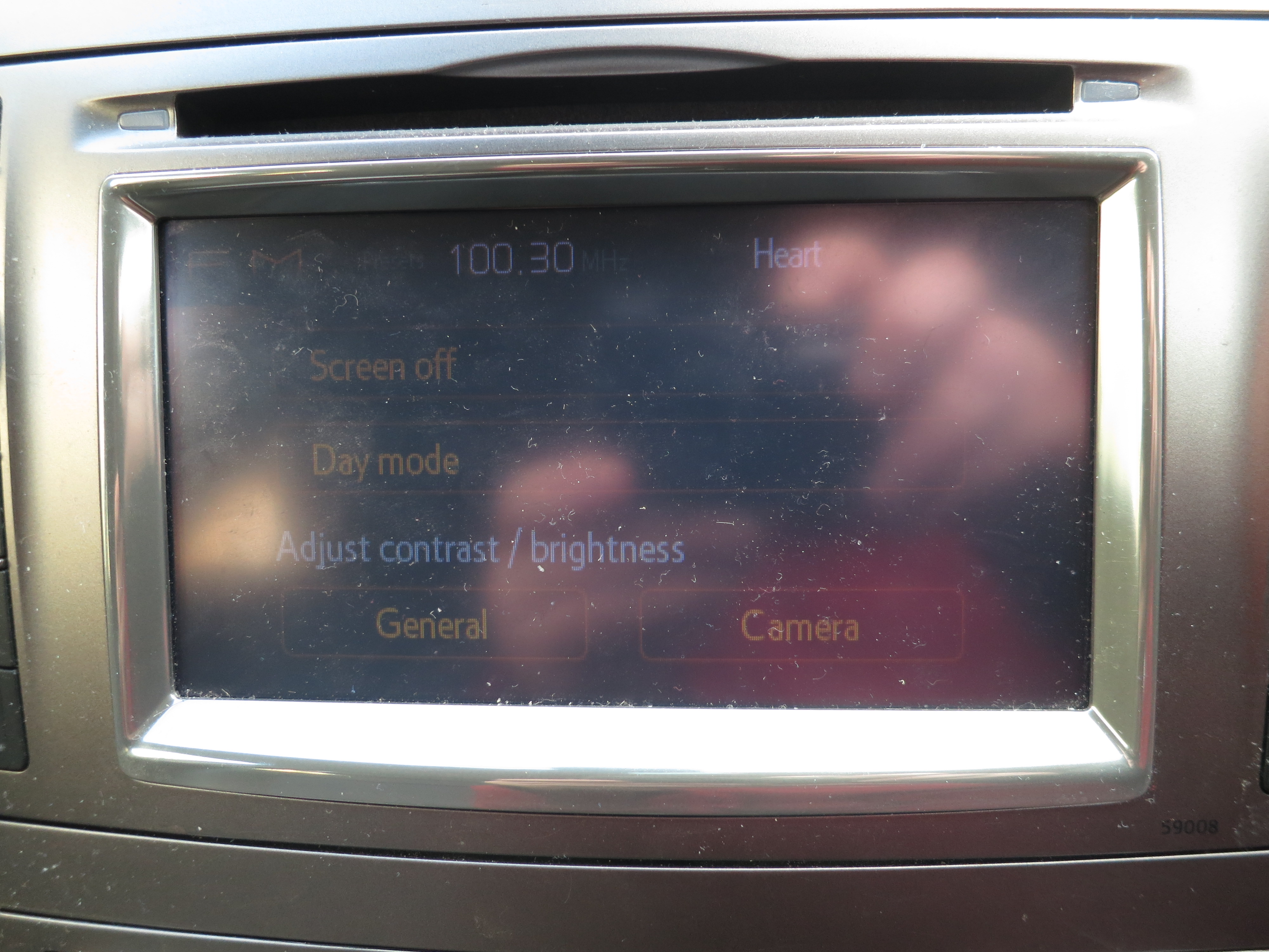

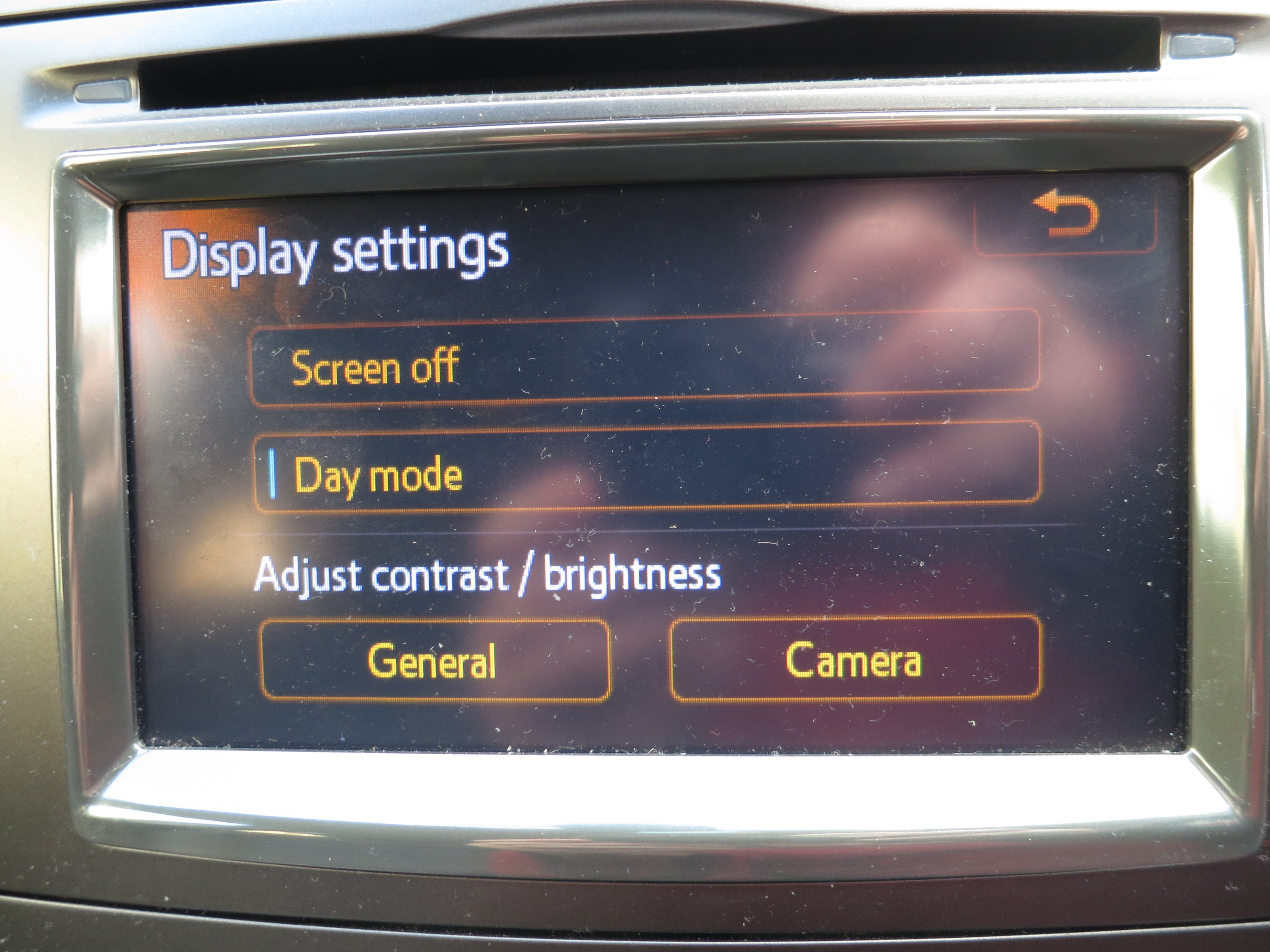

With the little blue bar on the left of Day mode the screen is bright with lights on (img 1137), touch that field & the blue bar will disappear & the screen dim (img 1138). Touch it again & the blue bar will reappear & the screen brighten again.
P.S. I don't know why these screens are not showing in the post in the order that they should. :wacko: & yes, the car needs a dust :blush:
Well I've got to hand it to Devon Aygo, he was spot on with that advice. The display now doesn't dim down when lights are on............How come the "Toyota engineers" in head office didn't know about that,, thanks again Devon Aygo.
