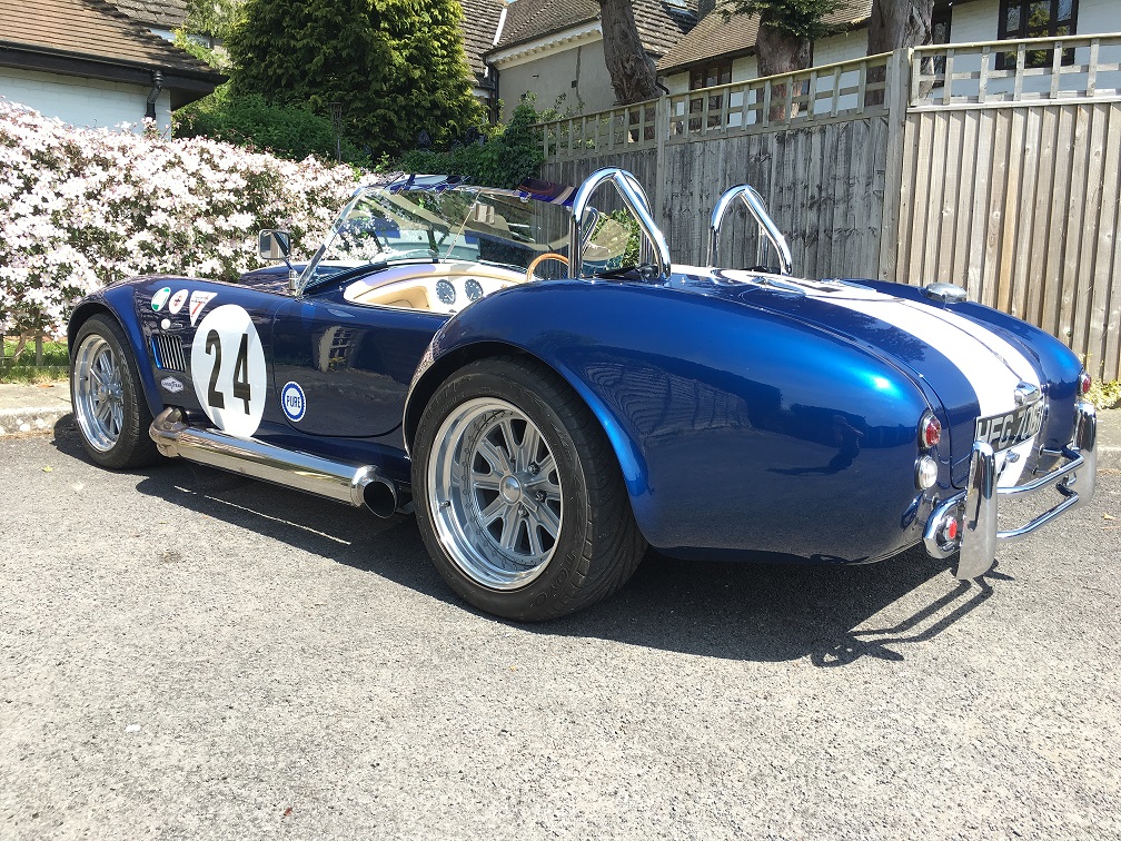

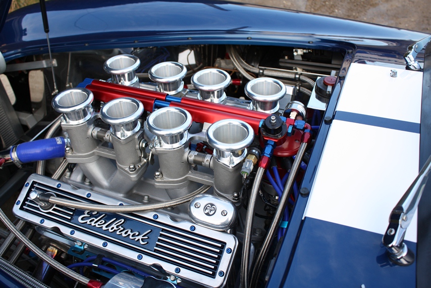

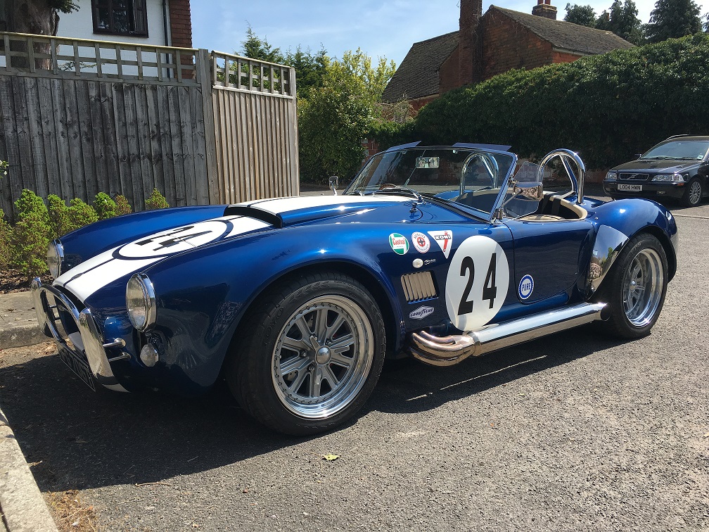

For fun though I drive a car I built myself that has a big American V8 in it. Fuel injected now so not quite so old fashioned but it's certainly a different drive than the iQ. :biggrin:
