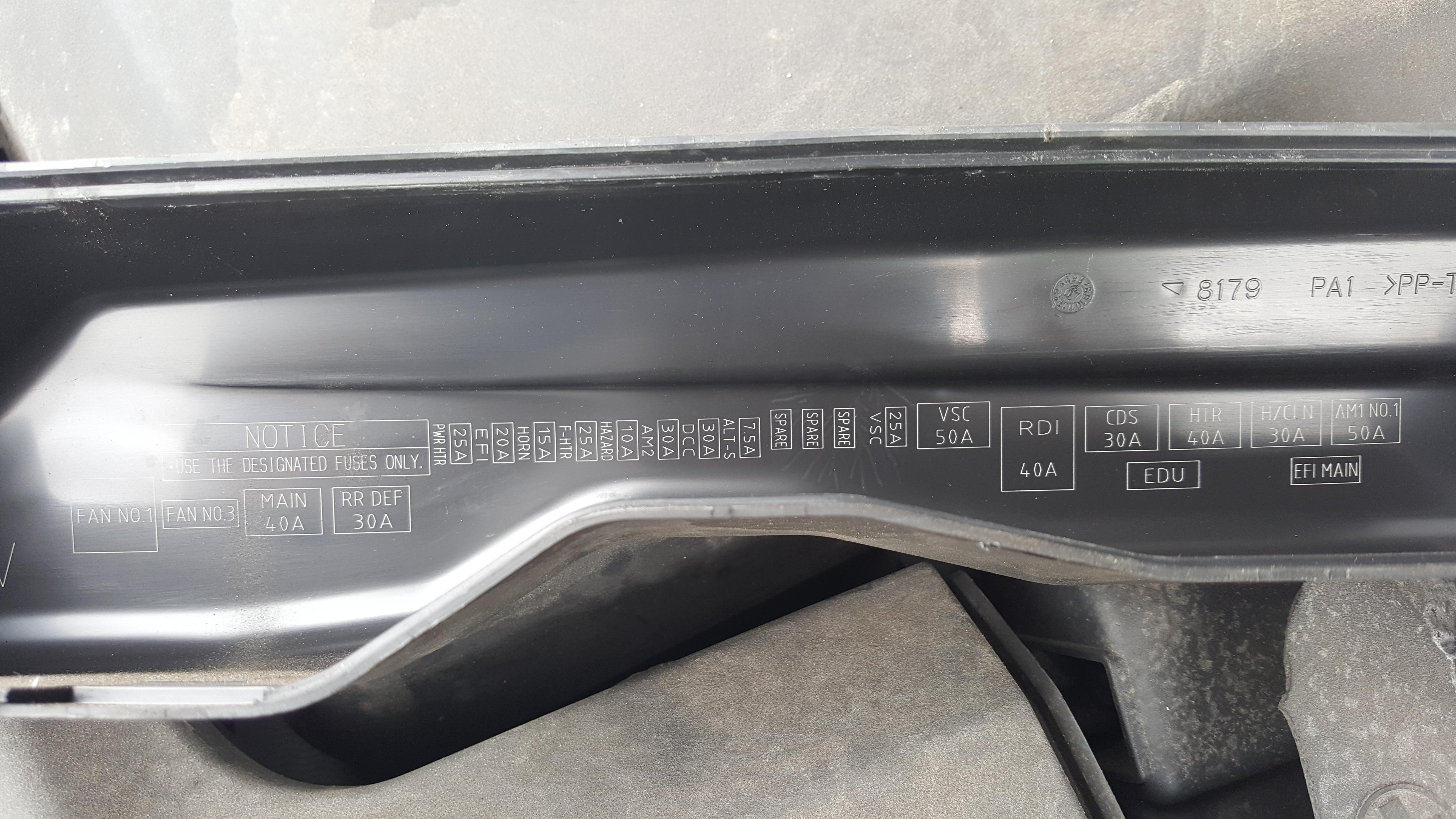

Check the engine bay fuse boxes. There is a label guide inside the lid of the fuse box, detailing the the job and location of each fuse.

Any idea which one is the abs?
The VSC may be linked to the ABS, but I would not really advise pulling! The are a couple more fuse box locations in the cabin. If you have the owners manual, you can get details from that.
