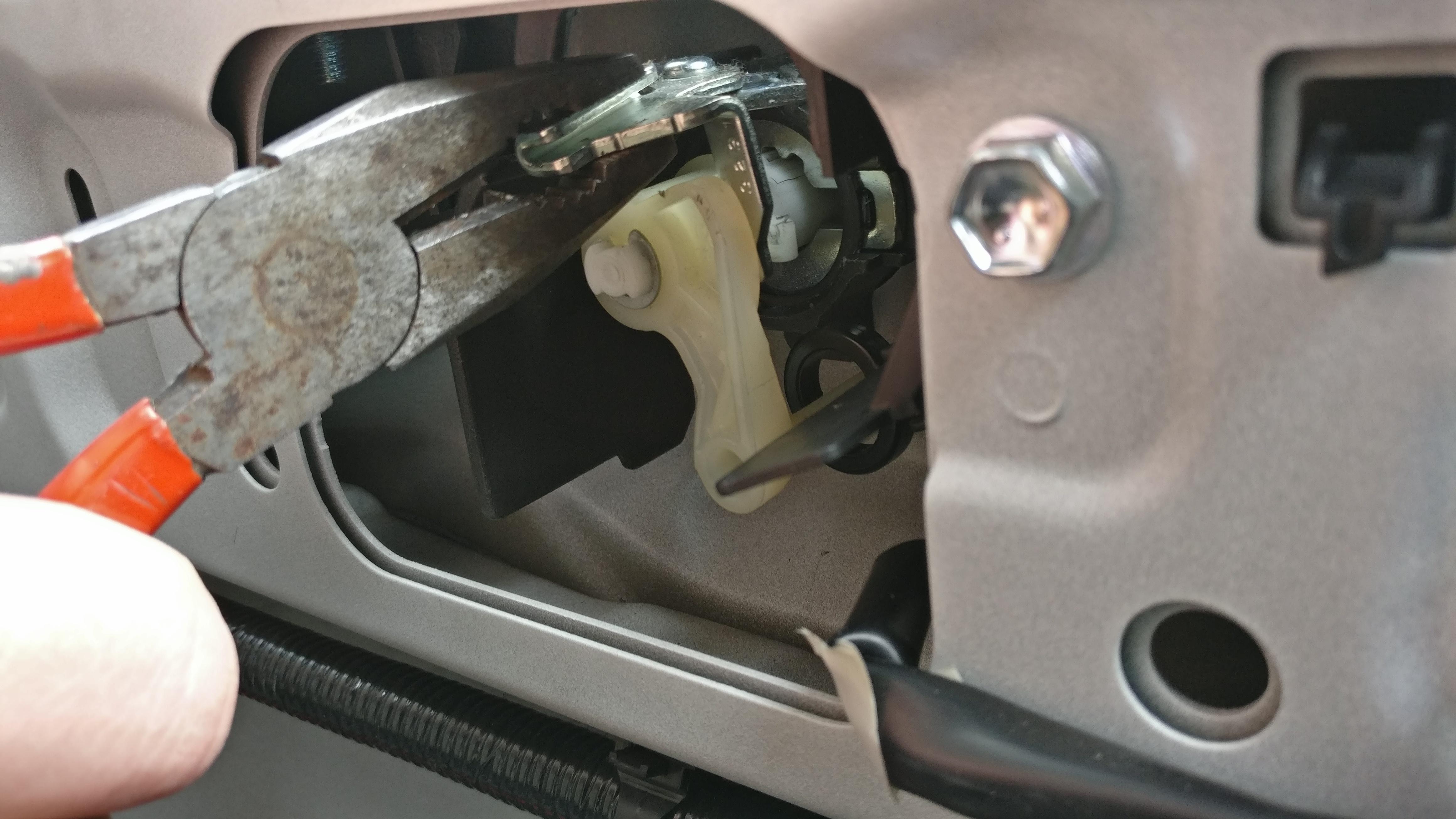

Same thing happened on my C1 flair last week, over the pass month its been getting stiffer and stiffer to the point where there was no resistance with the boot failing to open despite central locking working as normal.
Problem is a fault with the metal paddle which engages with plastic barrel part of the mechanism, its misalligned which goes worst over time as you're having to apply more force to open the boot to the point it's bent out of line of the plastic barrel.
I was able to fix it in 10-20mins by bending the paddle back into its level position, no longer needs any force to open.  Boot can be opened from the inside by flicking the black latch top right of the locking point. (If you're in warranty get them to fix it.)

Took me 15mins to do with a pair of adjustable grips

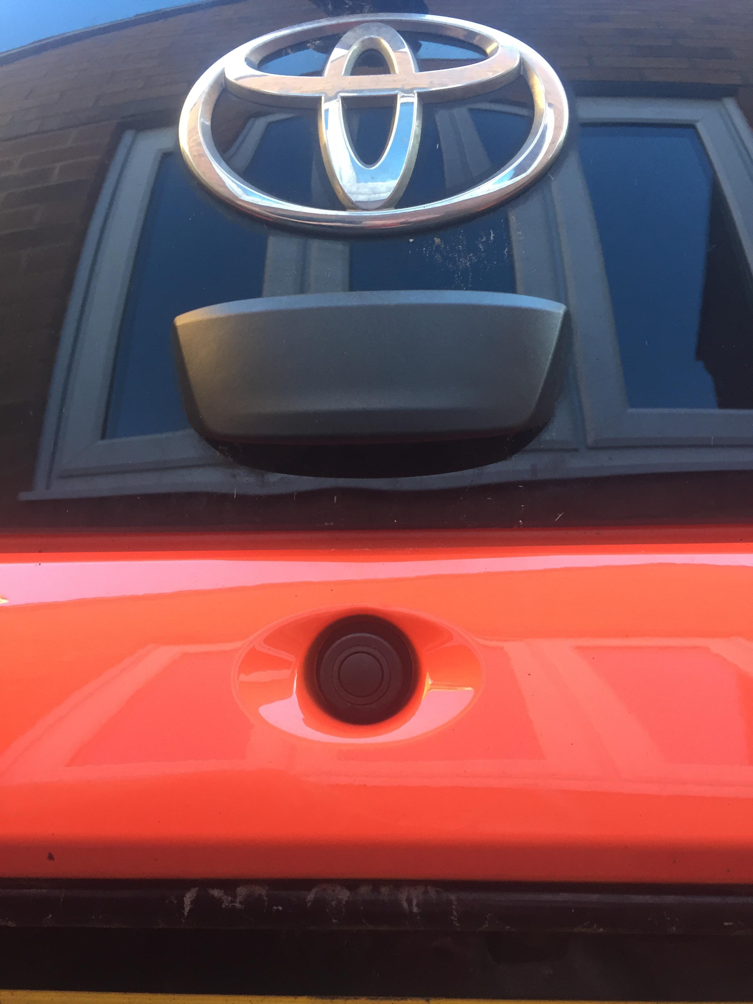

Interestingly I don’t have a boot button and It’s totally electronic to open. There is a black button in its place to lock/unlock the car, and to open the boot you press a button under the little plastic boot handle

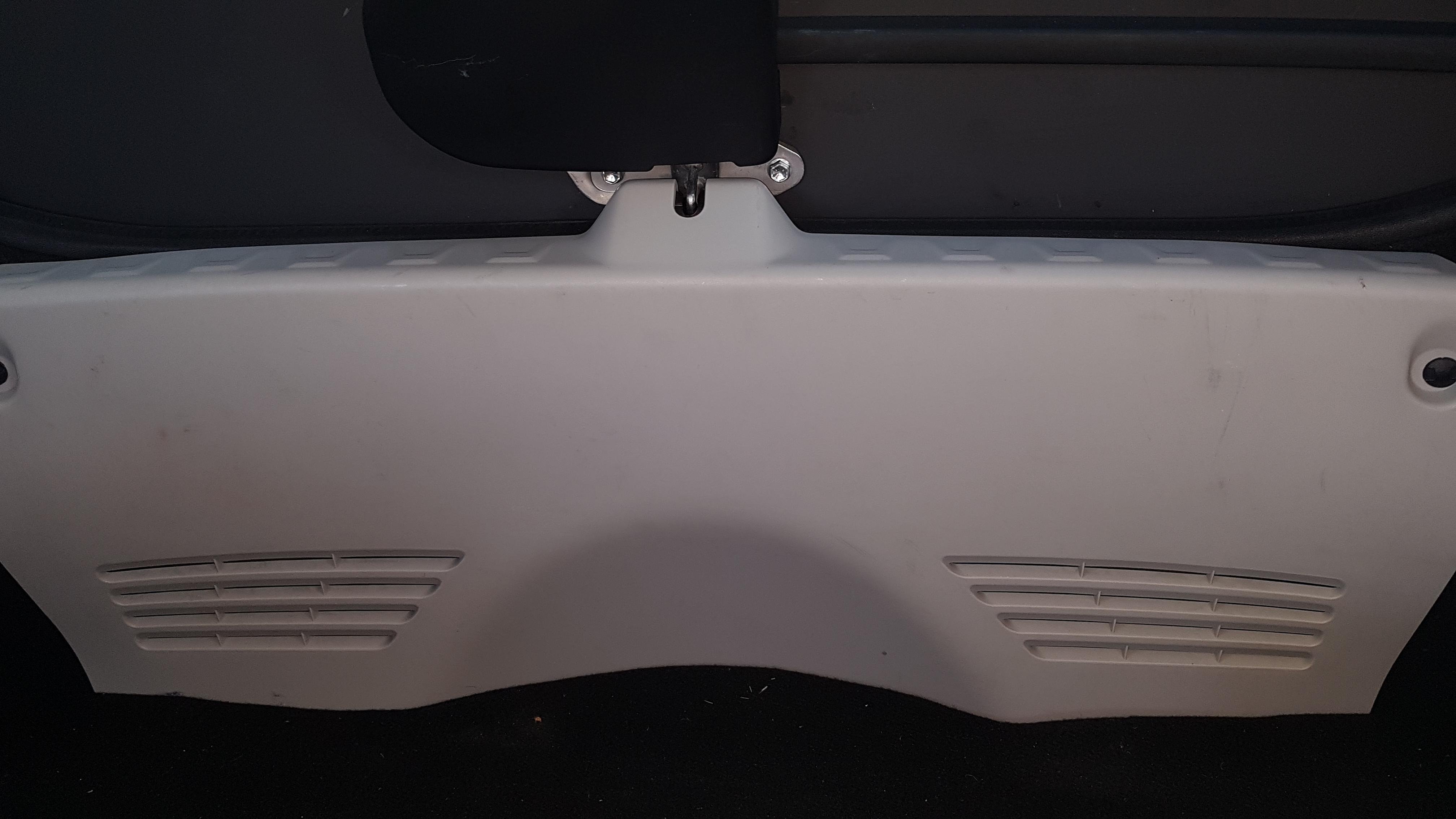

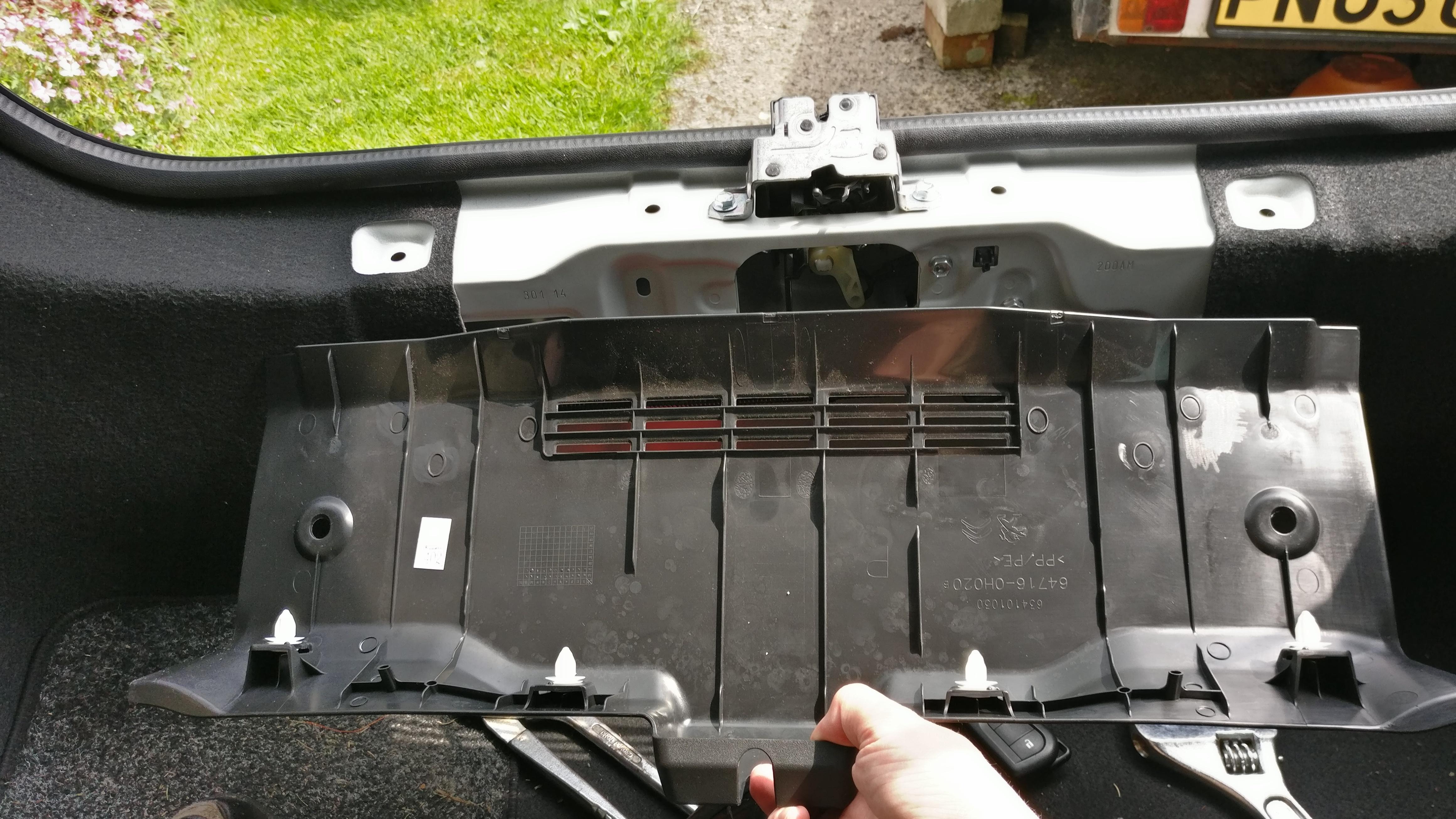

got a daft question how does the cover come off??
i managed to get the 4 black pins out but the cover still seems stuck on top edge.
didnt want to force it as i assume i can get it fixed under warranty
It's being held there by the boot door it's self.  Get your hand up behind the plastic cover and unlatch the door, should be a switch at the highest point that you can flick to unlatch.

Its alot easier to "adjust" it correctly if you take it out..its easy to remove ..if you want to replace it then the part cost me £23.75 including VAT ,genuine part from the dealer (Citroen C1 2014) its the same part in an Aygo..
