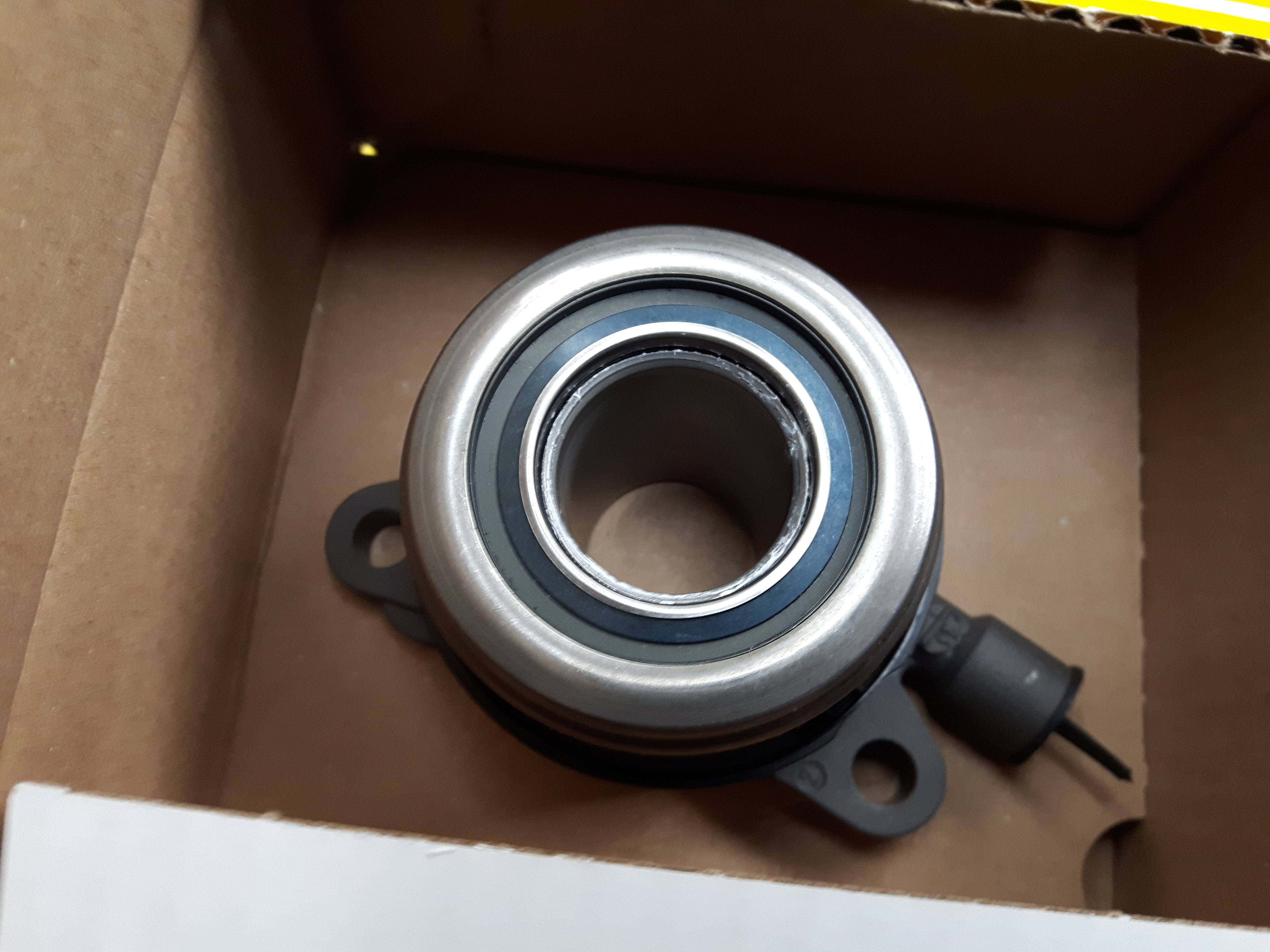

Here is my clutch release cylinder (I call it concentric slave bearing) before the clutch replacement.
It is best to change the concentric slave bearing during the clutch replacement. If it is leaking, the clutch could be contaminated. The previous system of an external slave cylinder was much simpler. Lets hope it is the master cylinder.
