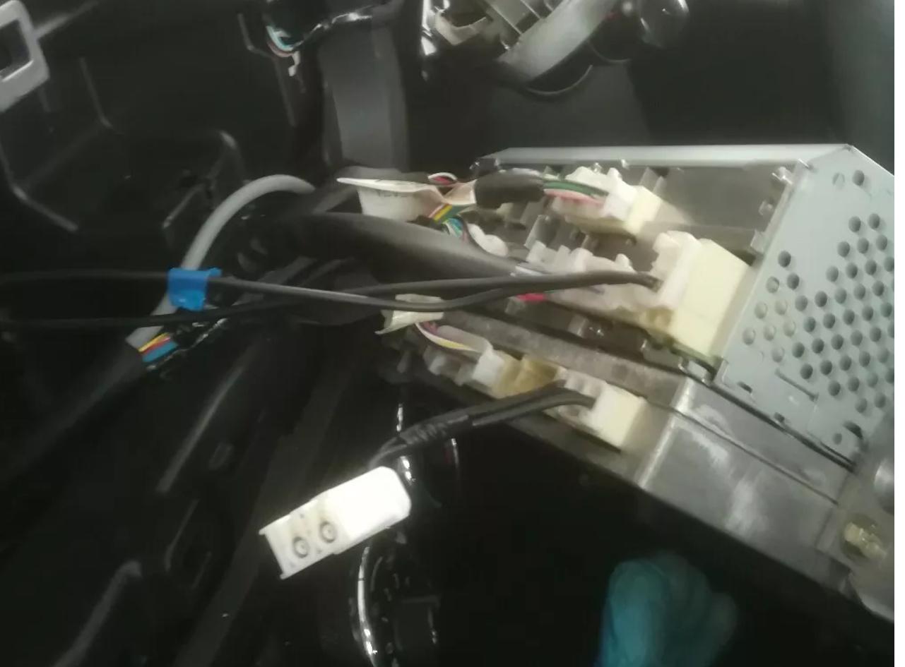

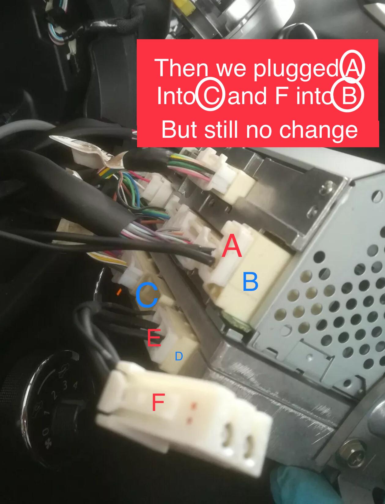

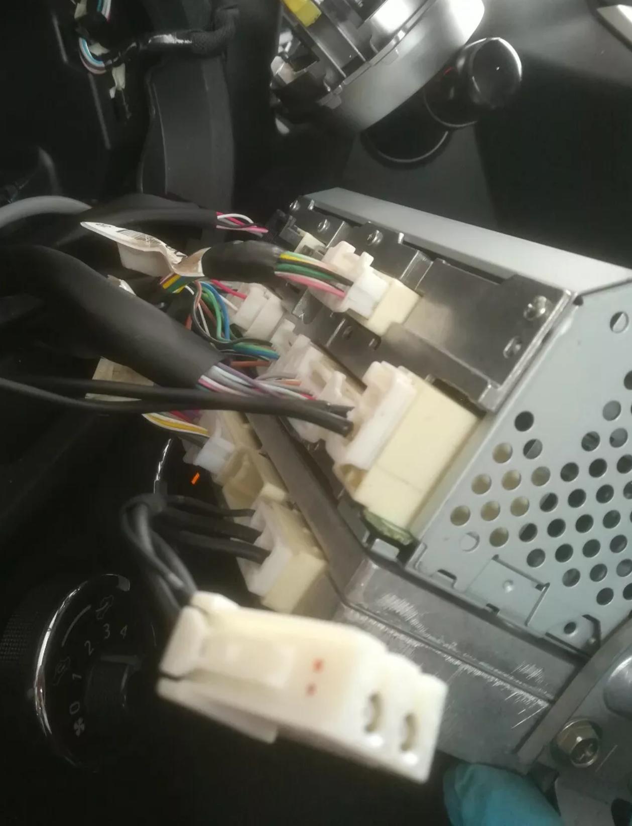

I have just purchased today the sat Nav unit fitted in 5 minutes everything came straight on even the satnav but it wont calculate any new destination or upgrade think I’ve done something wrong somewhere I don’t think it’s picking up a signal

have you fitted the correct satnav module for the head unit (the original Touch?)?
do you have a gps antenna?
