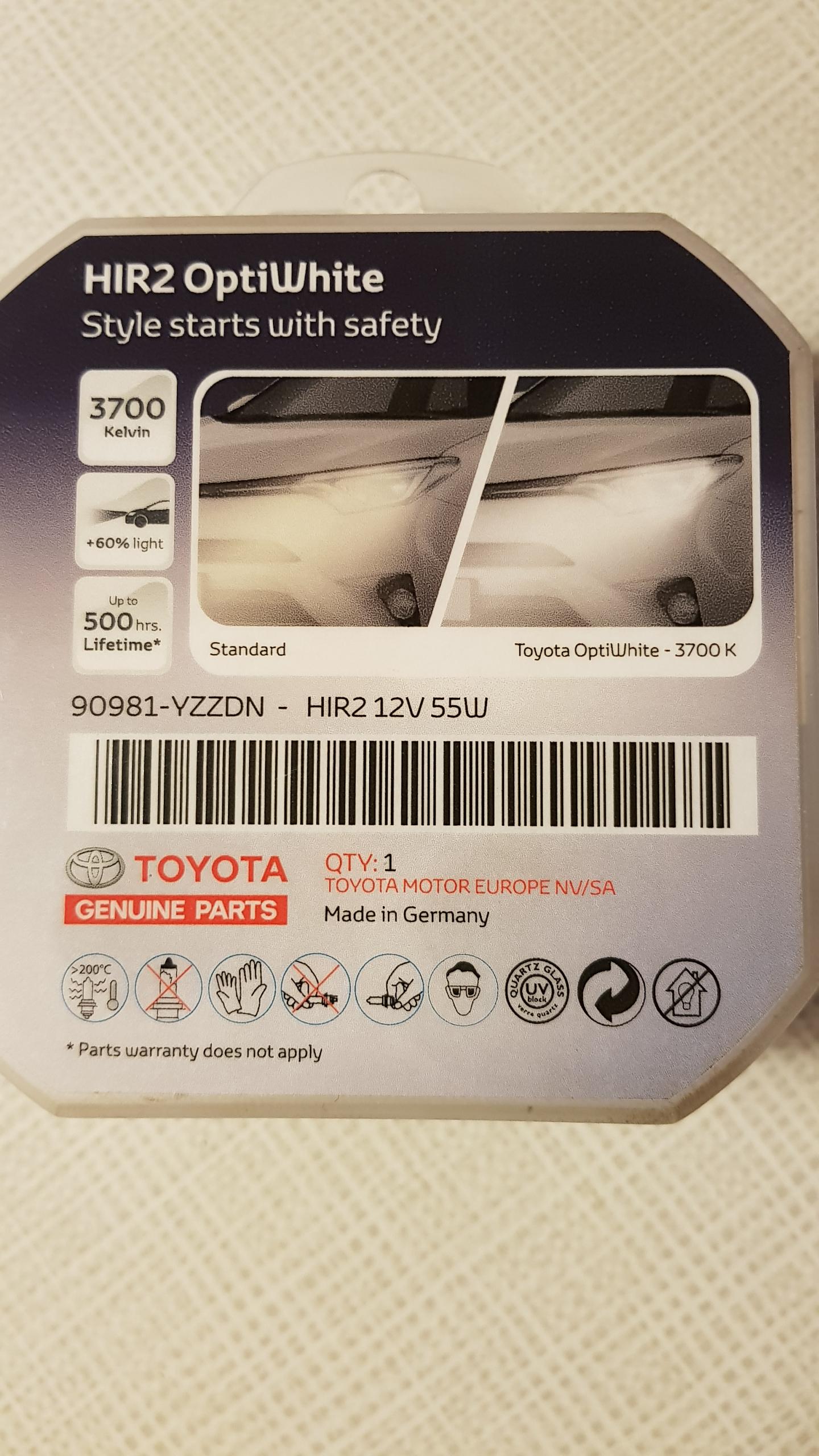

There are new Toyota HIR2 bulbs avaliable. I've just got them on my Auris. The light is much more bright, the factory ones were more yellow. I think Toyota calls them 'Optiwhite' and claims 60% more light. The price is around 60£ for the pair.

I just asked my local Toyota dealer, and they installed the bulbs too.
There is some improvement. The light is more White, better brightness. The range is better, but not much. The thing about light is that you forget in 10 sec. how the old bulbs used to perform.

In the UK, the Toyota Optiwhite HIR2 bulbs are £48.77 including VAT for a pair.

That is what is confusing me. The TOYOTA bulb pictured in this thread is made by Philips right? It just seems they do not list it on their website. So it just means they got the exclusive TOYOTA contract.
The 150 Philips has not enough a lifespan (300 hours?). It seems it was the Philips eco's that were fitted initially at factory with 2000 hours (100,000 KM) lifespan but I got nowhere near this now it seems...
My dealer stated clearly they have a Toshiba. It was charged at a higher rate.
