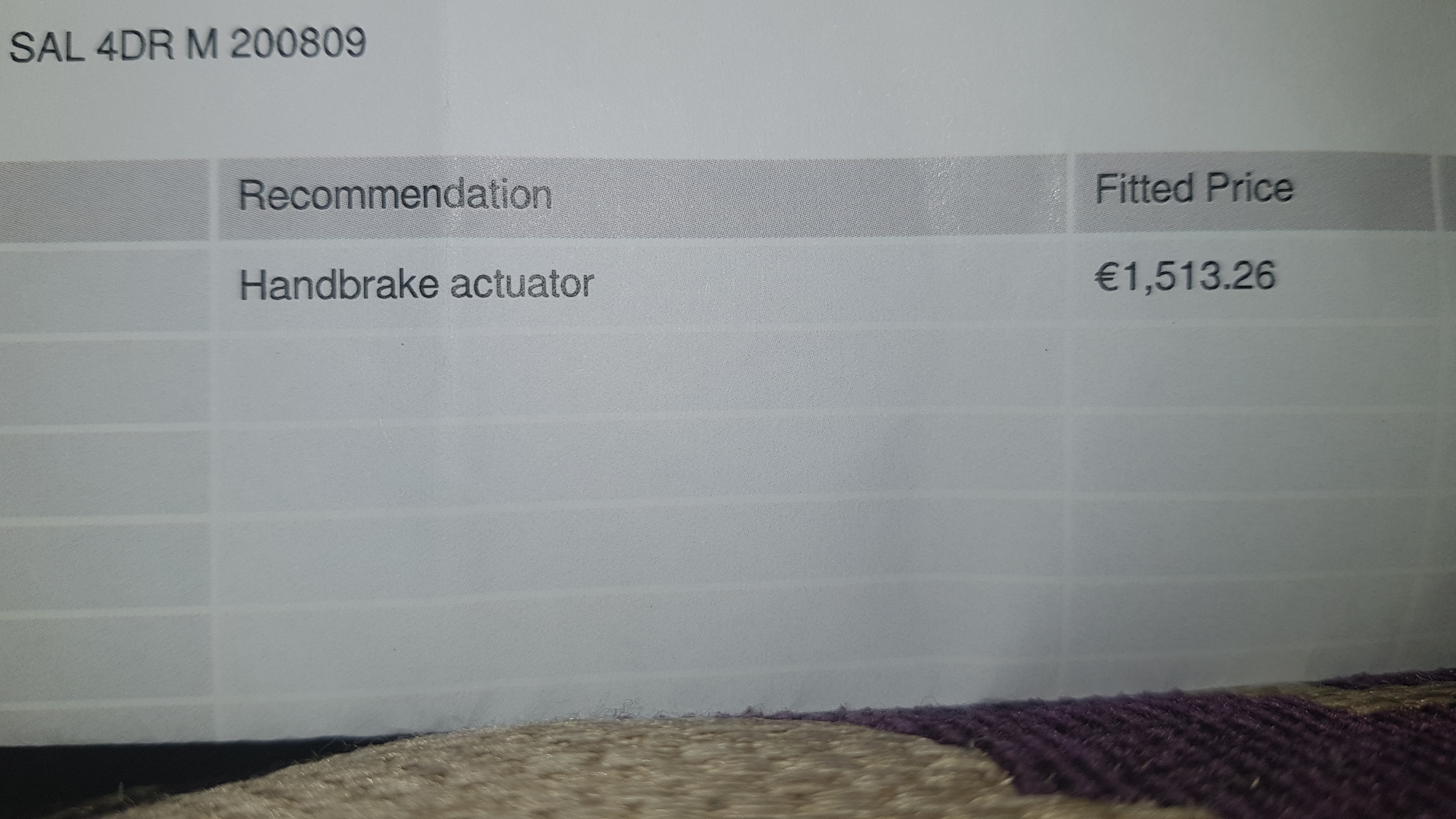

Thanks for your reply , unfortunately bad news , took it to two different mechanics and both ran independant diagnostics , and they confirmed the actuator is the problem , new one going in on Thursday morning .
On the plus side it explains why the car was so heavy on brake pads and why I have replaced 3 rear calipers over the past 2 years , the mechanic reckons the handbrake hasn't been releasing properly in a long while  .
For my trouble I have a nice bill coming my way.

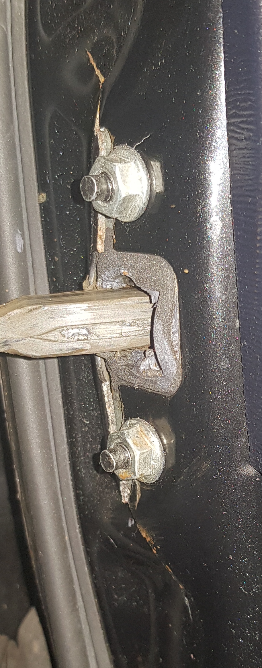

Not sure if the pin was a stress fracture . But there was another twist in the tale , I had to get both passenger and drivers door replaced , there was a crack down along the seem of the doors , according to Toyota it's an flaw on the seem of the doors which causes a stress fracture over time , by all accounts it's on avensis between 2009 to 2012 , Toyota are replacing the doors free of charge .
We are aware of the potential issue with the front doors (I had my driver's door done on my 2012 & Konrad has it on his car) however, I am a wee bit surprised that Toyota Ireland (where you don't even have the 5 year warranty) are replacing them foc on an 8 year old car.
My doors are not as bad as those. That is the worst I have seen. I used large washers to spread the load. I need to inspect the doors to see how they are.
