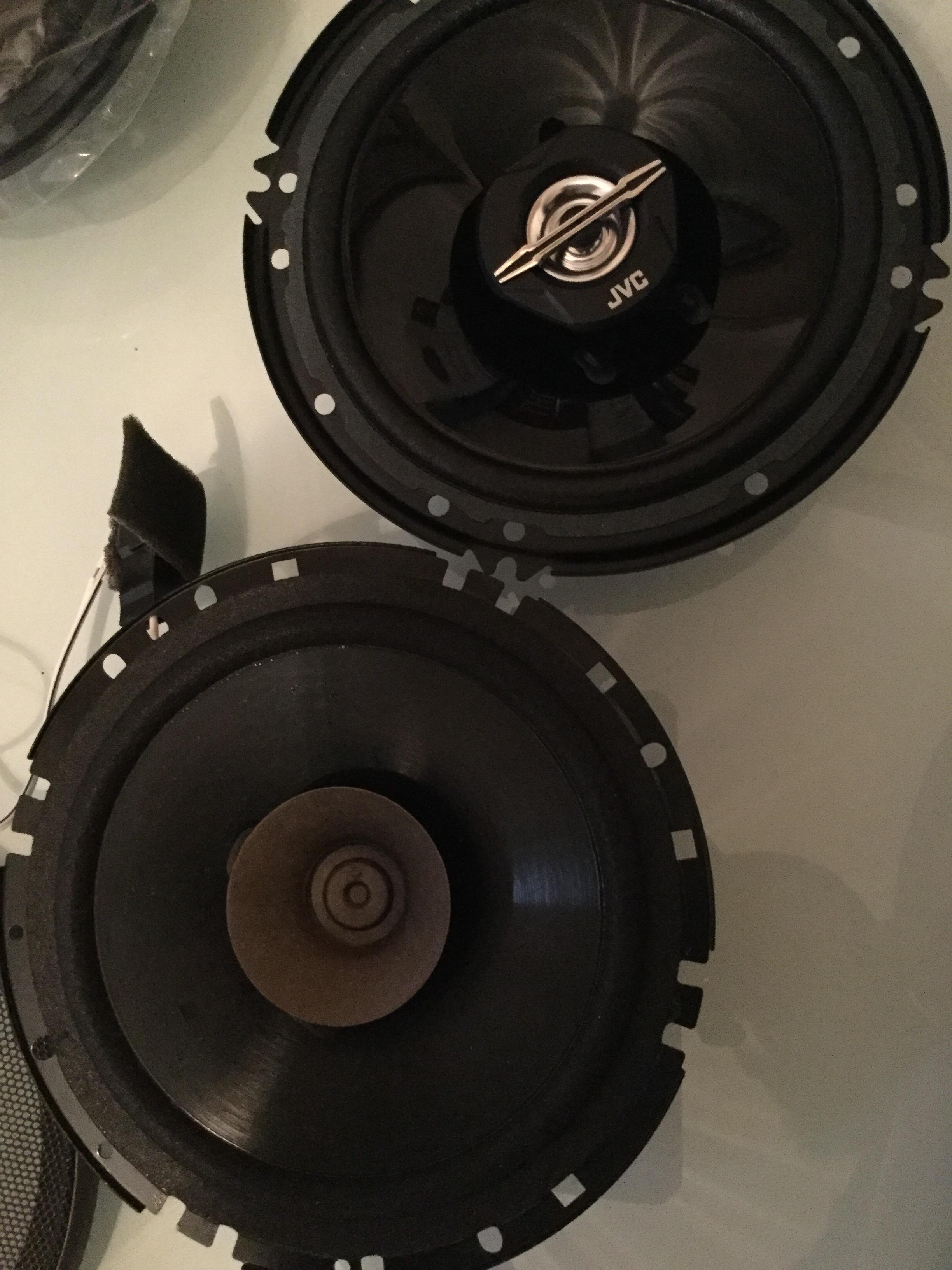

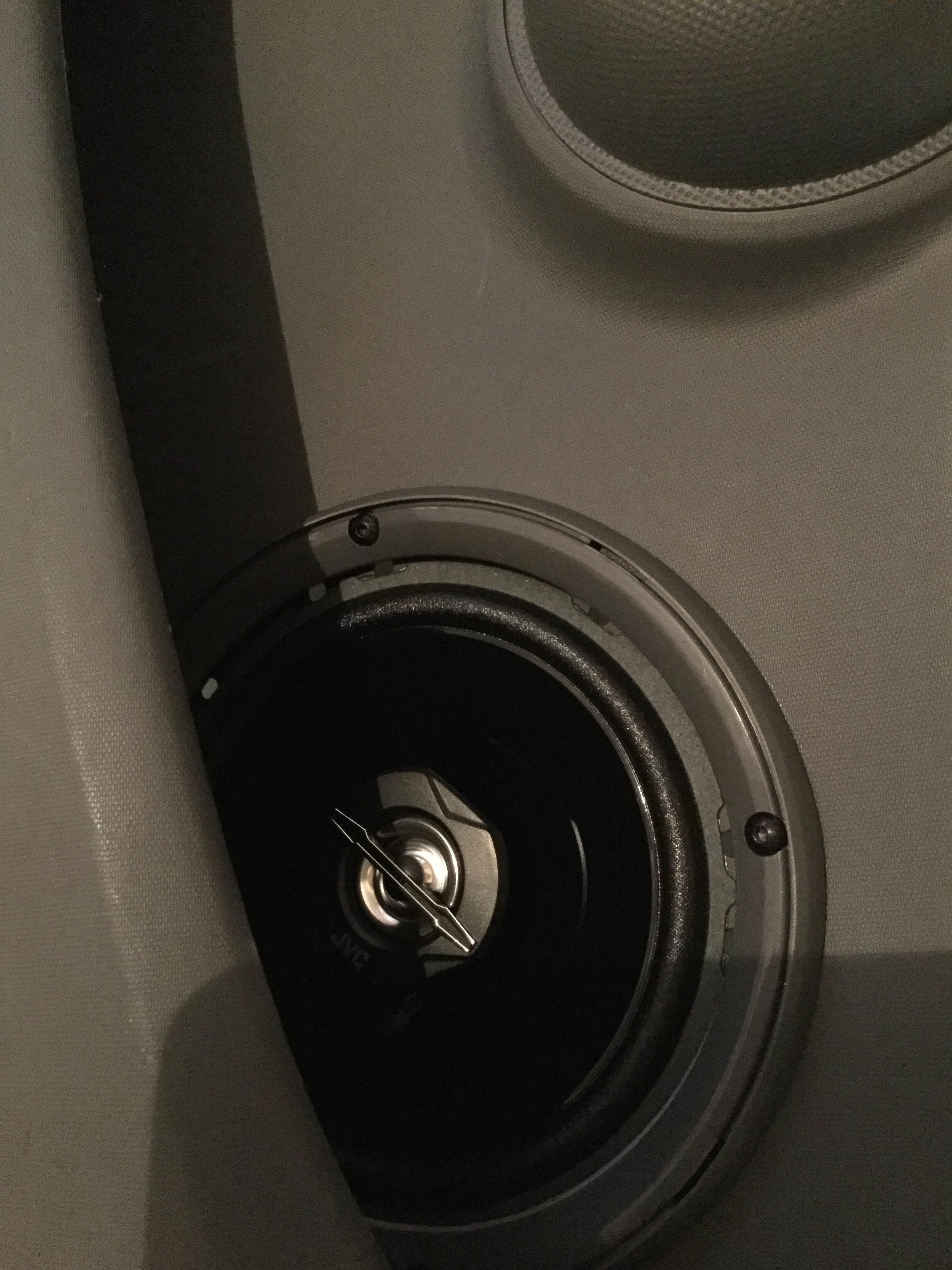

Door speaker upgrade complete. I really didnt want to spend too much on this project, hence 16cm JVC coaxial Speakers on budget.
Tomorrow i intend to upgrade the fronts, 10cm version of the same JVC model as my door upgrades.
Surely these have to make a huge difference to the 15w stock install.

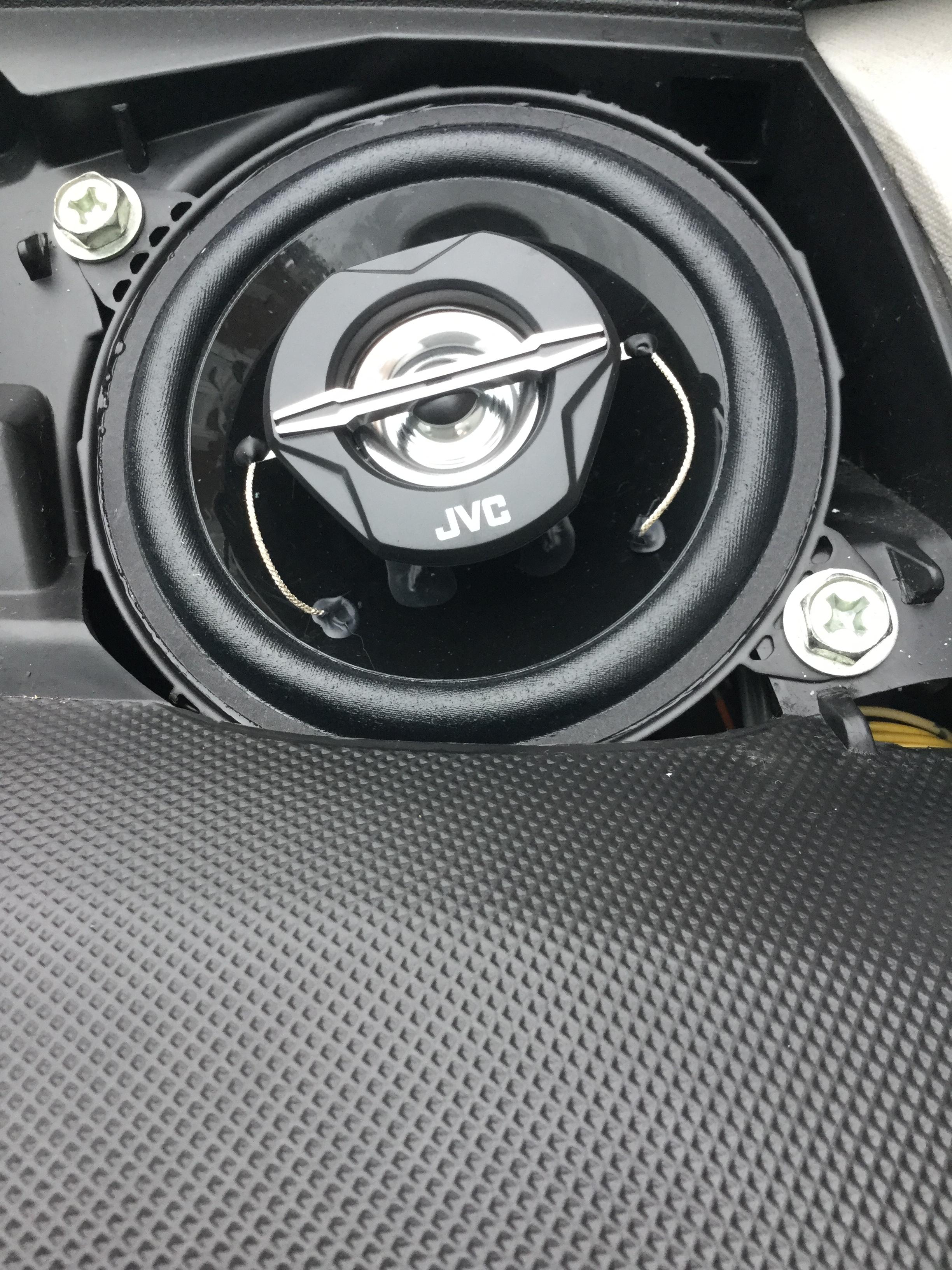

Thank you for the input guys, finished the install on my front dash Speakers, followed by a test run....not bad at all...nothing special...if anything at all to a real audio freak...but definitely a huge improvement on the stock set up...alot more clarity hit me first.
