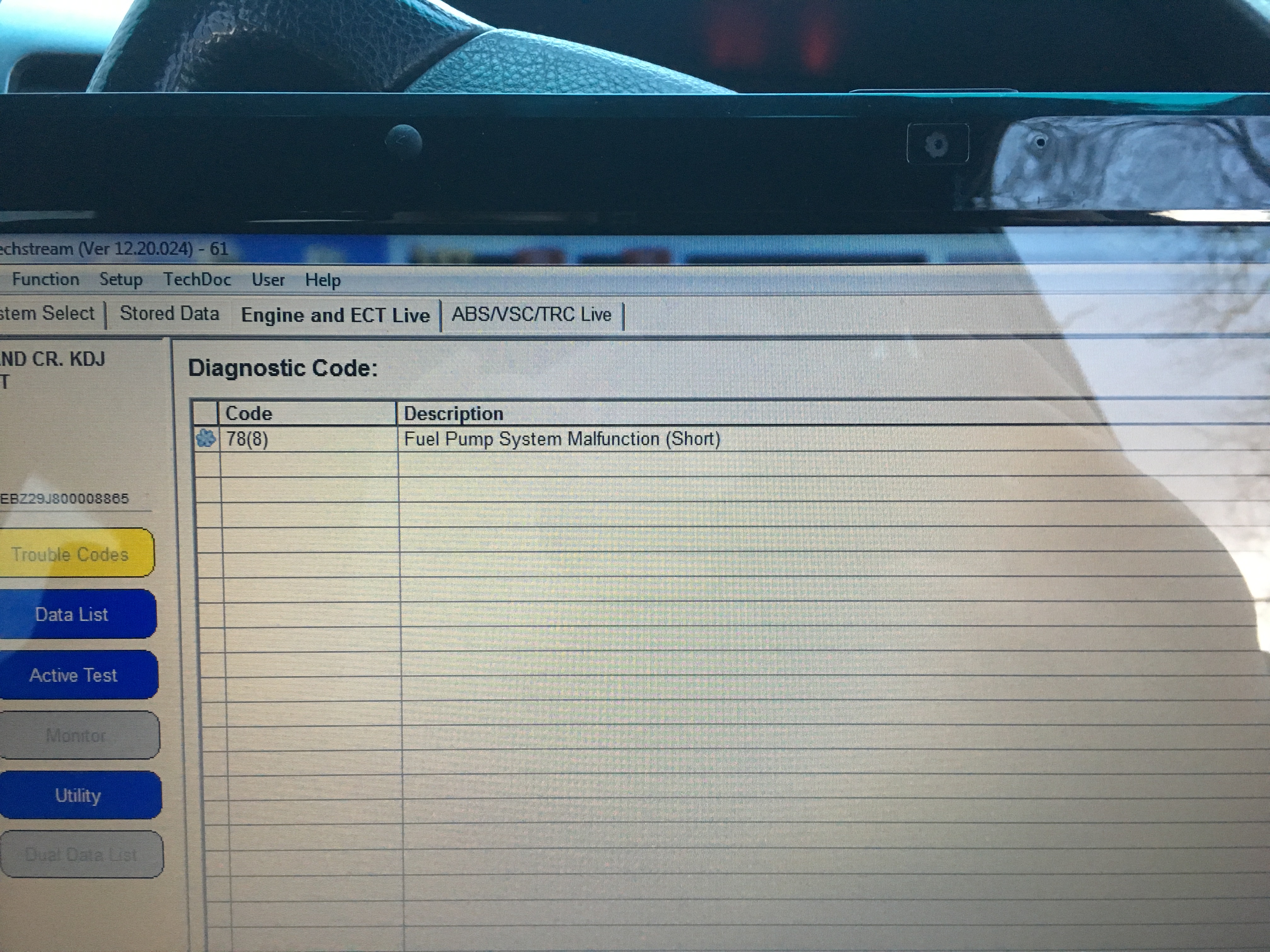

Hi all,
Been trying to find out what exactly could cause this fault code - ‘Fuel Pump System Malfunction (Short)’. Hesitation on accelerating, but only in cold weather & when engine is cold? Changed air & fuel filter. I just got Techstream off eBay, but don’t really know how to use it properly yet. Here is a pic. Could it be the SCV’s I keep reading about or maybe a wiring fault? It’s fine when engine is warm. Thanks in advance for any advice.

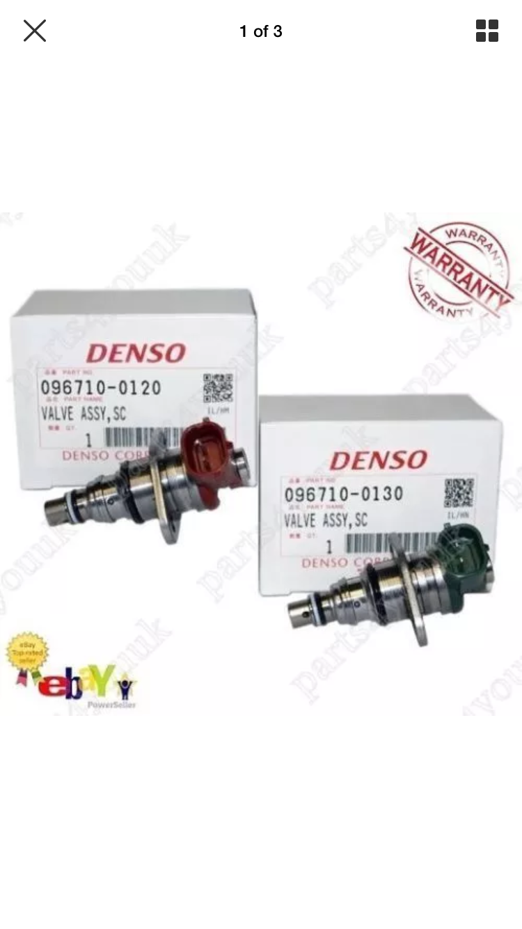

Just been looking on eBay. Think these are for the KD engine. Will maybe try cleaning the old ones first though, before spending £123! Do you know why 2 are used on this engine? Cheers.
