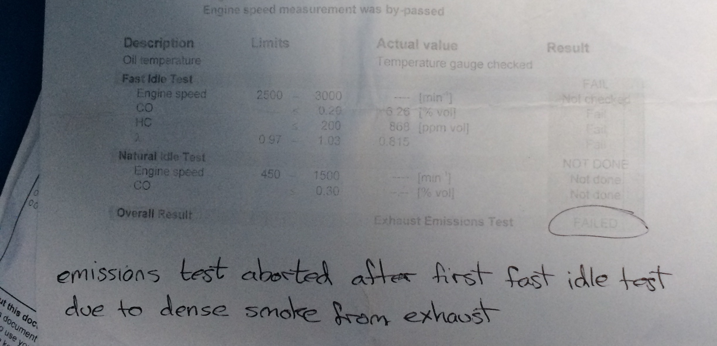

It failed it's emissions test. In fact, it was aborted after first fast idle test due to dense smoke from the exhaust (see image).

Based on those figures it looks like it's running rich and the hydrocarbons readings being so high could suggest that your cat might be shot. (if you have one installed that is!)
Was the car hot or cold when it went in for the MOT? A good thrash before the test helps. If it's not had a good raz the cat could just be all clogged up.
Chucking in some injector cleaner like redex or similar can't hurt at all.
Do you have an aftermarket intake? Could be the car is sucking too much hot air.
Could also be bad readings from the lambda, you can grab one online fairly cheap.
Could also the be the post cat O2 sensor. Again fairly cheap to pick one up.
And if that doesn't work, a new or second-hand cat is the last option.

PS: forgot to add. This "dense smoke" can you reproduce that? if you rev up to around 3k what colour smoke are we talking about here?

Yeah the dense smoke, kinda blue I guess, need to check again.
Update: had a mechanic look into the engine today...
Spark plugs are terrible, in fact, so bad he had to take a picture and send to his colleague! He reckons they stopped making the ones I have in 2004, which could indicate they haven't been changed in all that time?! He doesn't think that a new engine is needed but new plugs, rocker cover, gasket, carbon clean is all that's needed. £70 inc. labour.
I won't hold my breath on this. I can see that it will probably help and if it gets me through the MOT then that's something but I think it's a deeper rooted issue as said. But you never know, maybe I'll get lucky! If not, worst case scenario, £70, fail the free retest and I'll buy another Celica. And sell this one for parts. If it goes through it's MOT, I'll still have it fully looked into afterwards, full service.
