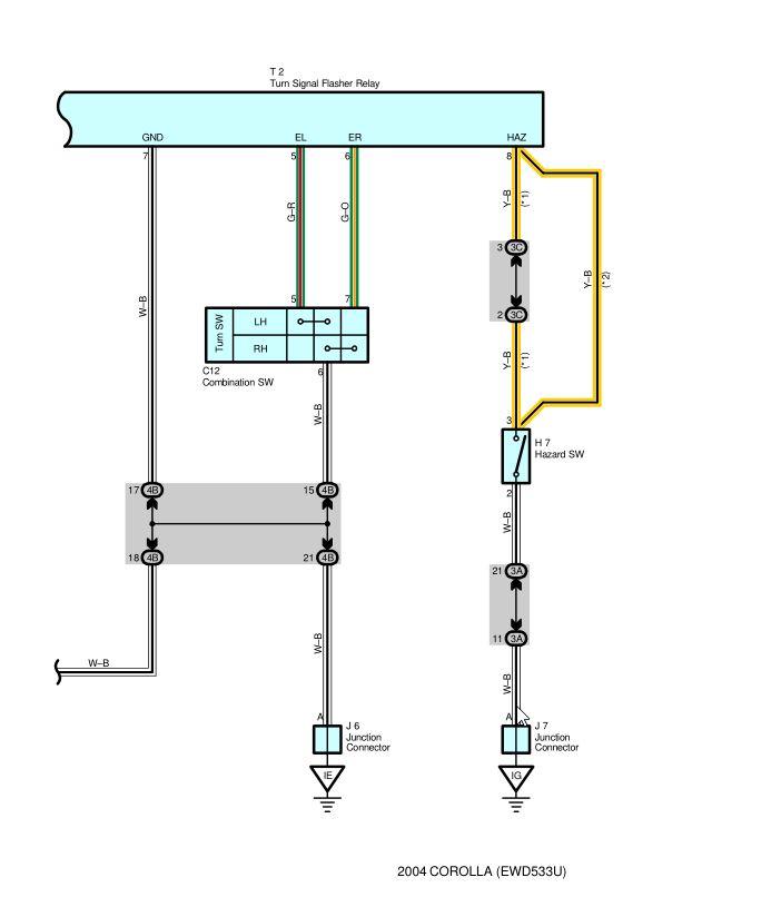

Hi,
Strangely the Haynes manual does not show the indicators in its wiring diagrams ?

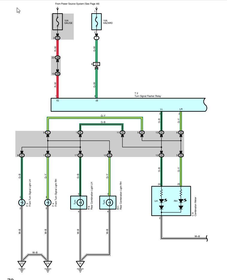

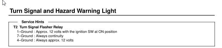

Below are some from a US 2004 corolla, so expect its similar to the UK model.
Clearly the switch works , so to me  the fact that it has 2 power sources  seems to hint its likely a broken wire /connector on those 2 lines or a fault within the flasher unit ?
It looks like the Hazard fuse is a direct line to the Battery so on all the time, the Gauge only gets power once the ignition is on.
Assume all the bulbs work ok,  on older cars a blown bulb could affect the relay.
