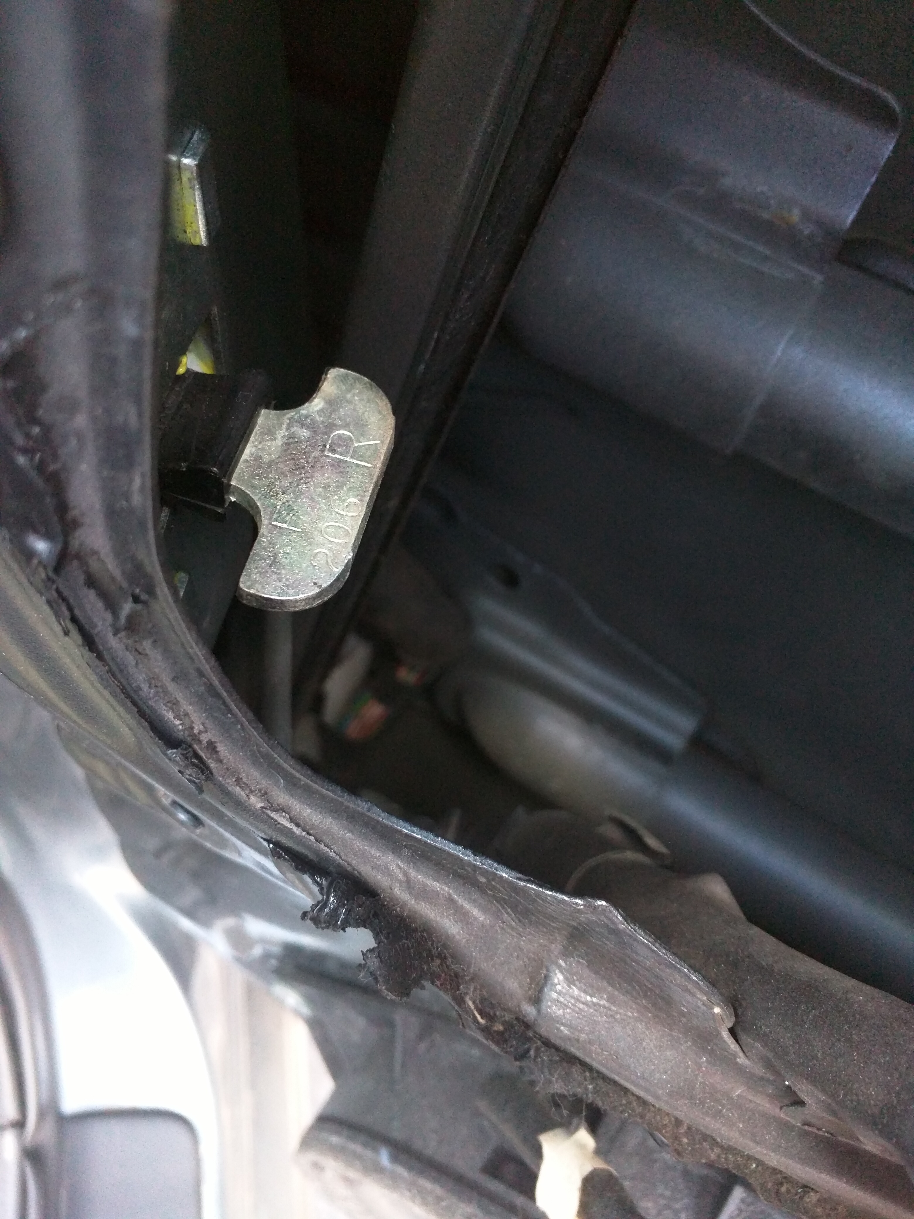

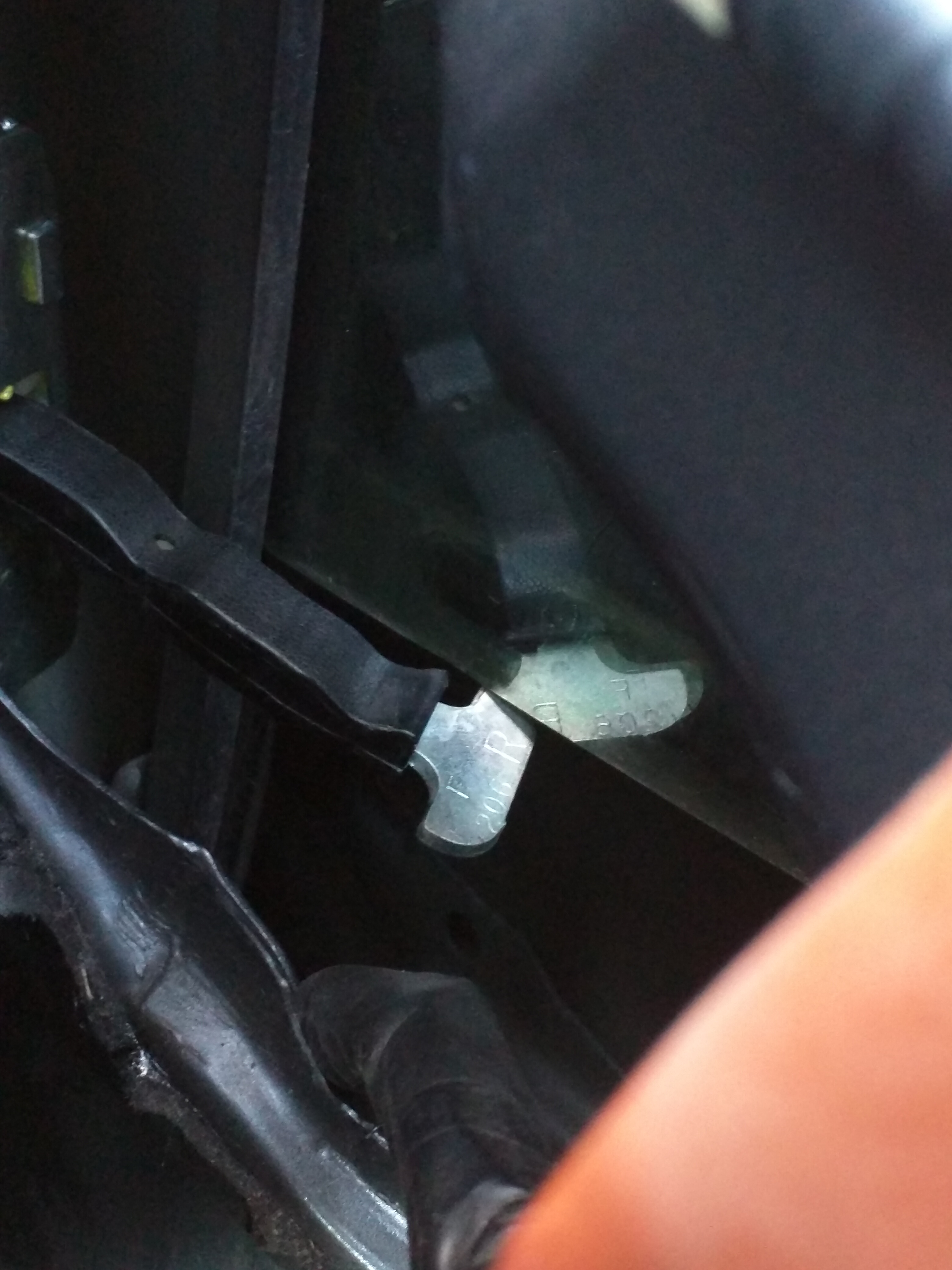

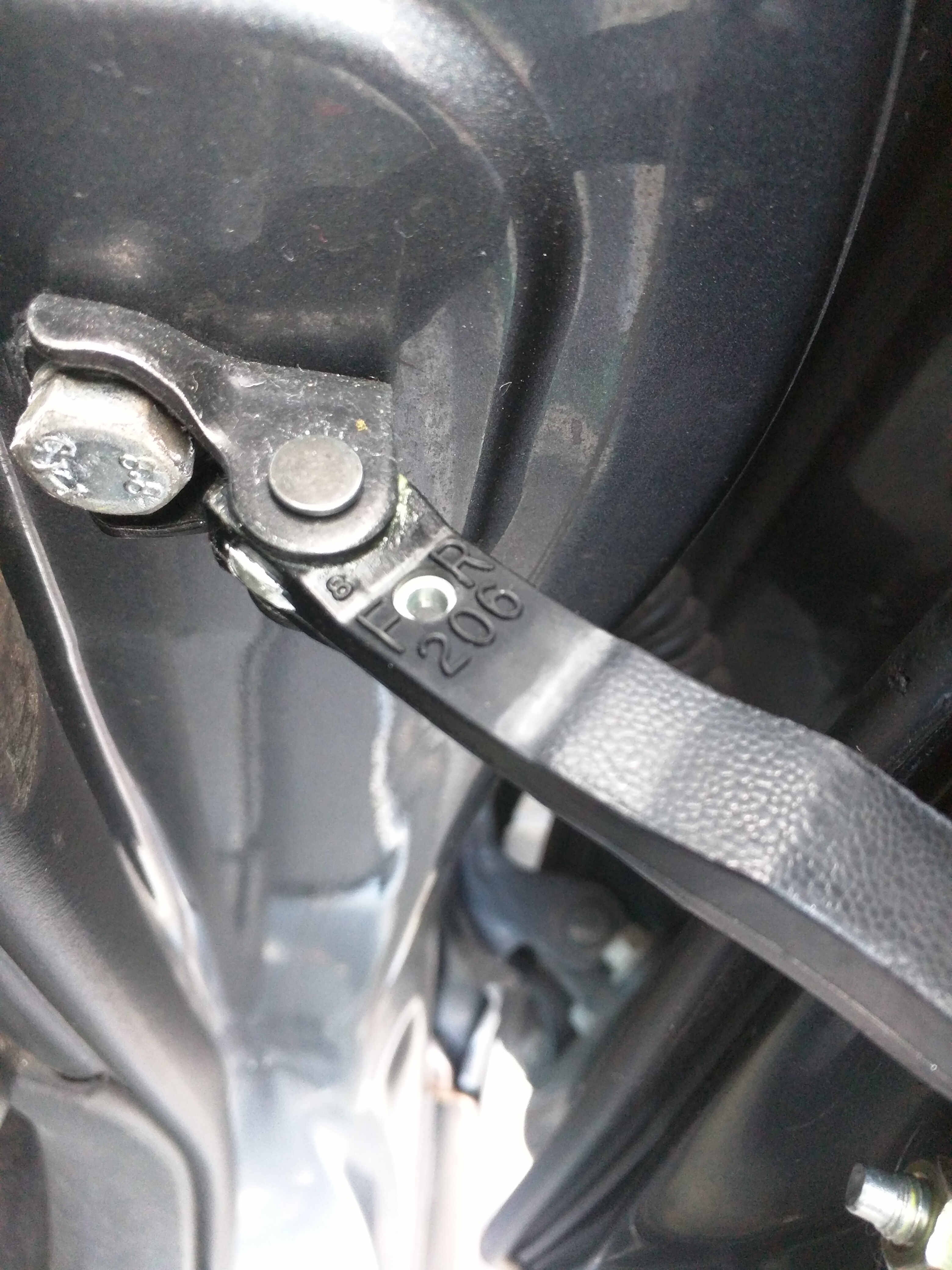

Ever since I bought my Corolla, the Drivers electric window won't go all the way down, it gets most of the way then if you hold the switch sometimes it will go 'bang' and carry on to the bottom
Having a look inside the door shows that the check strap is interfering with the window glass with the door closed
The previous owner had had both drivers and passengers check straps changed not long before I bought the car, but the passenger window goes down fine!
Are there different parts for 3 doors, 5 doors and Versos? Or can they be fitted incorrectly? Trying to work out whats causing this as I'd like to be able to put my window down/open the door without worrying its going to damage the glass!

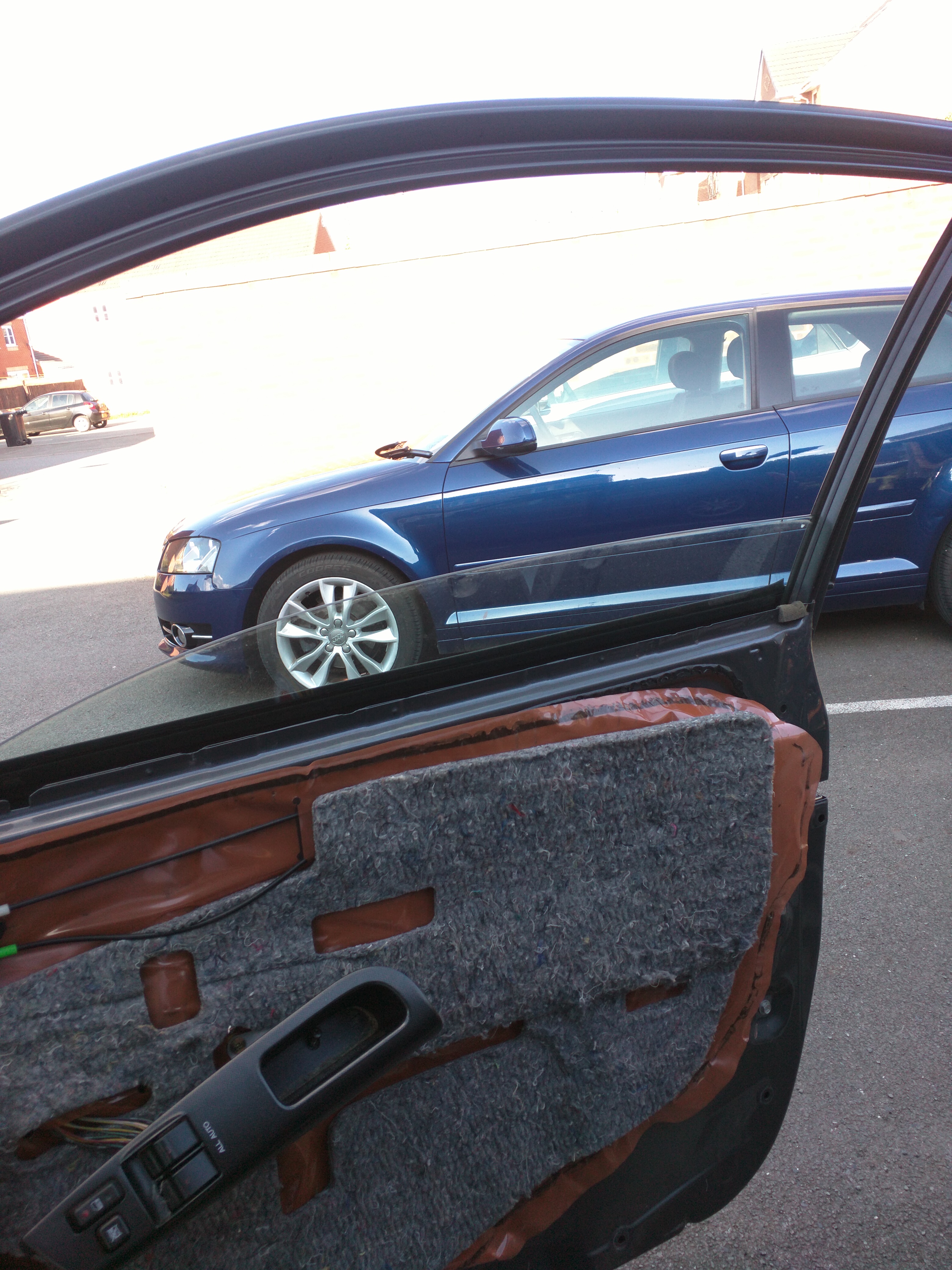

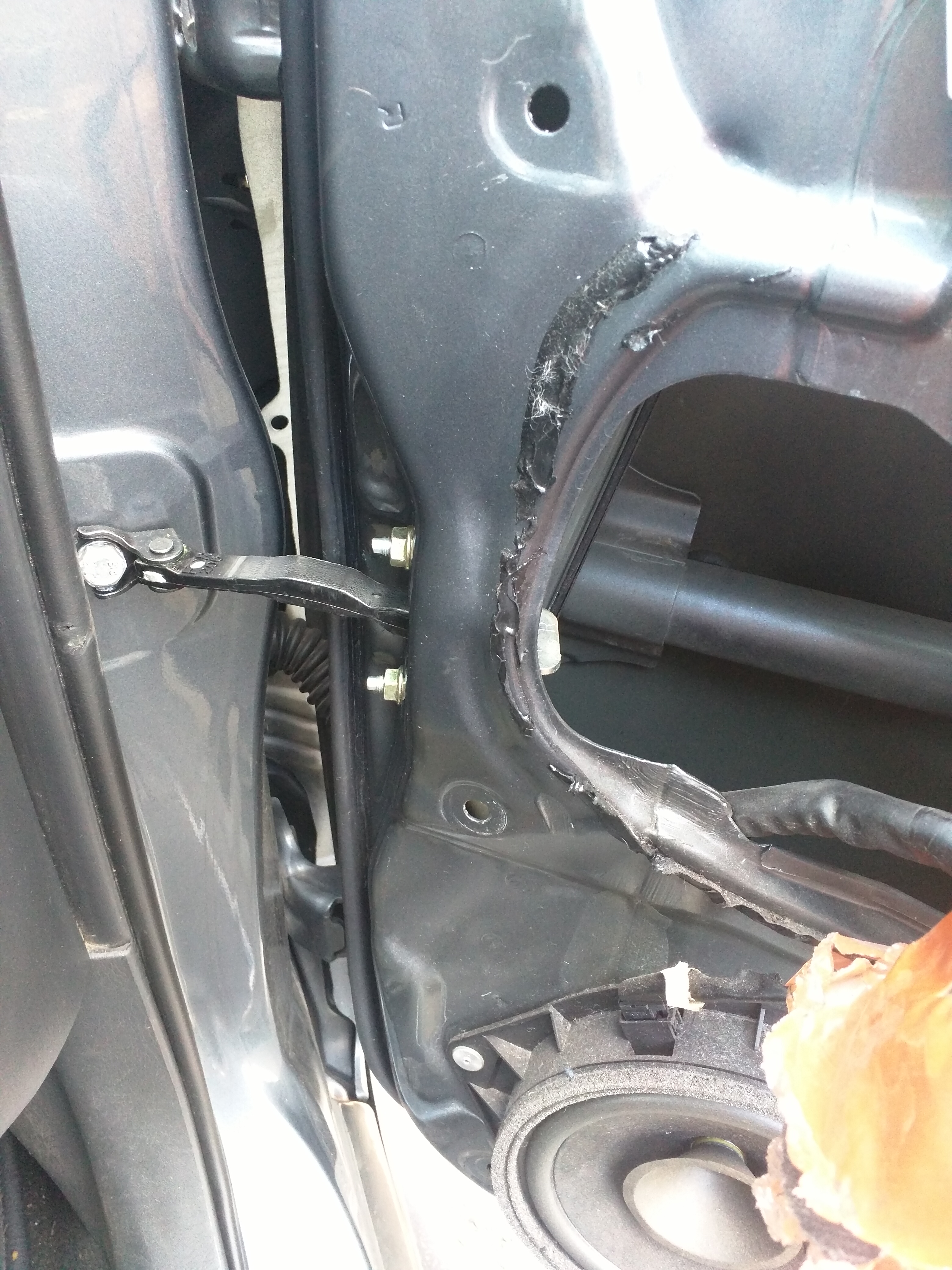

I may have a second issue also, in the last photo, the door is open so the check strap is out of the way but the window won't go all the way down. The runners look clear of any debris and it feels more like the motor just turns off like its reached the end of its travel, rather than struggling against some obstruction. Is there a reset procedure for the electric windows?
Cheers

Just had a look through the receipts with my car, looks as though the previous owner did the check straps on both doors, and both times the part number fitted was T68610-13040
I'm not sure if it should be the same part for both sides of the car, but the window working fine on my passenger side, but not the drivers side would suggest perhaps not!
