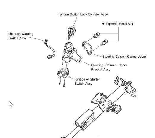

Looking at OC's diagram above, if you find you need to remove the "tapered-head bolts", then assuming they've been fitted correctly, you'll have to drill out the part of the head remaining, as the hexagon part of the bolt head is designed to shear off, to stop unscrupulous persons from dismantling the steering lock and making off with your vehicle.
