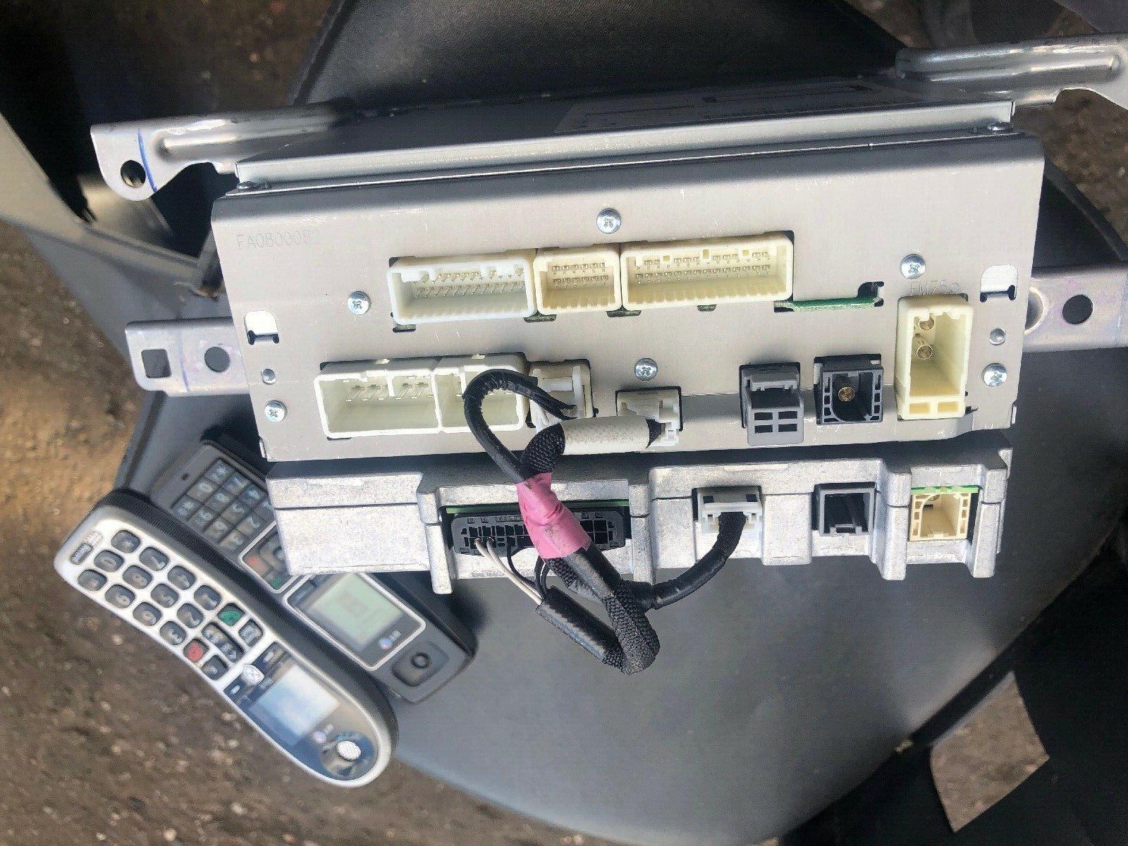

Hi there,
I am having the same issue on my Auris Hybrid 2016... first thing I get when starting the car is the reverse camera shows up on screen and when press maps while driving, the maps arrow going backwards and sometimes all over the place.
Wondering if someone indicates what colour and connection place/plug are these wires that messing around at the back of the head unit?
I have uploaded a picture of my head unit
Thanks in advance guys,
