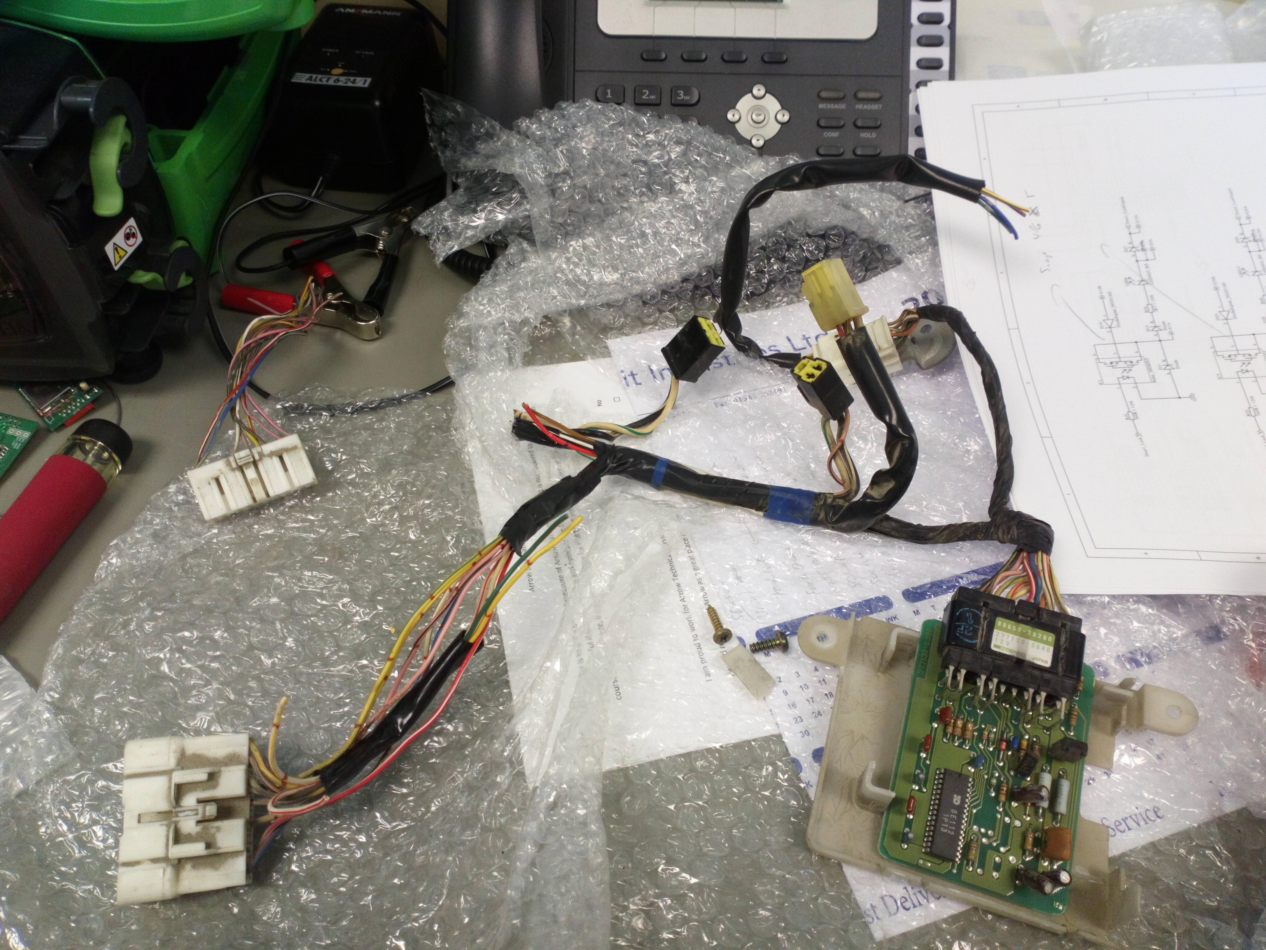

The car is a bit of a Frankenstein's monster in that it is a 1996 Celica GT ( was 3S-GE ) with a Camry 3.0 V6 ( 3VZ-FE ) and the amplifier is from a 1994 ( ish ) GT4 ( 88650-2B280 )

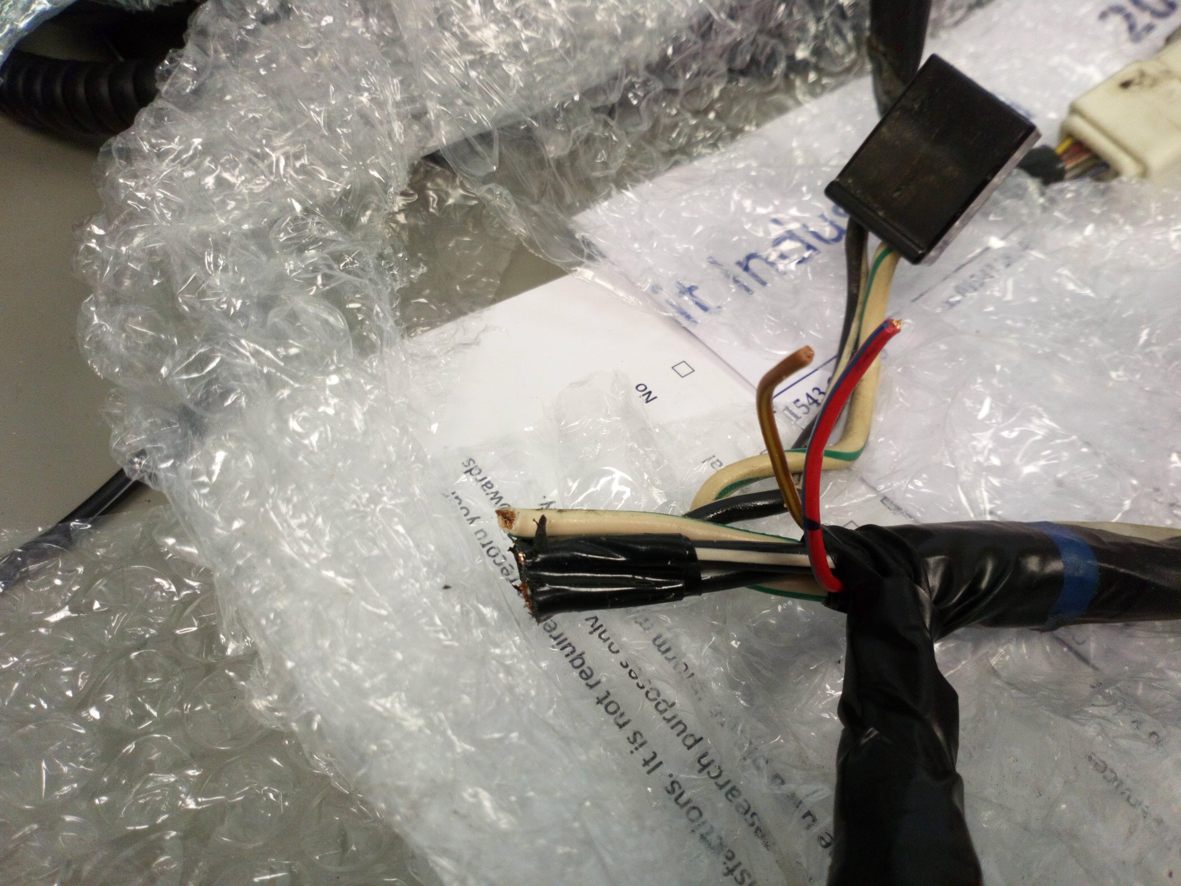

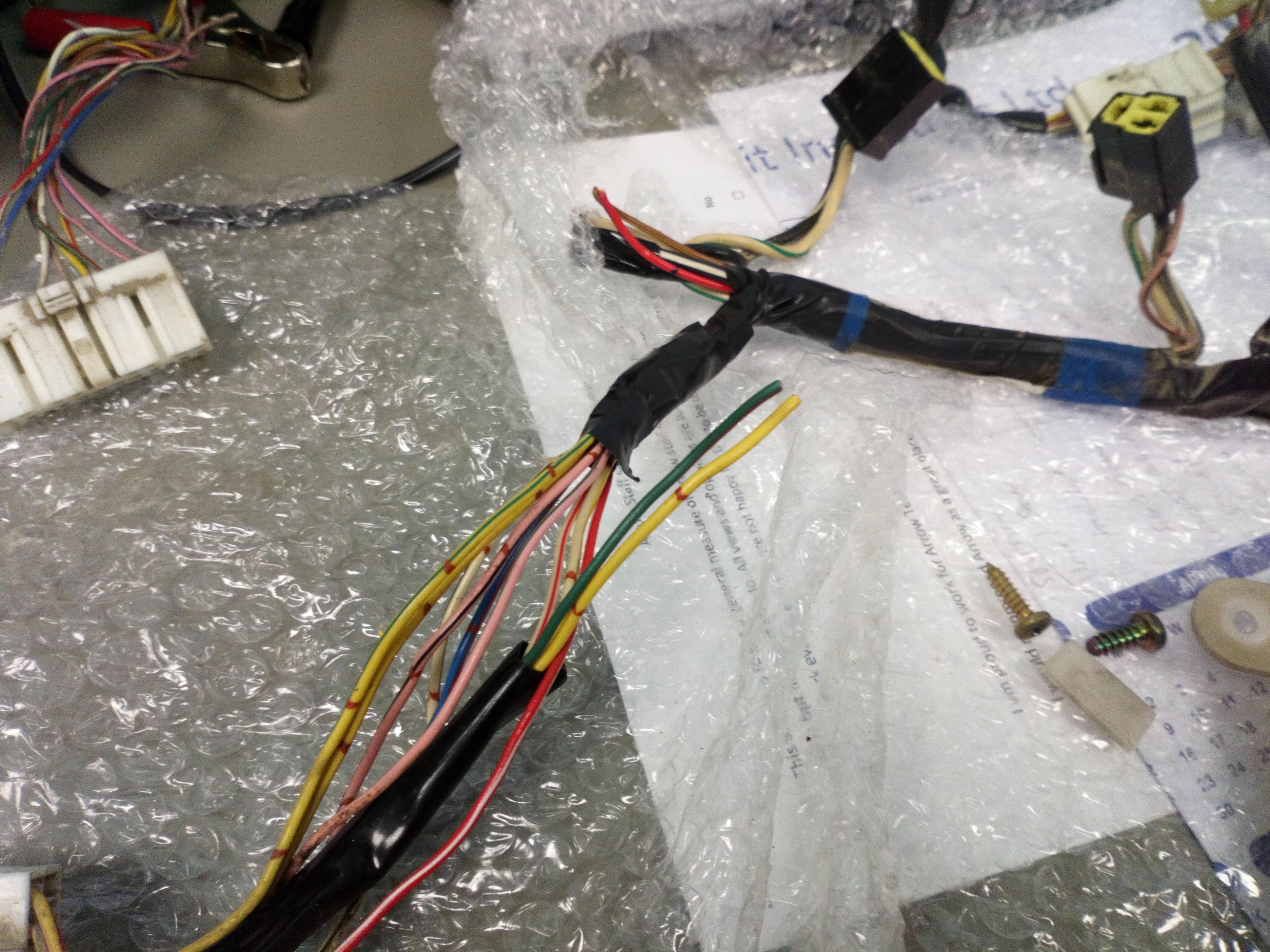

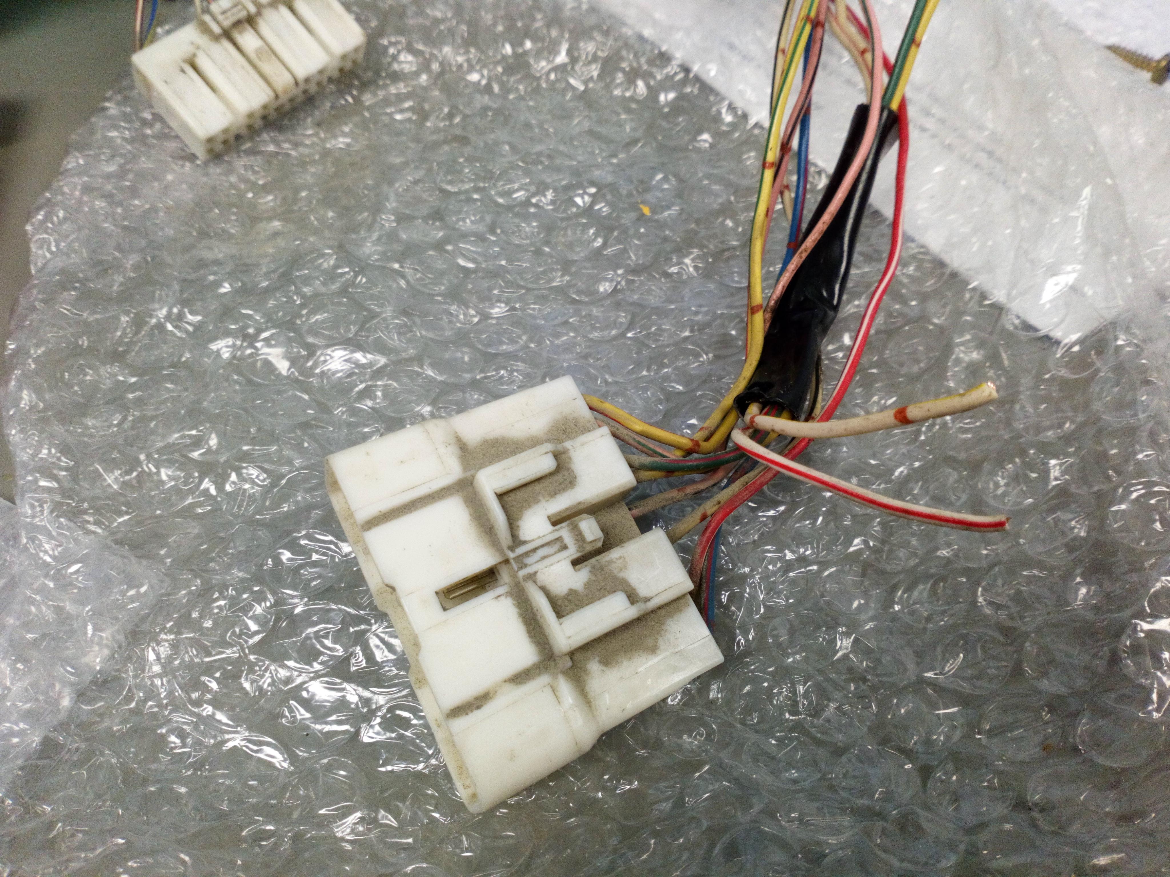

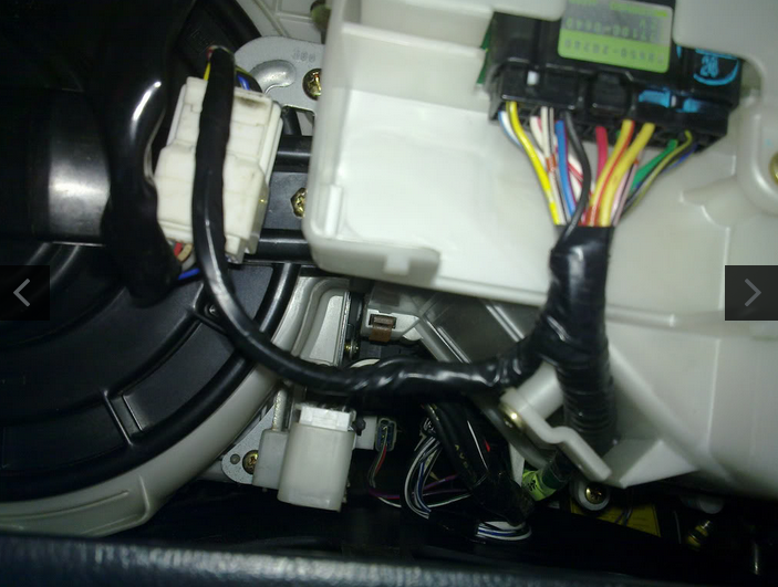

Referring to the attached images can anyone please tell me where I need to connect the following cut wires:
Loose wires near large white plug ( main chassis connector ) - White / Red, White / Yellow
Large white connector ( main chassis connector ) - Green / Red, Yellow
Amplifier main black connector ( wires cut near large white connector ) - Red / Blue, Brown / Yellow

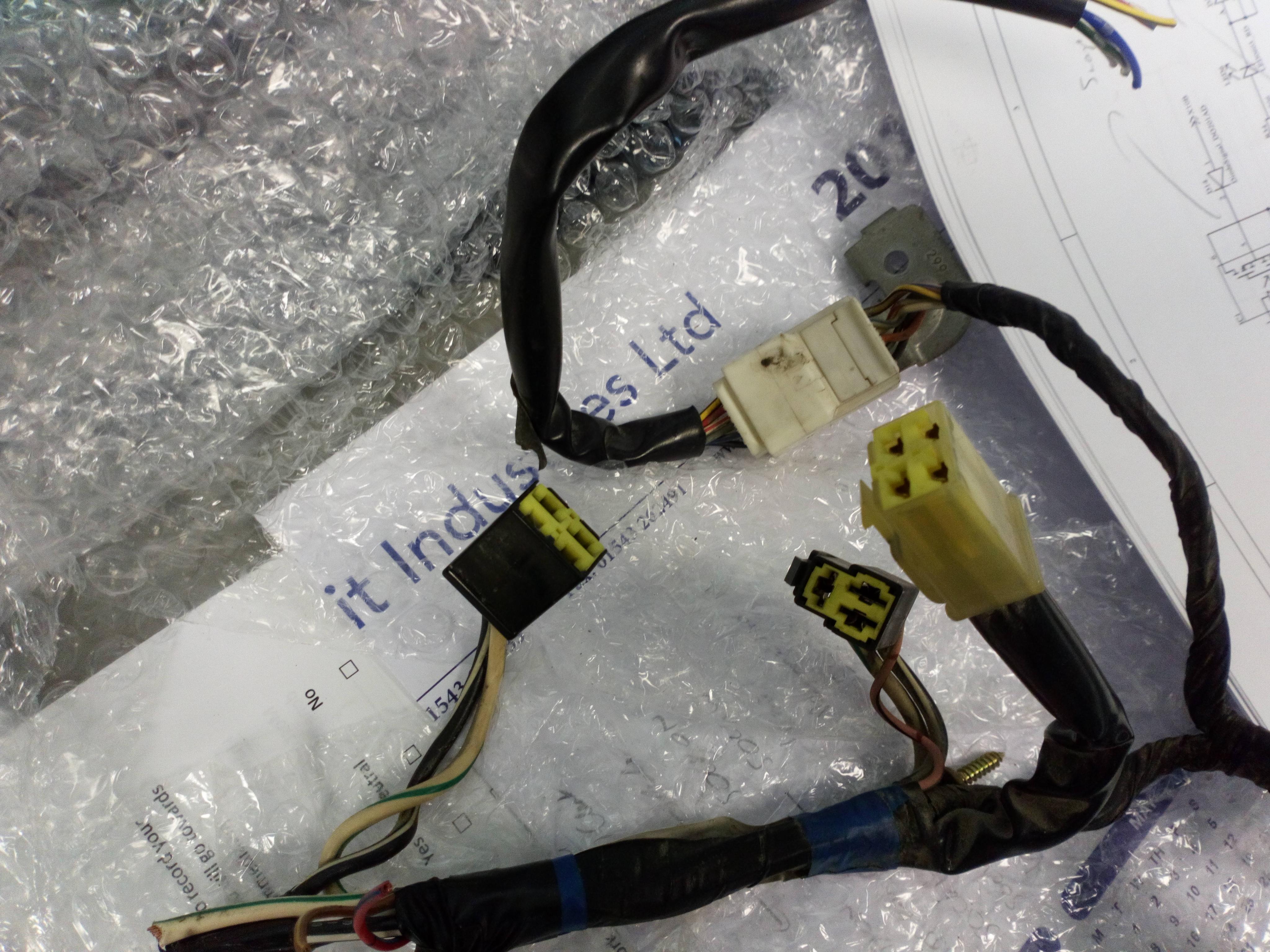

Large 4-pin connector ( 2 pins connected ) - White / Green, Black / White
Large 3-pin connector - White / Green, Black / White, Pink / Black
Large 4-pin connector - White / Green, Black / White, Red / Blue, Brown / Yellow
( x3 cut Black / White wires but only x1 cut White / Green )

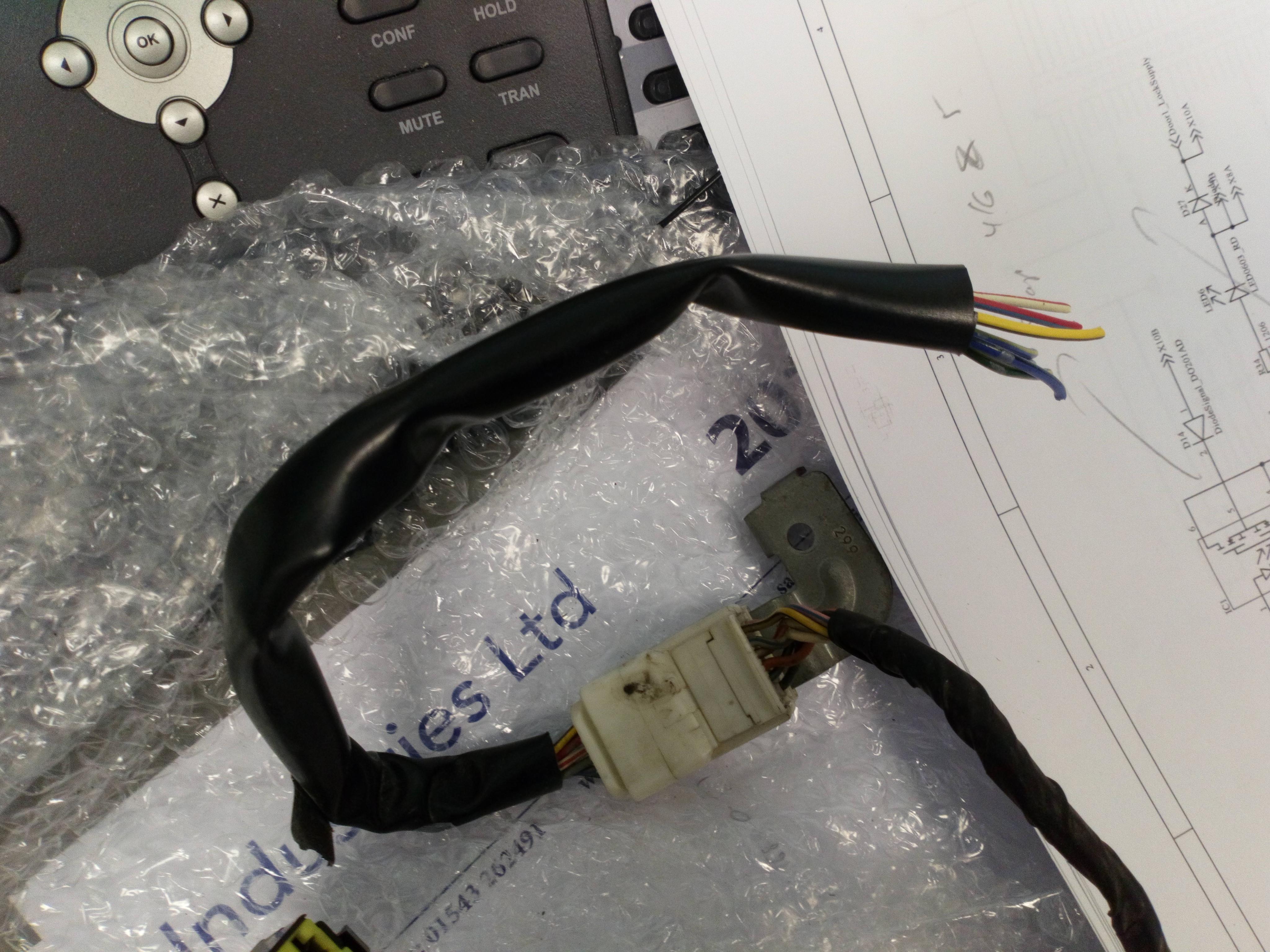

Smaller 8-pin connector ( attaches near blower motor ) - Yellow / Black, Blue / Red, White / Red, Blue / Yellow, Grey, Blue / Black, Green / Yellow
