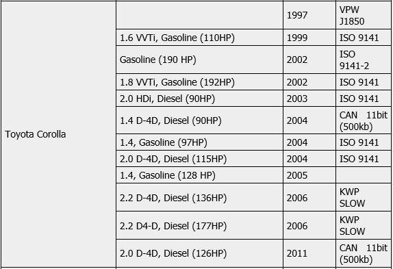

There are some cars which have different OBD2 pin configuration in the car port according to the protocol supported for the model variant. This means the obd2 scan will not initialise and the error "cannot communicate to the vehicle" comes up.
It's usually a matter of finding patch configuration on the port mapped on the computer to trick it into resetting and remapping the connector for the car. I did this once many years back on Windows XP but these days it's cheaper to buy another one.
Check to this see what OBD2 Protocol CANBUS you need for your car model and buy one that will work (the recommended option).
